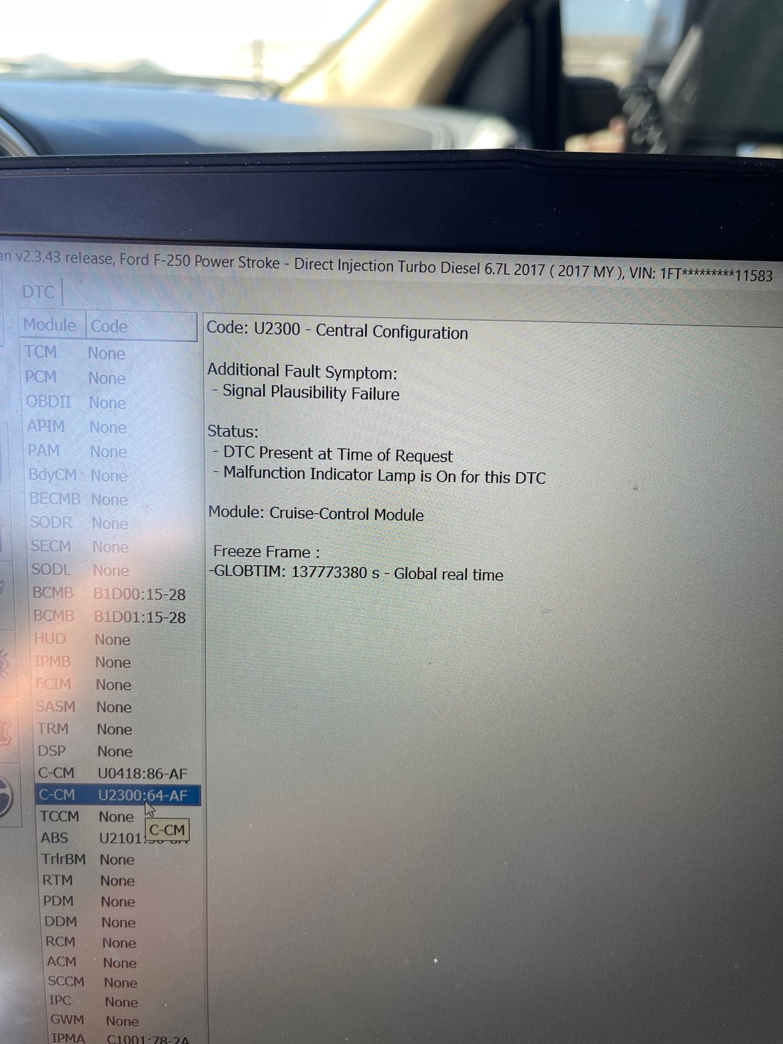

Replaced front bumper with used ranch hand that has relocation bracket for ACC. Used sensor that was on new bumper and ACC stopped working. Tried swapping sensors with mine and still not working. have tried recalibration. Checked fuses and disconnected battery. Ford is claiming they can’t communicate with my ABS
Any techs here they can try pointing me in the right direction

You need to program your new/changed sensors with your VIN.

is this something that only the dealer can do?

You can do it with the Forscan software. Here is a link to the whole process: https://www.ford-trucks.com/forums/1...ces-index.html

Reset modules to factory settings and recalibrate cruise control. Seems to be working! Only a short drive since i had to get ready for work. I am still getting a warning that says from camera malfunction and that’s it.
