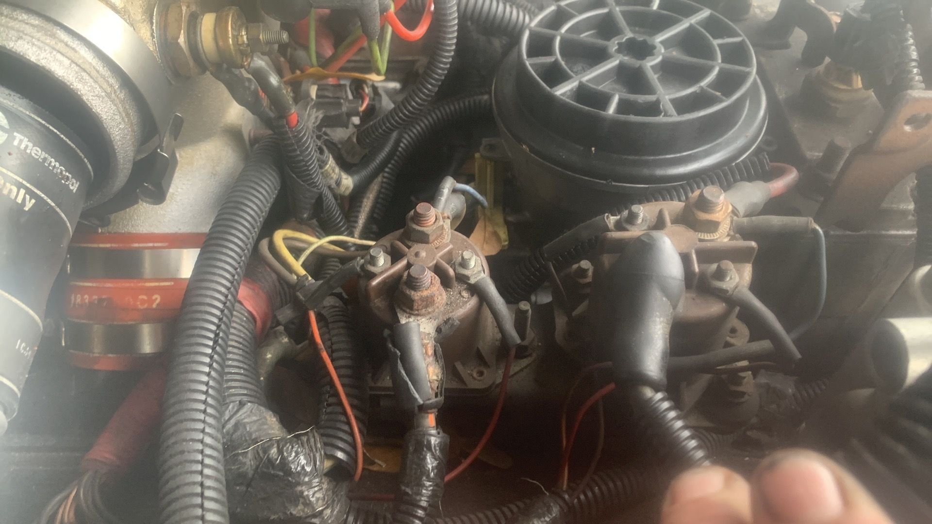

What are these 2 solenoids , the one on left / back is getting hotter than hell? Wondering if it may be my issue

The relay on the left is the glow plug relay. You are moving about 100 amps through that relay when the glow plugs are commanded to be on, it is going to get hot to touch.
