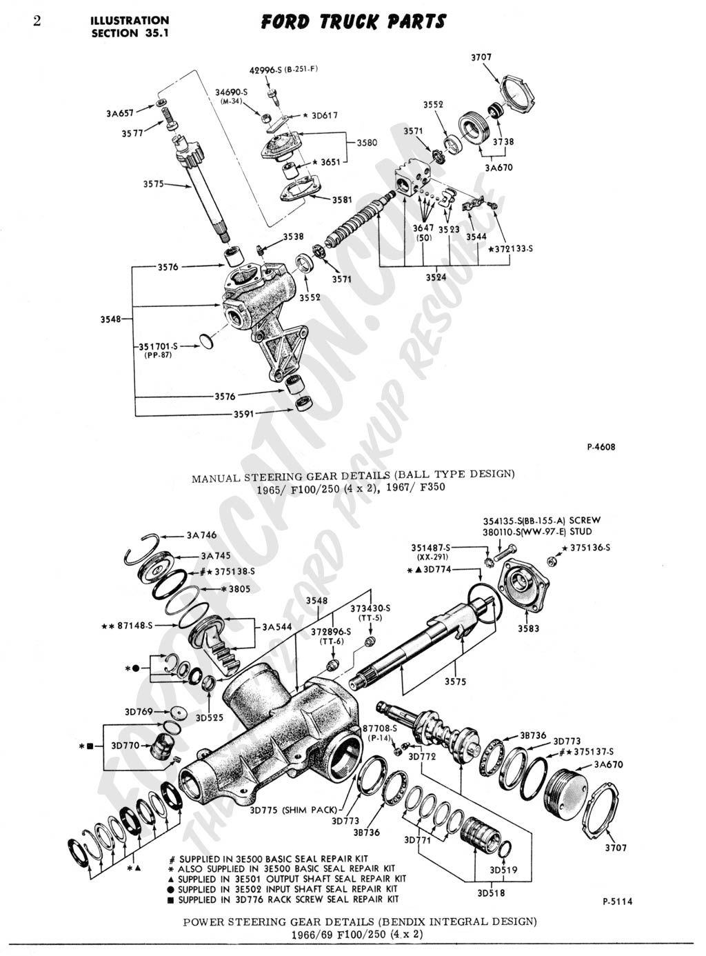

Welcome to FTE.
Are you sure it is a Ford box? If it looks like the one below it is a Bendix. Which takes a different pitman arm. If you are correct and it is a Ford, you have the correct number. But I don't see any N.O.S. genuine Ford ones out there. I suggest posting a WTB on this forum's Marketplace.

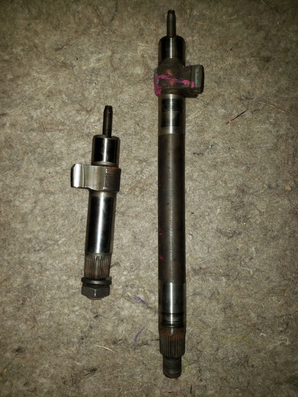

You might be able to swap the sector shaft in your power steering gear to the one you can get a pitman arm for
Here is a picture of two sector shafts Your 68 should have one of the long ones
They made 2 of each style (at least) one has three dead splines and the others have 4

Those gears used to leak fluid from the sector shaft seals quite regularly, and if allowed to leak for too long the sector shaft would need to be replaced
There were 2 available sector shafts and correspond to which pitman arm the truck had

If the steering box is the one Henry's boys installed, it should be a Saginaw. Like below in the bottom of the pic..
