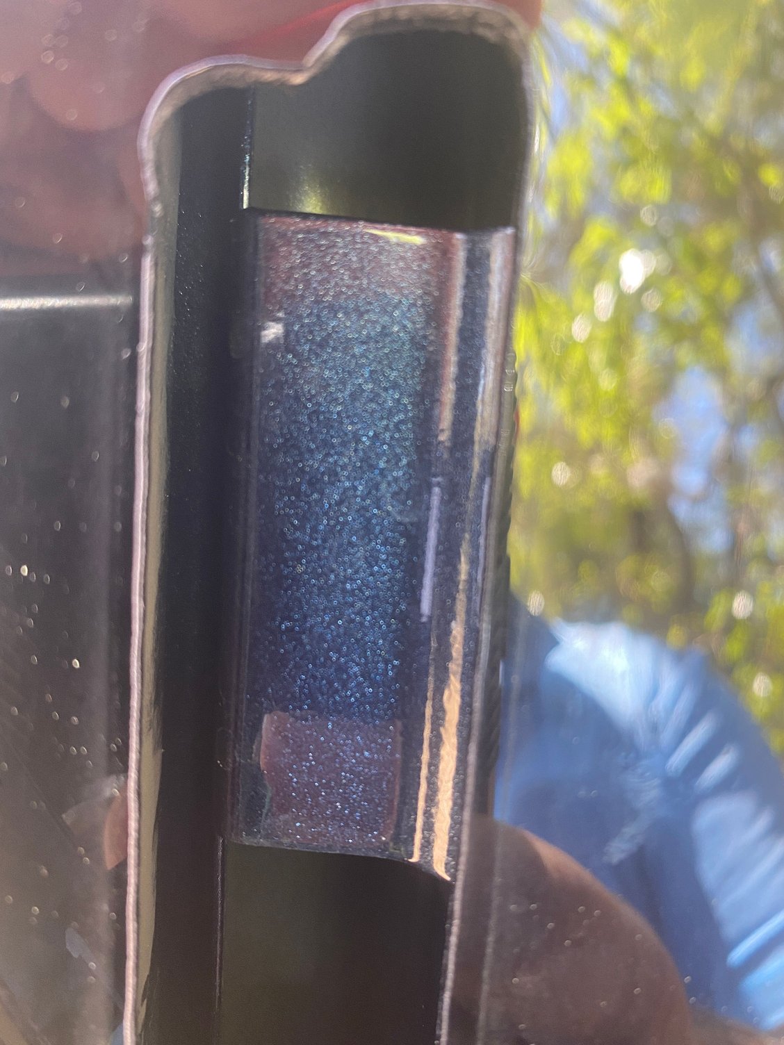

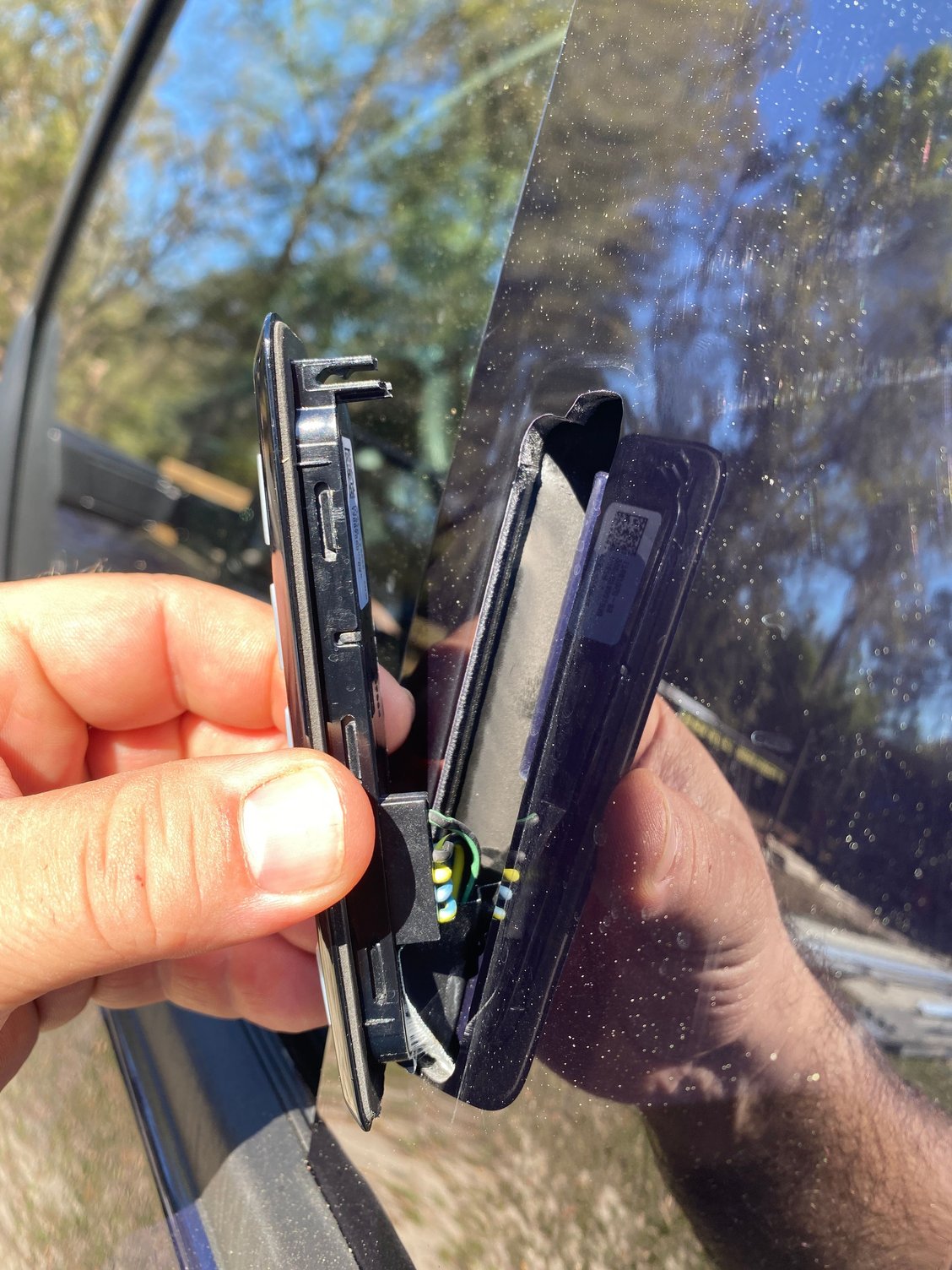

Anyone know how this attaches to the side of the door? Unfortunately I just came out to my truck and saw that the keypad was almost hanging by the wires. I see what resembles a clip on the back of the keypad but I don’t see where it attaches to anything inside of the door frame.

That top clip that you see on the back is broken off. It's the retainer clip on the trim piece, which holds the assembly in place.
Here's a good video showing how to install the new trim piece.

I used a small dab of super glue on mine and it hasn't moved in 3 years.

did you apply the glue to the little foam seal around the keypad and then pressed it into place on the door?

Yes, but I only needed to apply it at the very top as the bottom still fit securely.
