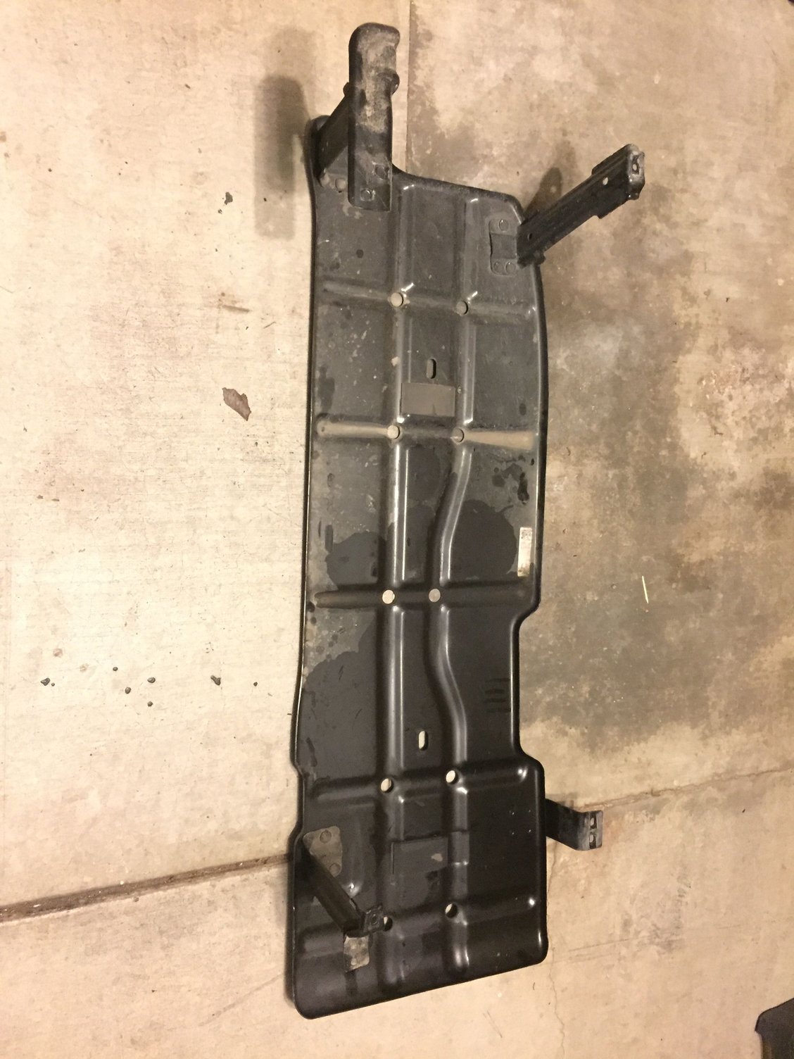

Here are some pictures. I thought the brackets were permanently attached because of the flat head bolts. Three of them are bolted on. The shortest one is riveted on.

That’s off a 34 gallon tank on a crew cab shortbed.

Anything stand out as totally "Ford-absurd" to anyone in that fuel tank plate photo?
Note that three of the four "legs" (lack of a better term) are bolted on. But one is spot-welded on ... Why? Three of the four of them could be easily removed for shipping, but the forth prohibits a compact shipping package. WTH Ford???????? Why spot weld on one leg, but bolt on the other three? If all four would be easily removed/installed, they could be broken down for easy flat shipping box.
- either make them all spot welded; fewer parts (no bolts/nuts)
- or make them all bolt-on (ease of shipping)
Don't mix the two methods; that's just dumb. No other way to put it. I love Ford as a general rule, but at times they are just rife with stupidity.
If anyone has a skid plate for 34 gallon tank (SuperCab Long bed is what I have) they'd be willing to give away or sell for a small price, I'd be willing to pay shipping. PM me please.

That is to allow installation. There is no room near the frame rails.
