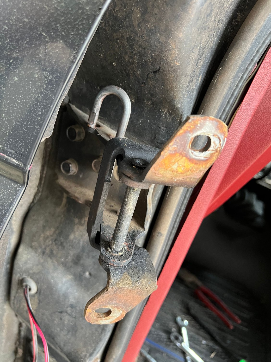

Any one have a factory schematic of the drivers door.Years back the catch that hold the door from slamming shut(wind) broke and I would like to replace it .The roller is still in place.I cannot find the s type clip that this 85 uses any where .Though not necessary it is helpful.TR

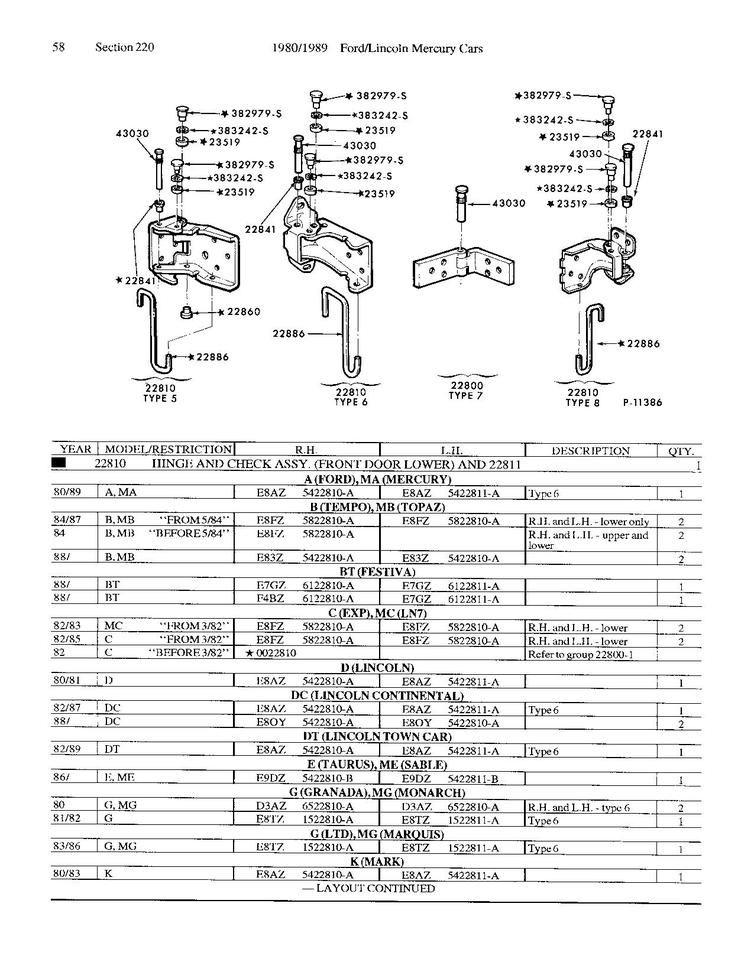

Found this posted by Bill( Number Dummy) as the s clips are included in these pictures .Seems they used a different type detention on my 85

Got my s spring for the drivers door as the installed went good .Removed the door 4 bolts (door),installed s spring ,reinstalled door Chose the S spring as my door roller was still there. Yes rock auto has the new type hinges with detent ,but chose the s spring as I thought new hinge would be harder with alignment . (new-parts are always a pita)Thanks for pointing out the parts on eBay and rock auto .I still do not understand why this S spring is listed for older vehicles( Fairmont etc…)and not for our bullnose fords, but it’s good knowing new hinges with the detent may be purchased if necessary! TR
