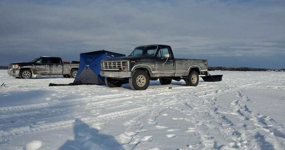

Seeing dipsticks truck frok other posts it seems to be at stock height.

Sorry was at work. My truck is stock height no lift. When the plastic spacer breaks it allows fore and aft movement of the arm and clunking in the suspension. I just find it odd that only the passenger side is doing it. I ordered a different brand of bushing kit as u can't get that spacer separately that also has rubber bushings not poly.

Old Feb 28, 2022 | 04:48 PM
