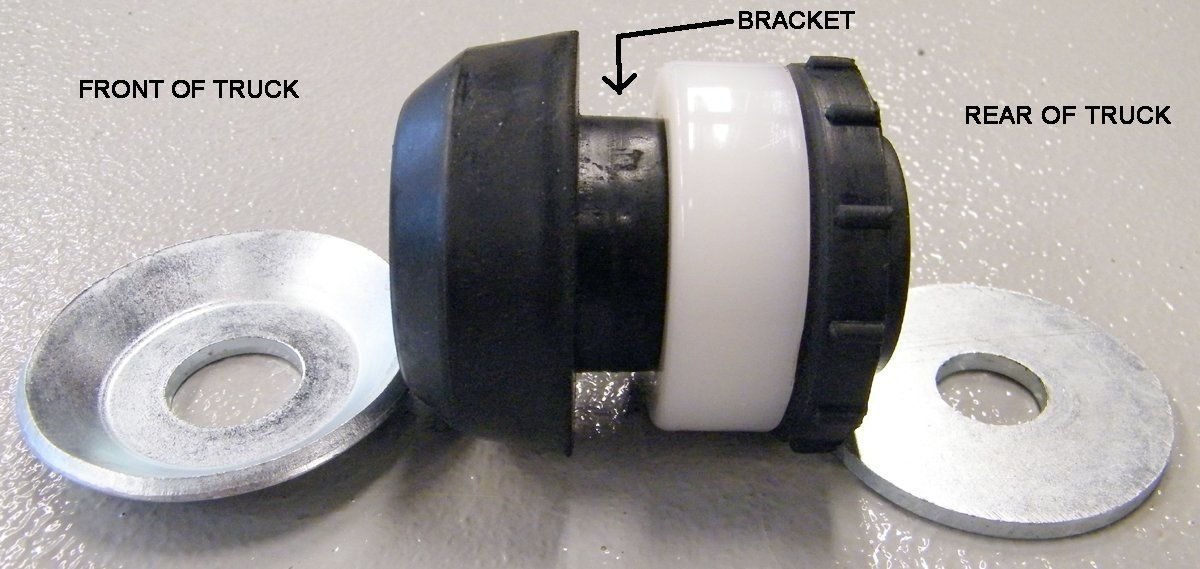

The black plastic spacer in the one pic and the white one in the other is what keeps breaking.

On the bottom picture I believe the cupped washer is placed wrong on the assembly. If so maybe that's why?
Dave ----

That's not mine I just got those off Google.

But how are the cupped washers installed?
Dave ----
Old Feb 28, 2022 | 06:25 AM
Dipstik86's Avatar
Dipstik86
Joined: Nov 2021
Posts: 116
Cupped washer towards the spring. Opposite side of the nut.

I ordered the energy suspension bushings for my 89 bronco but the spacer would not fit with the aftermarket lift brackets, they had a small lip on the nut side that seemed to act as a spacer, so I didnt use it. I believe my instructions told me to put the cupped washer on the nut side and flat towards the front of the truck.

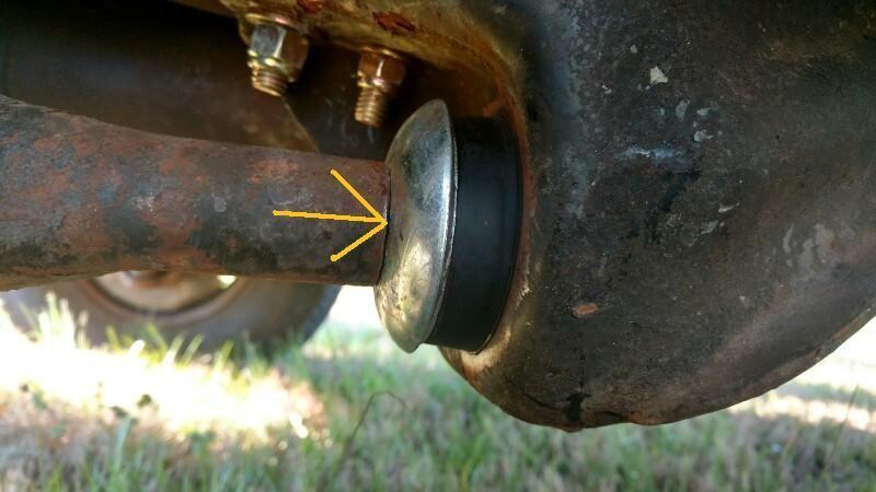

Correct bushing orientation:
Some radius arms have a factory spacer collar at the front of the bushing, Mine did. If so, it needs to be removed or the bushings will overtighten. You will need to wire brush, sand, and really clean to see the collar. Then it can be knocked or cut off. The metal is fairly soft, so cutting with a chisel is pretty easy.
Here is where the collar would be. This is after removal. It's only about 3/8" wide.
I was incorrect once I looked, sorry about that. The spacer/collar I was talking about is the black in the middle of the bushing. it is part of my drop bracket

You may have to use rubber radius arm bushings. Your drop bracket is lots thicker than stock, and you can see how much the poly bushing is squeezed out of shape from tightening. There could be so much pressure the spacer can't take the strain, where rubber bushings will flex more and put less strain on the spacer.
