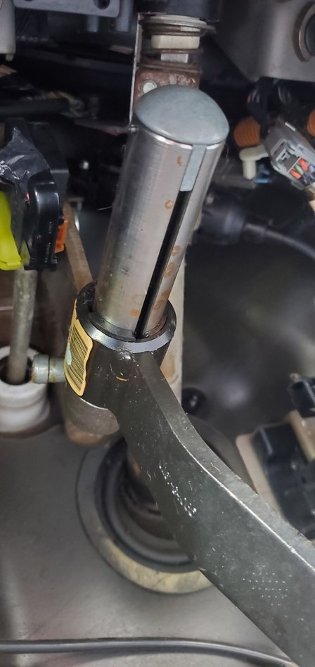

I'm not sure there is an easy fix for this other than replacing the entire brake pedal, but here goes. Using the pedal adjustment switch, only my gas pedal has full movement. My brake pedal is at the rearmost position and only moves about 1/4 inch and stops while the gas pedal keeps moving. I see the motor above and the two cables, one out of each end that goes to the pedals. I have unplugged the cable at the brake pedal worm gear and the cable does continue to spin. Any thoughts before I dig into it?

Not necessarily suggesting you do this as it could hurt, but I would grab the end of the actuator cable with a pair of pliers and see if it turns with pressure against it. If it does the worm gear in the pedal is bad. If not, new cable and life is good.
