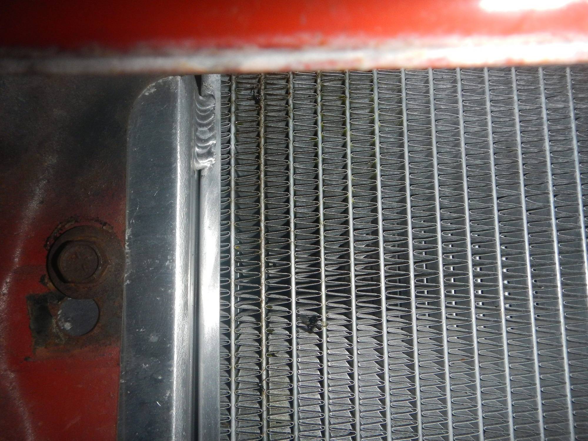

I just got my 3rd Champion radiator under warranty for my 66 F250 in 3yrs. They told me that Electrolysis is causing the problem. I have been using 50 50 fluid and they tell me to use Evans coolant to eliminate the problem. $50 gal, wow seems like a lot. Anyone with experience using it?

Solid aluminum. Upper tank where the core attaches is where it starts to leak.
