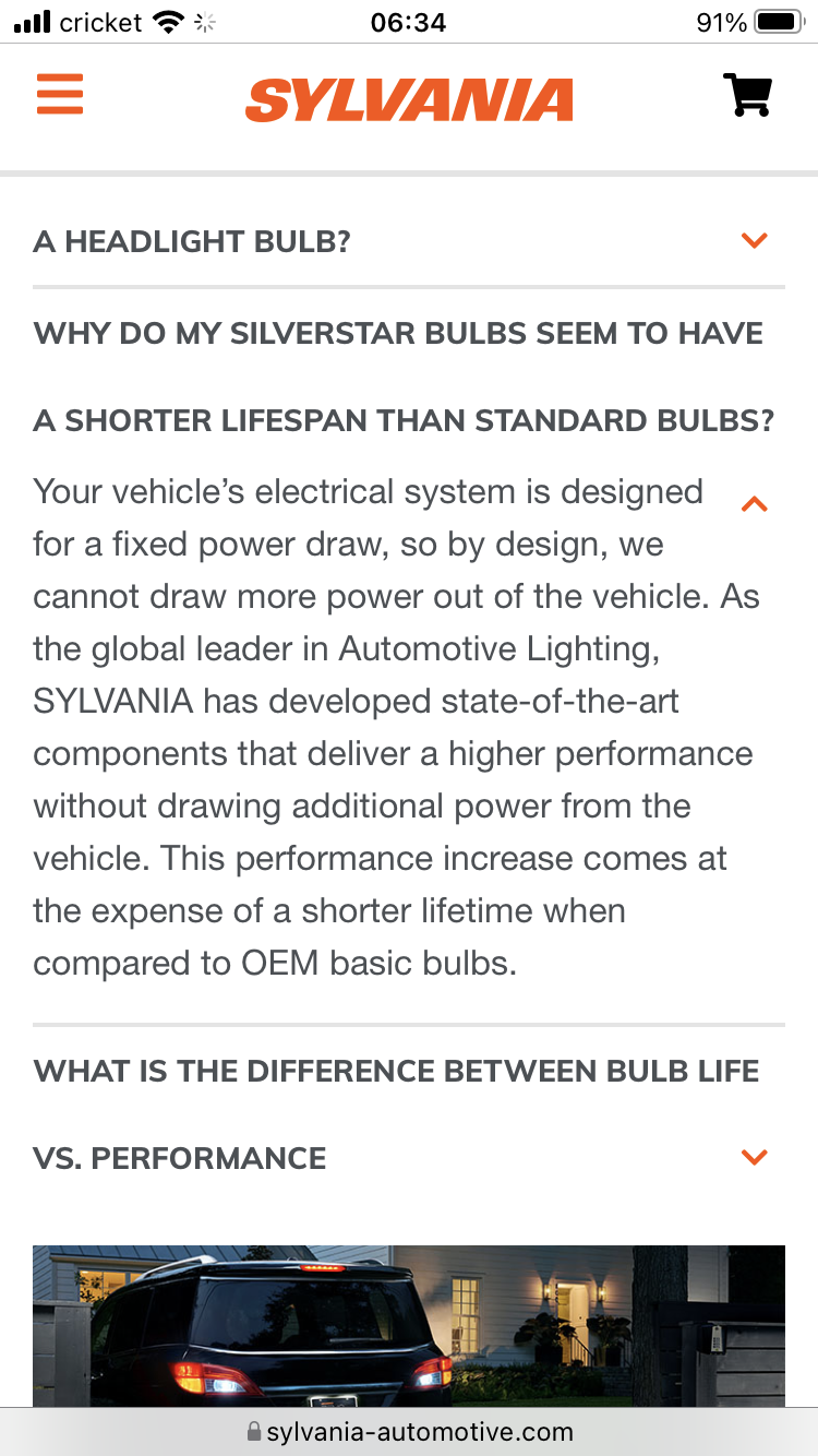

I agree it's ridiculous having to disassemble so much to replace a headlight bulb. However it's no secret that Sylvania Ultra bulbs have a shorter life than regular halogen bulbs. It even states this on their website and on the packaging.
