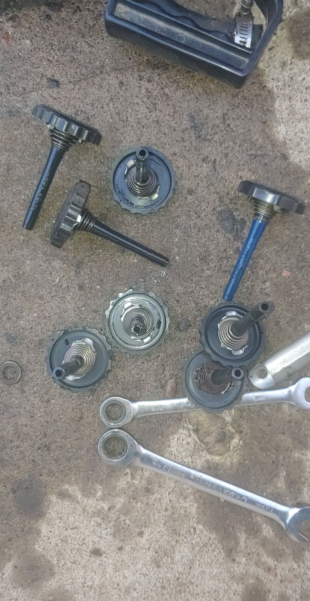

You put ATF in it? I hope you put Type F and NOT Mercon/Dexron/normal ATF.
dont worry too much about the left most piece, because ford likely used a different kind but may not. anyway, was your valve in this order, with the o ring on the fitting, and the control valve having a hex screw on the tip of it. the spring then last? Also, whats the pulley diameter? you usually can spit fluid with a saginaw P pump by spinning by hand. you likely have a fine pump but I would at least change a reservoir o ring while its off. Its not a lot to put it on, just put it on.
If it doesnt work when you put it on, go find any P pump from a Gm since about 1975(press on pulley) to 2000s ish. 1990s gm truck had p pumps for sure.
I own like 8 if I put them all together
also these things have a simple dipstick but you should eithr clean it out or buy a new one. they have a vent. if you capped the reservoir with a dirty cap, it may not be moving fluid because of that also, you put what fluid in? if its Type F, thats fine. But a synthetic ATF is both bad and also thin, it would be more pissing in the wind trying to get it to move water vs a viscous fluid
