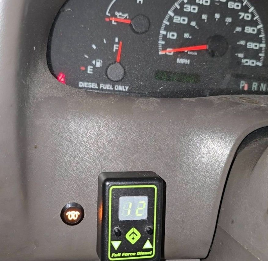

Old Nov 10, 2025 | 08:15 AM
BWST's Avatar
BWST
Got Data?
Joined: Dec 2012
Posts: 4,270
Likes: 1,405
From: Lake Stevens, WA
Saw this on the 7.3 Powerstroke Technical Page on FB. Nice option for the GPR LED mod. I think if I didn't already have an indicator on my glow plug disable switch, I'd try one of these.
Amazon.com: Taiss LED Indicator Pilot Dash Light (Glow Plug Warning) Yellow, 1/2 Amazon.com: Taiss LED Indicator Pilot Dash Light (Glow Plug Warning) Yellow, 1/2"(12mm)12V LED Metal Signal Indicator Light. : Industrial & Scientific
