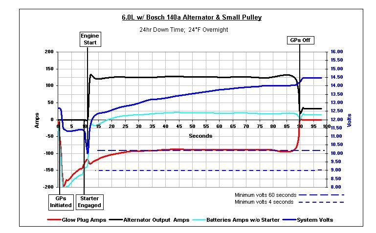

110a by the book.
140a by the book.
110a stock pulley under test.
140a stock pulley under test.
140a small pulley under test.

Thanks for the replies and the charts.
I think the charts pretty much say it all.
140a / 58mm it is.
