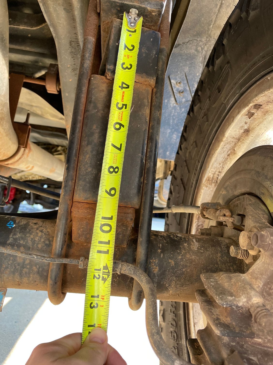

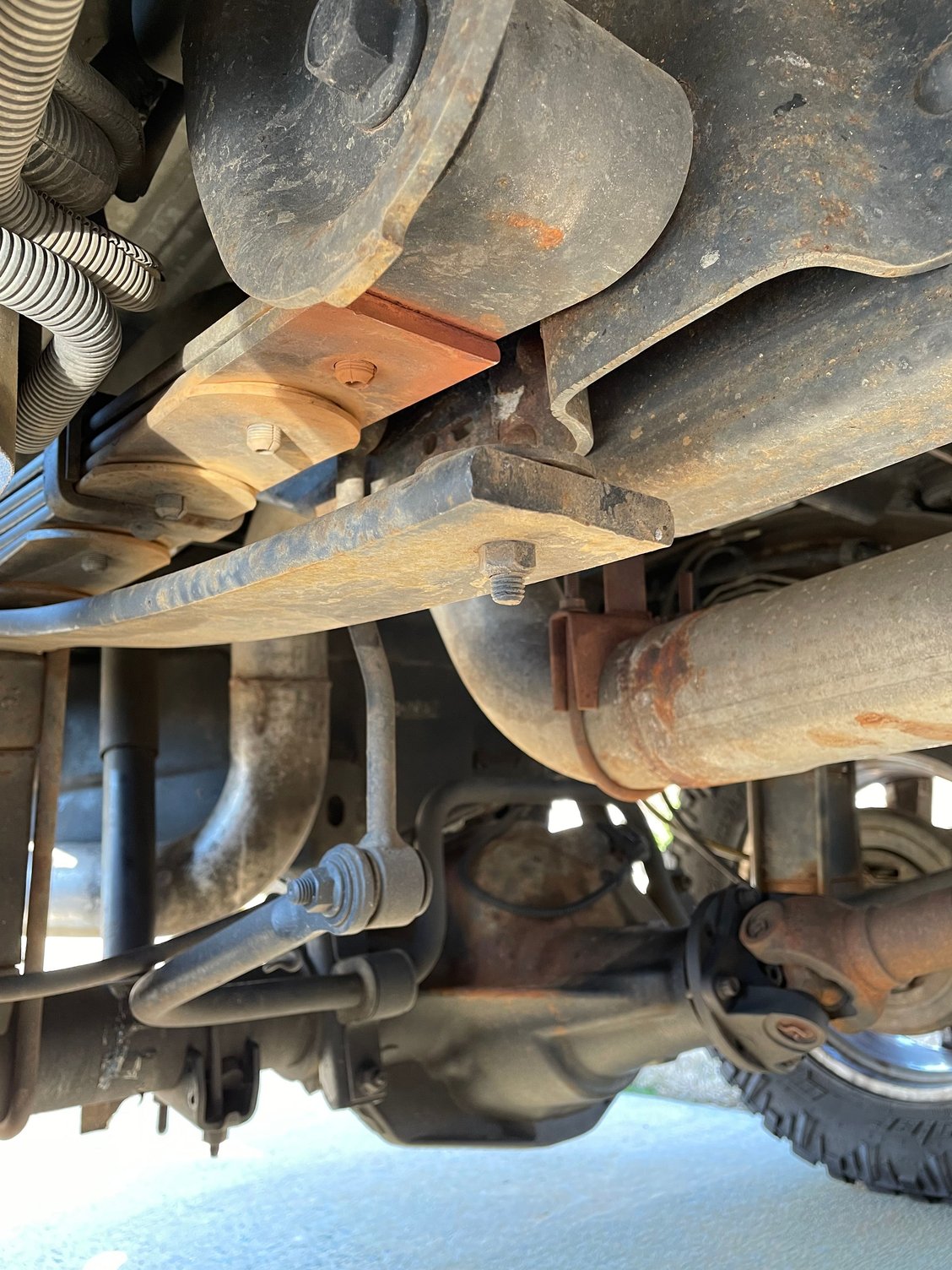

Let’s see if I can attach these pictures. They may not be the best quality but it paints a good picture of what I’m working with. My goal is to figure out what I need to completely change the suspension and let this Excursions next trip be to a shop to completely change out the suspension and install new tires and do an alignment.
There is a lot of work ahead on the truck that I surely didn’t plan for and really hate I have to do but I feel it’s got to be done for safety sake. It was feeling really sketchy the last time I drove it. I better understand why after being able to turn ALL 8 nuts holding the rear springs on with just a regular 1/2in ratchet in the minimal space between the frame rail and inner fender.
Let me know what you all think about my mess I’ve bought into. As crazy as it is I am still optimistic and excited to get this baby one the road and safe finally.
My poor neglected Ex that is due some serious upgrades to make this a safe and enjoyable ride for many years to come.
Passenger Front wheel
Passenger rear wheel…looking at this picture it doesn’t look centered in the wheel well. I going to have to look at that closer, I haven’t noticed that before.
Stack of blocks for the rear lift, this is also on the passenger side for what that’s worth.
Passenger Rear suspension from the front side. Is that bottom leaf supposed to be hanging that low?

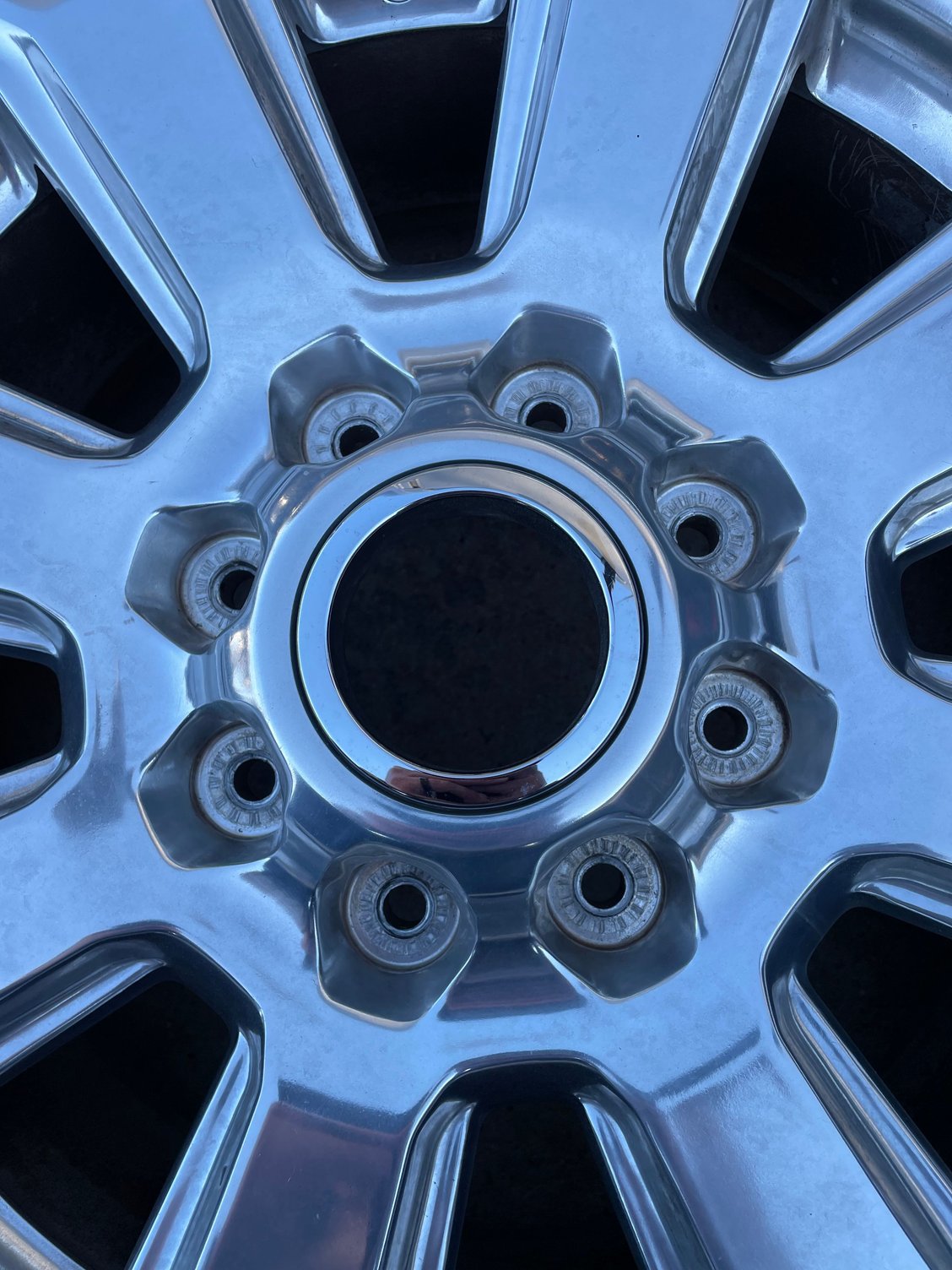

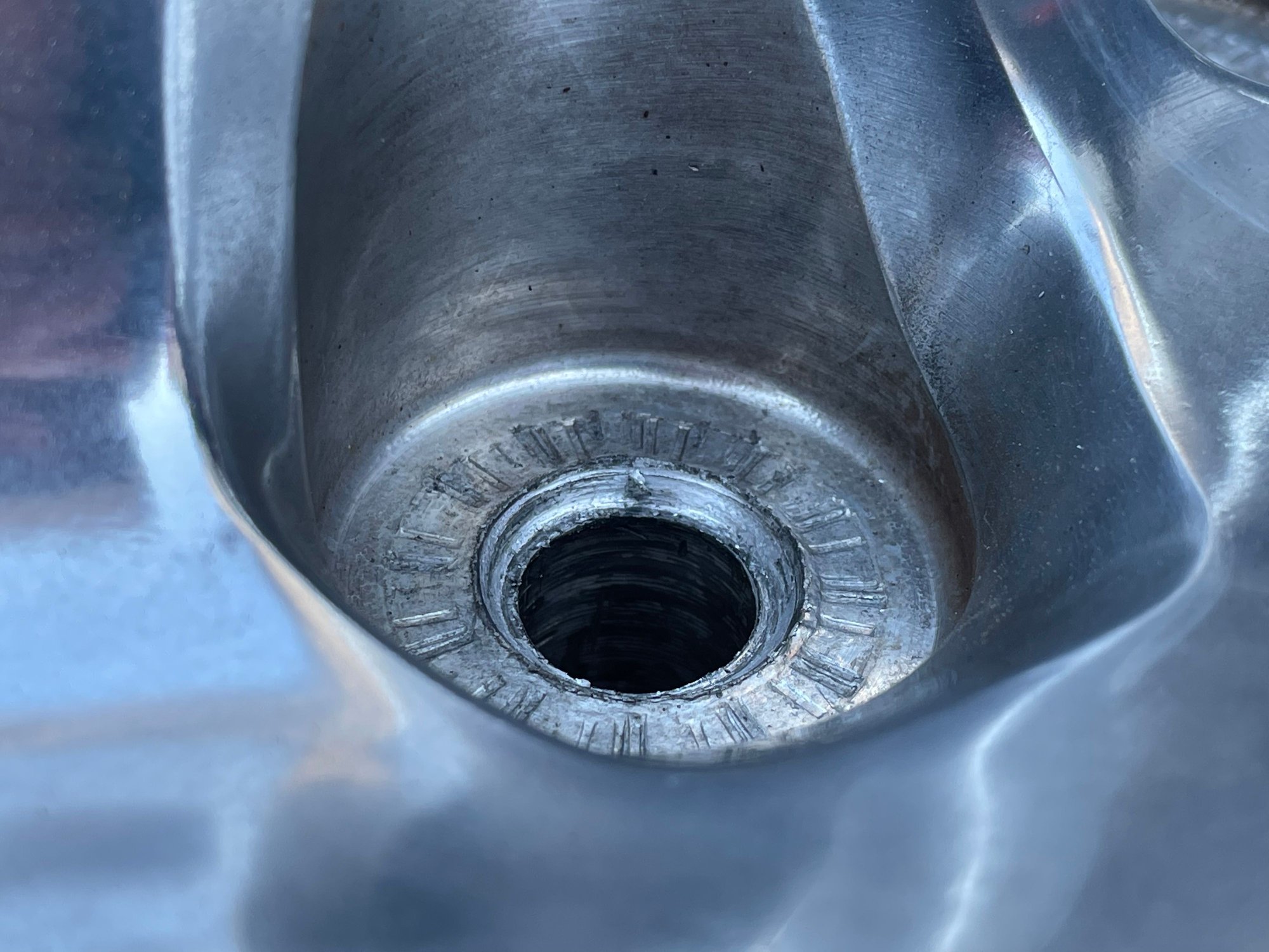

Notice the indentations caused by the incorrect lug nuts.
Driver front suspension with Superlift sticker with p/n 01-216-6
Close up of burr/indentation caused by incorrect lug nuts.

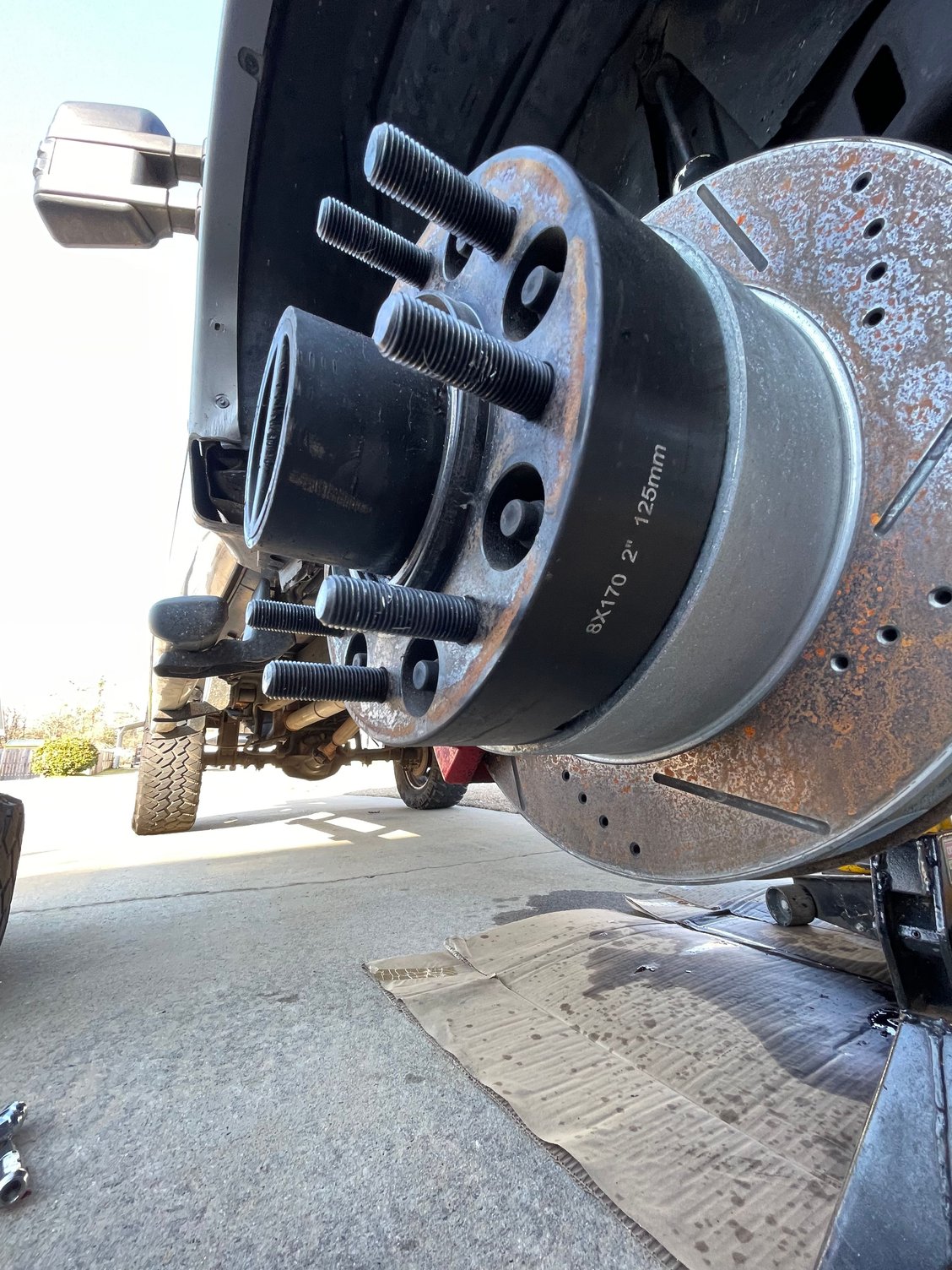

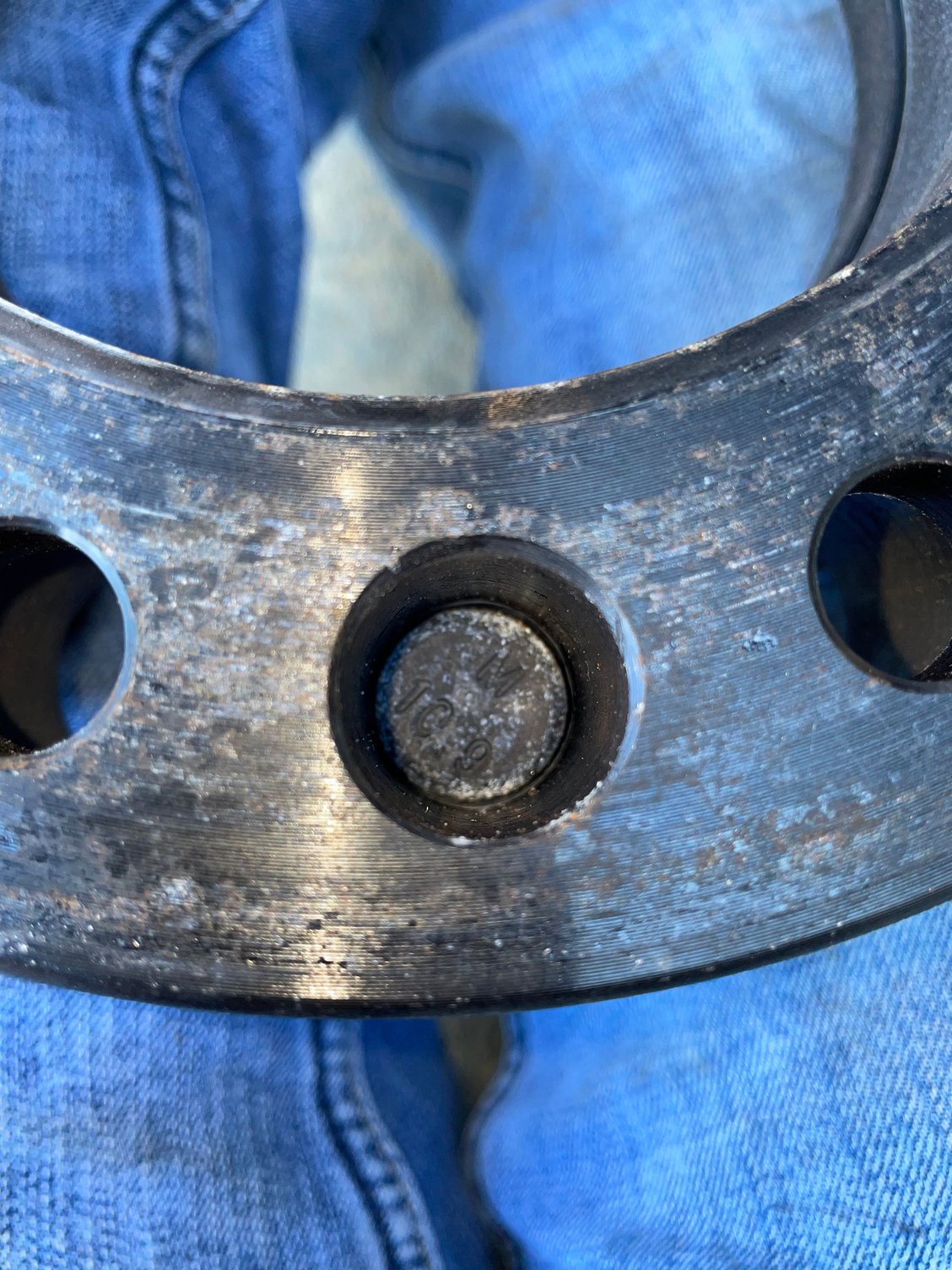

Wheel spacers installed, how can I determine the quality of this spacer?
Please tell me the “M” and 10.9 is a good sign on the back of the studs in this spacer.

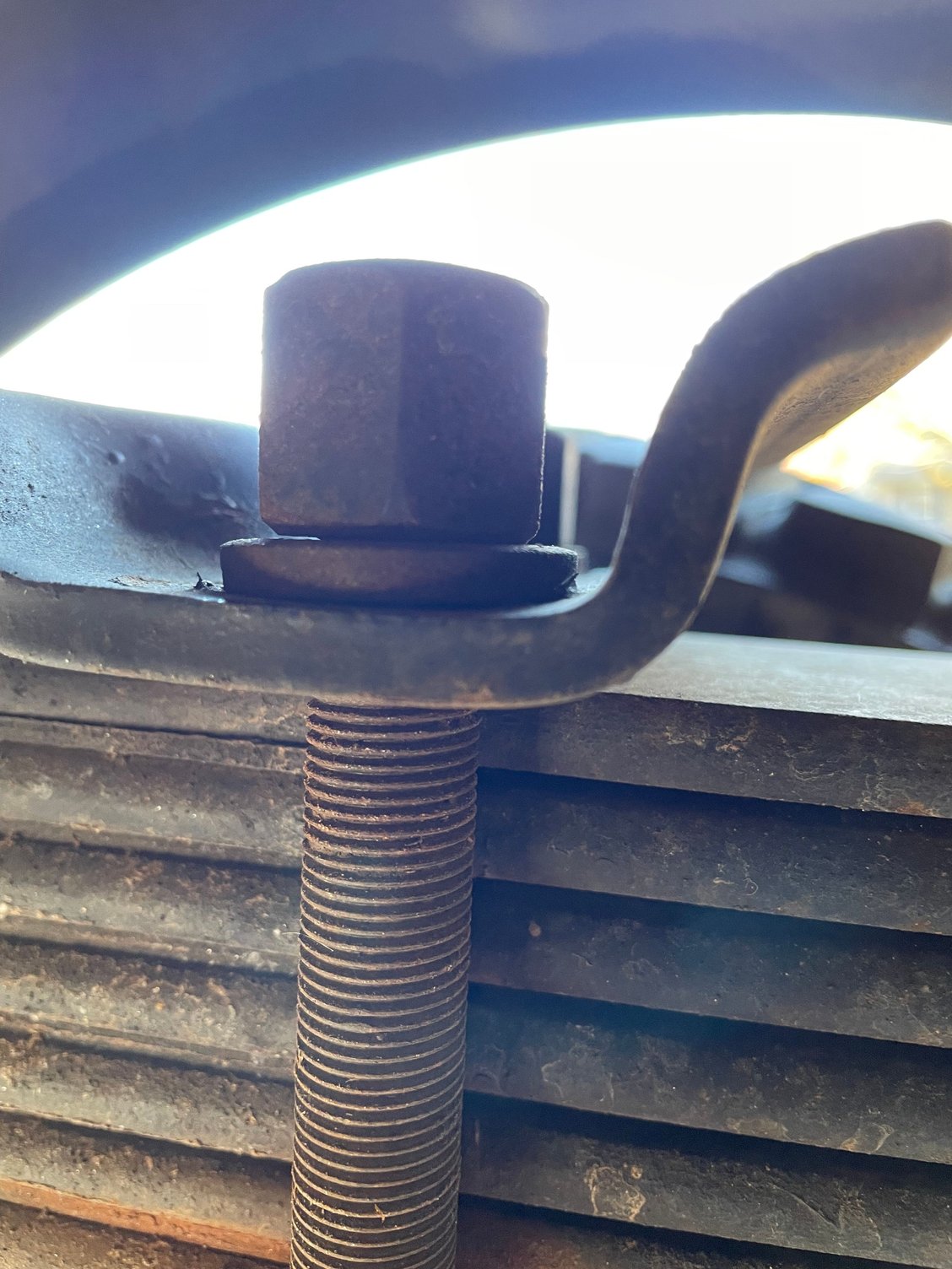

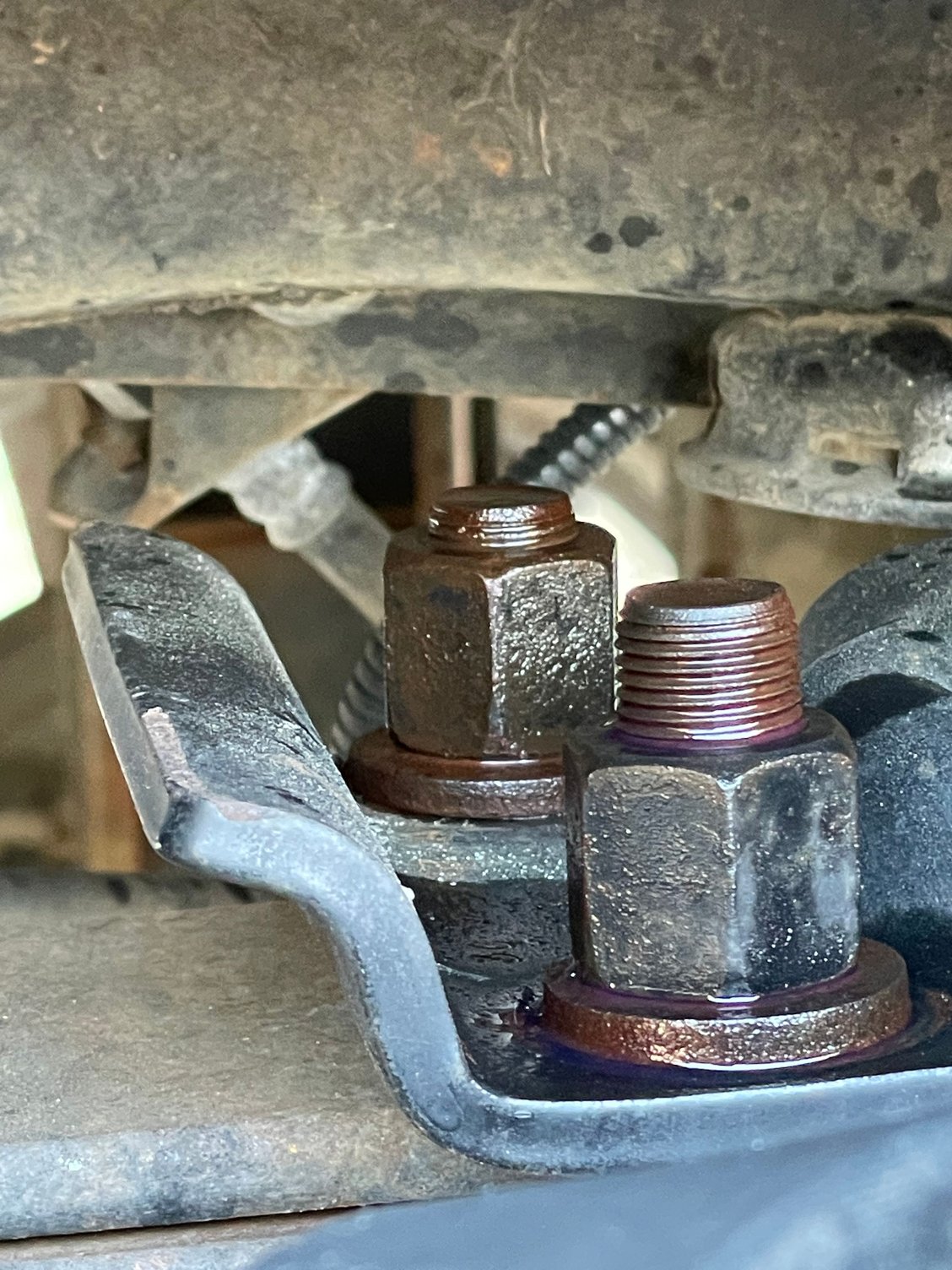

This is looking from the center of the truck out on the driver side rear spring U-bolts. If you look closely you can see light between the nut and the washer. I was able to spin the washer it was so loose.
This is looking in from the outside on the driver side rear spring. I was able to tighten the back nut in this picture which is the same one that was in the previous picture. I could have gone more but just stopped.

Loose U bolts are never a good thing……..
Yes, that lowest leaf (it’s only a half leaf that goes forward from the axle) is supposed to be a few inches below the main spring pack, it the factory traction bar and it should have a rubber bumper on the end that contacts the spring above to combat spring wrap.
Its my understanding that a metric grade 10.9 bolt is nearly identical to an SAE grade 8 bolt, which is pretty darned strong. Always make sure that the spacers are properly torqued to the trucks hubs, should be 168 ft/lbs, same as the wheel lug nuts.
I would clean up the wheel damage from the tapered seat nuts, ream any deformed lips out of the hole just to avoid any possible issues with the lug threads. The landing pads for the correct lug nuts look they are OK.
Thats a lot of lift block in there!

I’m trying to brainstorm about how I’m going to clean up those burrs with the tools I have. That’s going to take some thought I’m afraid. I plan to clean everything up really well before those wheels go back on. I took everything off with an impact but my calibrated touch could tell they were definitely not torques to anything near that spec. I will be breaking out the torque wrench to put it all back together though.

My 2 cents would be to go to a hub-centric wheel for safety sake and don't bother guessing what those spacers are worth, because they're not worth your life or that of your family.

Those wheels are hubcentric, just spaced for a coil spring front end. Definitely look into the pro comp springs and you might be able to run the same height tire with the new springs.
