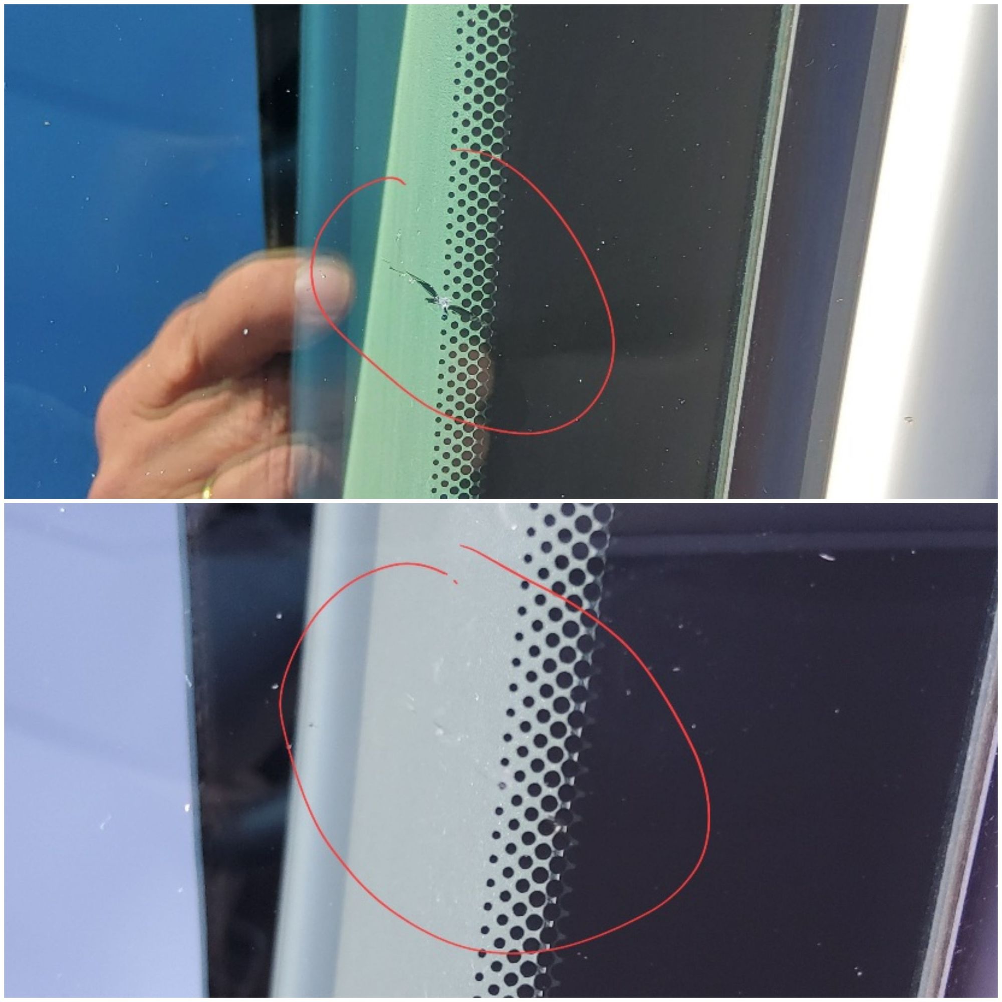

I'm sure I'm not the only one who does this but will throw it out for folks that haven't done it or thinks it's hard to do. The important thing is to catch it asap before it starts to run. I'll carry a couple of the kits in my truck so incase I get a rock chip in my travels It can get filled that night if it hasn't started to run. The repair kits cost $10-15 and can extend a windshield along time before needing replacement. I takes 1 hour tops to complete a repair.
There are a few name brands but what ever the parts store has that's what I'll pickup.
During the process of the repair.
The before and after from the repair. It was about the length of a quarter.
This should stop that chip/ crack turning into a runner. I had one last sping a little larger than a quarter that was spider webbing and after doing this process it has eliminated the cracks and you have to look for the chip which has not turned into a runner.

My 2012 truck had 6 of these done in 8 years and 212,000 miles. 1 of the repairs was the size of a quarter spider cracks, I though for sure it would run even after doing this, 6 years and never got larger and the cracks were barely noticeable.
I figure why let a chip run if you can stop it.
I just posted it to show some folks that might not of known to do it yourself before it grows. If letting a chip grow and getting your windshield replaced more often have at it.
