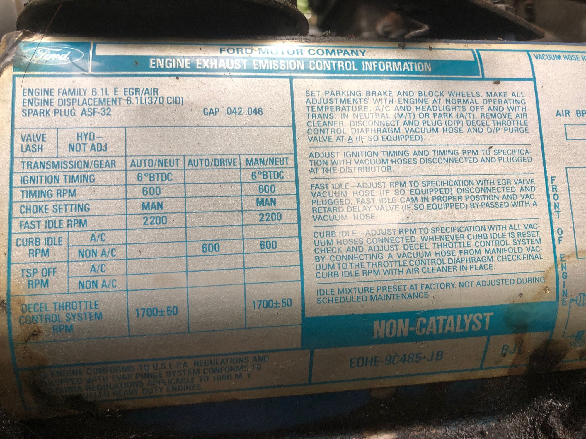

I'm just finding this old post- as I was searching for "79 LN600" because that's the truck I am trying to restore right now. The VIN on this truck is amazingly similar to mine, though mine was not a special order with this kind of body style.
I think the "B" decode above is incorrect for a '79- if it's a V8 and gas, then I'm guessing it might be like mine, and is probably the 6.1L 370 as noted below. This is the engine in mine, as can be seen on the engine side plate (pic of my engine and VIN below)

The B code works for the six or the 370 in 1979. Look at the pages you posted.
