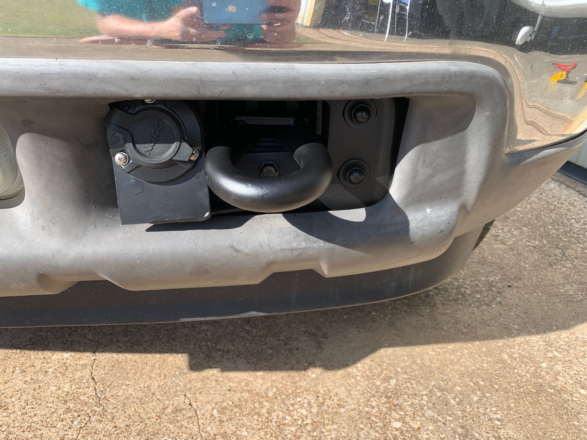

I have a small (2A or 4A maybe) single bank NOCO tender under the hood. If your charging system and primary battery wires/terminals are in good shape, you do not need a dual bank tender. The batteries are wired together in order to act as one high amperage battery.
I have a NOCO 120v plug in each of the corners of the front bumper. The plug on the driver side is for the block heater and the passenger side is for the battery tender.
These are the plugs I and many other FTE'rs use -
Amazon Amazon
They allow for a clean look and easy access to the 120v accessories.
