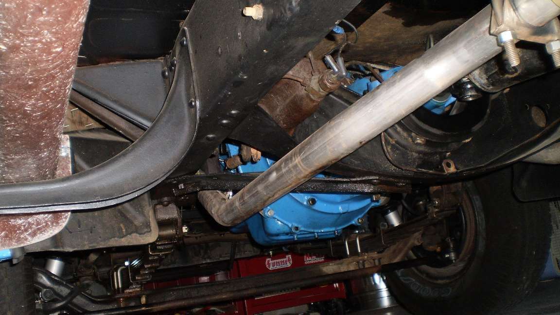

This is the underside of Ross's - ALBUQ F-1 - 1952 F-1:

It looks like the picture of Ross's springs might be with his truck on a lift. If it's not, his springs appear to have significantly more arch than mine. I'm having a little technical difficulty getting pictures from my phone to the computer, otherwise I'd post a picture for you.

No, I was just laying on the floor, don't remember what that pic was for.

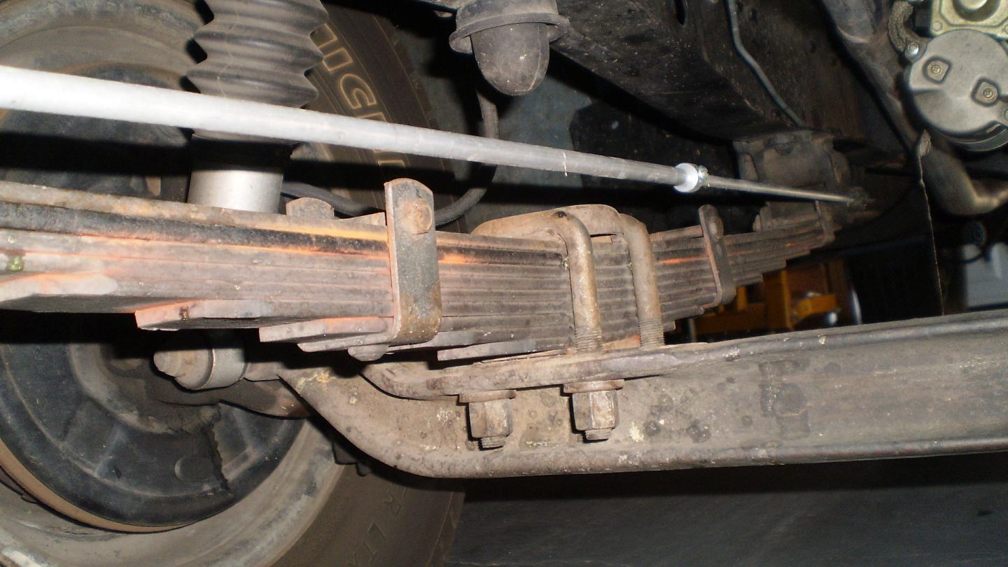

Here is a pic with a straight bar from eye-to-eye, so you can see the arch. I had an extra leaf added to brand new Eaton springs to get the front ride height I wanted (I don't like rake). I would say there is at least 3" of arch as it sits.

Using a straight stick as a visual aid like Ross did, I can confirm that my front springs do not have any arch and in fact have a slight reverse bend at the ends of the longest leaves. My truck is up on movable castors for storage these days, but I would estimate my front end ride height to be about 15 inches from the bottom of the frame horn (where the bumper attaches) to the floor. This measurement is actually 18 inches, but as mentioned, it's off about 3 inches because of the castors.
I always thought my truck sat pretty level, but I'll have to take another look at that when it comes out of storage. My springs are probably old and tired. It wouldn't be good for one of the main leaves (with the reverse bends) to suddenly snap going over a pothole.
We were comparing your Red's Headers extensions to mine.
