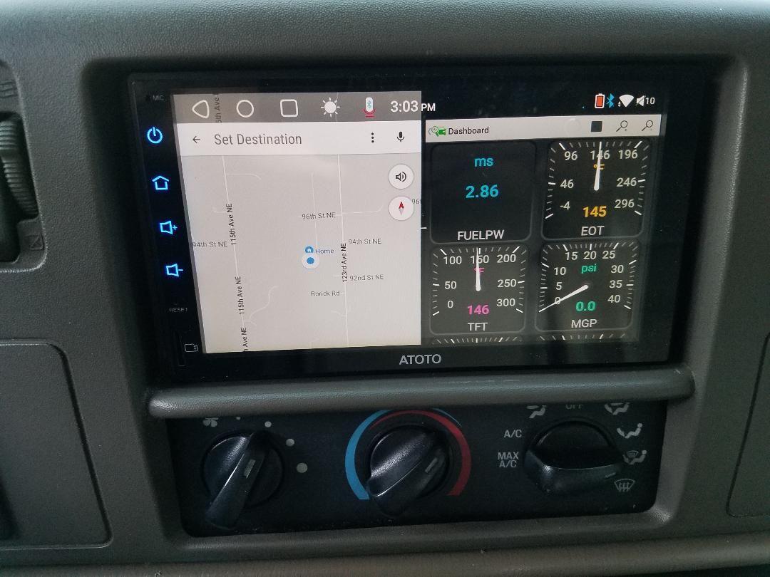

I hear you there, Diesel4Lyfe. I'm using an ATOTO android based headend (radio). It runs the FORScan Lite app. This is the S8 premium model. If you go this route, I'd recommend the less expensive A6 Pro, though. I have both units in different rigs, and the A6 Pro has been more reliable. The S8 has required a factory reset to get the soft buttons working again. It's a 1st generation model though. They have a 2nd gen now.

Note that the S8 Premium has the split screen feature, not the A6 pro. Unfortunately, not every app likes running in split screen. It's a feature of the customized android version running on the S8. Waze likes it, but FORScan Lite does not always start up in split screen mode. I ended up abandoning that feature, and just switch between full screen views of each app using the square soft key at the top of the screen.
