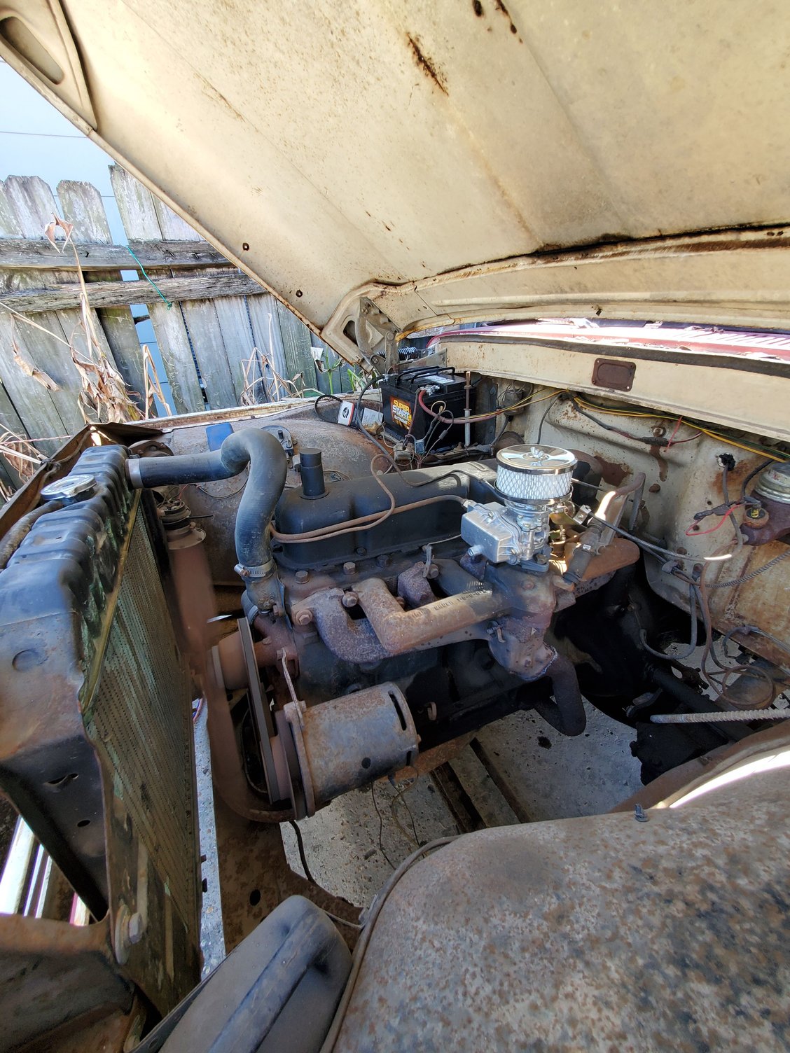

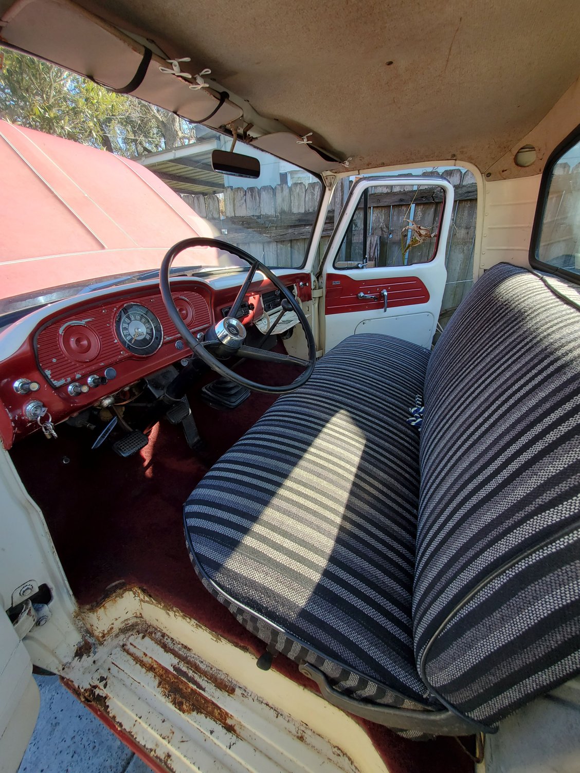

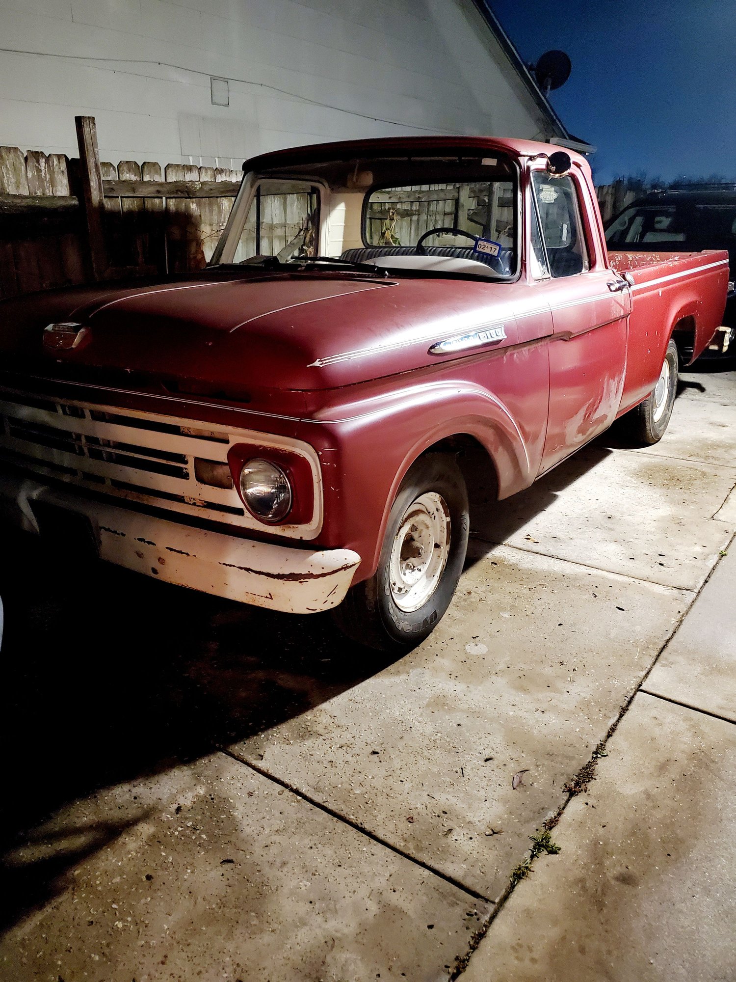

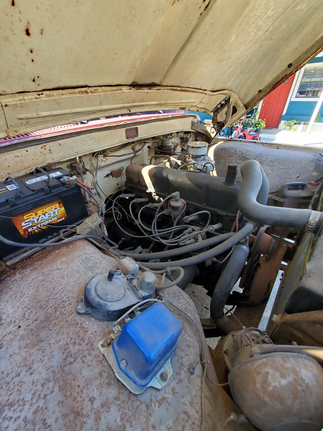

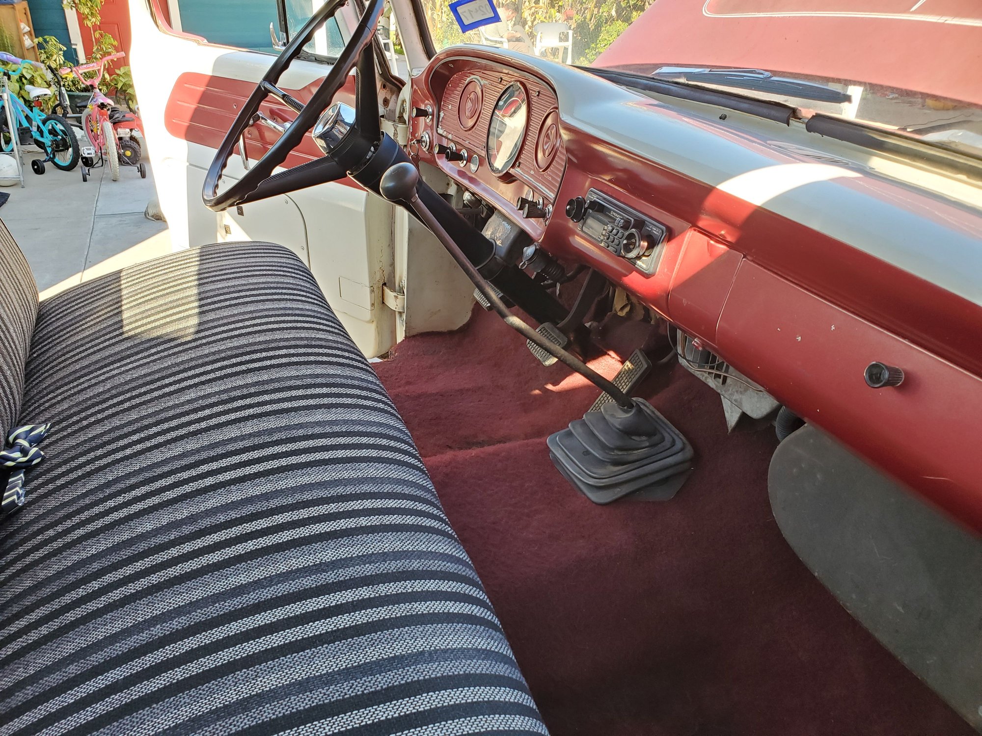

Hi,
I just bought a 1962 Ford F100 Wrongbed. I would like to tackle as much of the restoration my self. By no means am I a mechanic so this seems like a daunting task but willing to learn as much as possible. I would like to use this as my daily driver. Any tips that woukd serve me as a checklist and order of tasks. Truck has original 223 inline 6 engine. Runs well. Everything else original.
