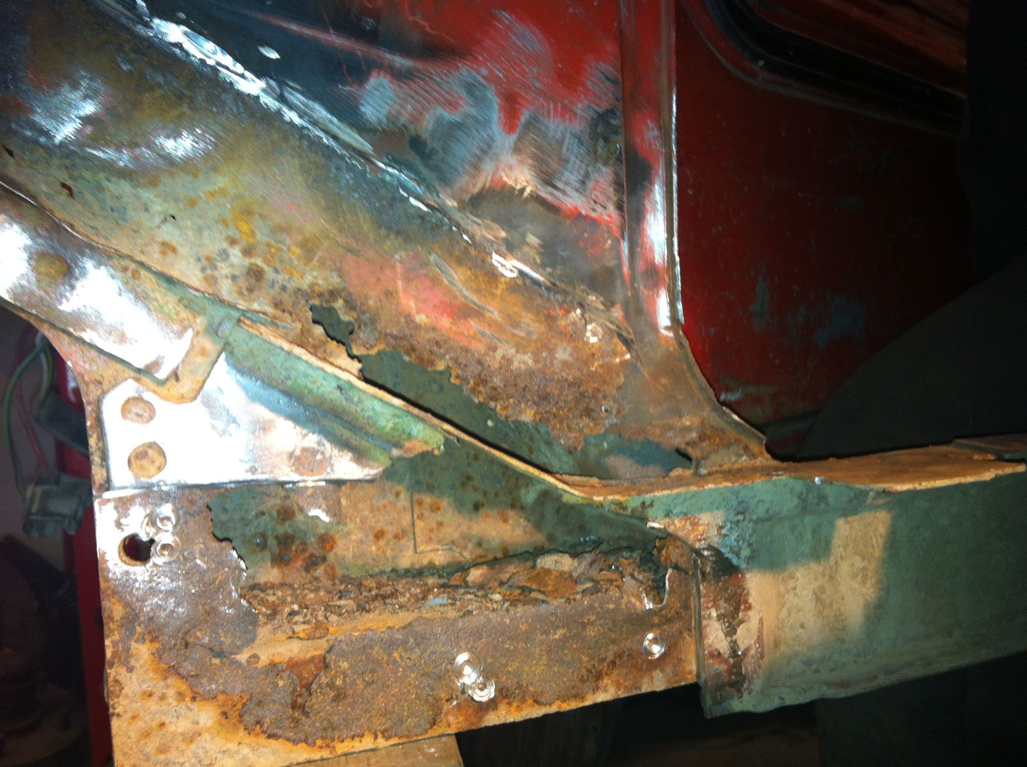

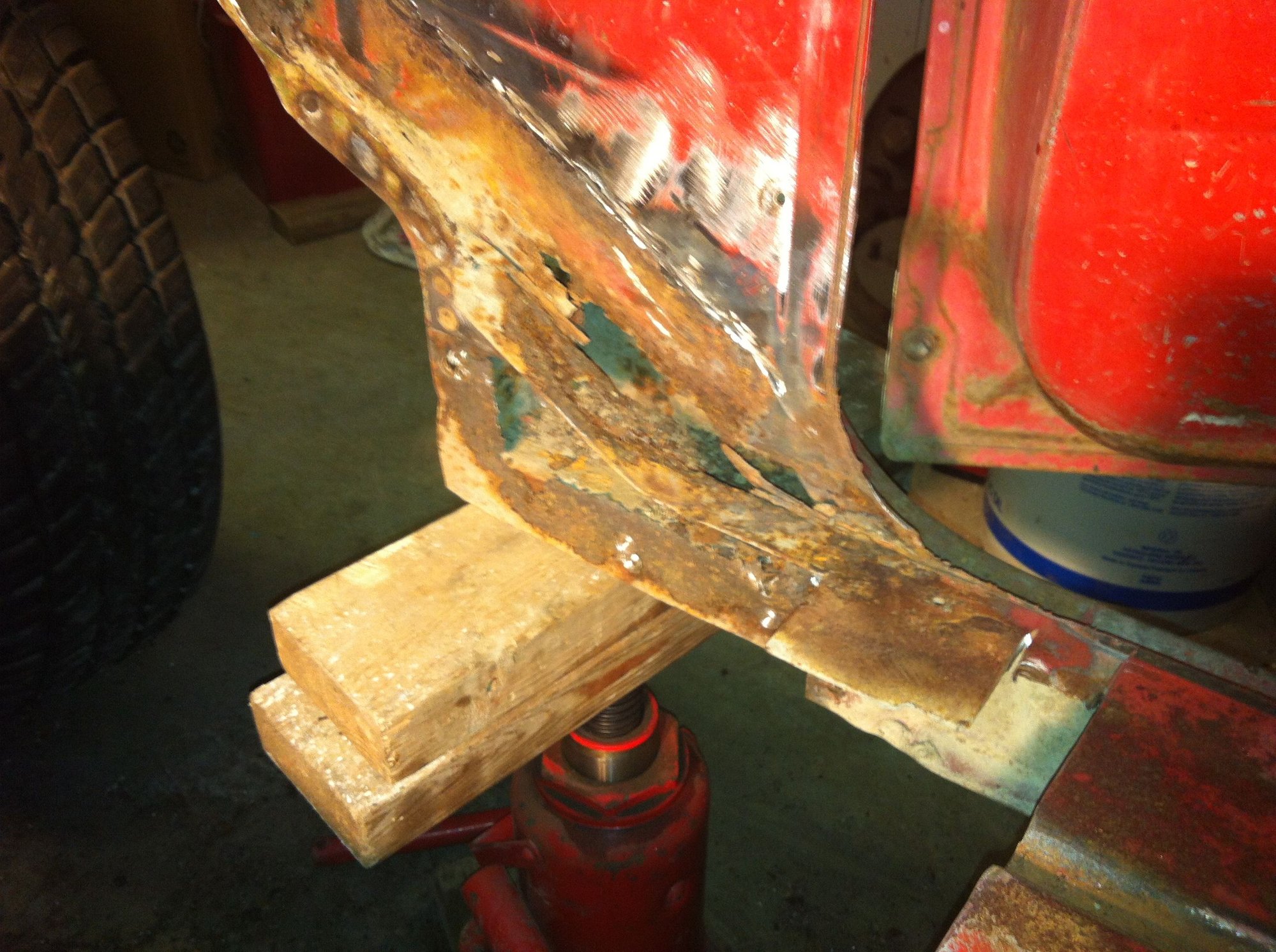

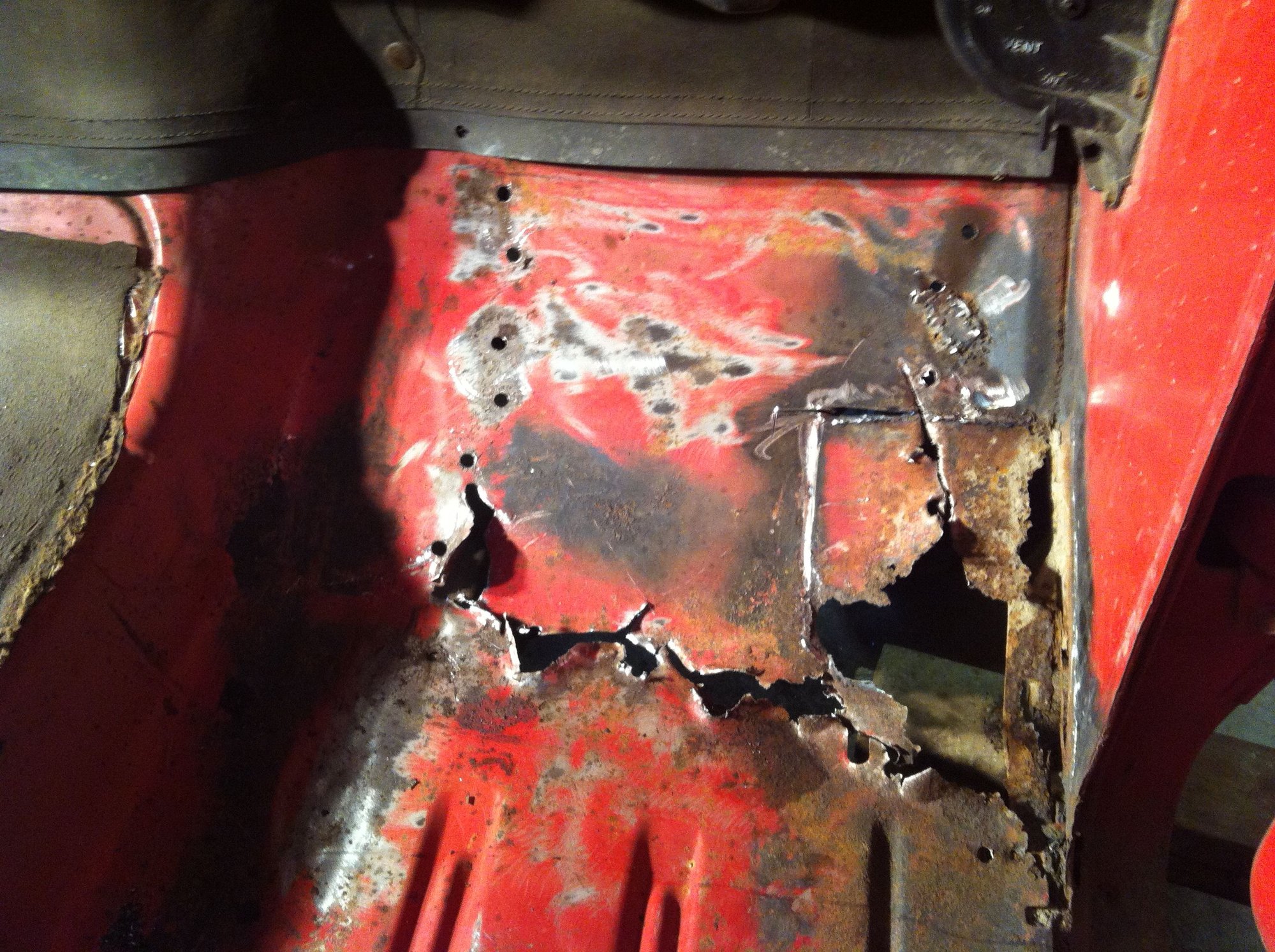

Here are a few before photos of the passenger's side.
Over 10 years ago I had a patch welded in just so I could get it through inspection. The time had come to do it properly.
As you can see it was badly rusted.

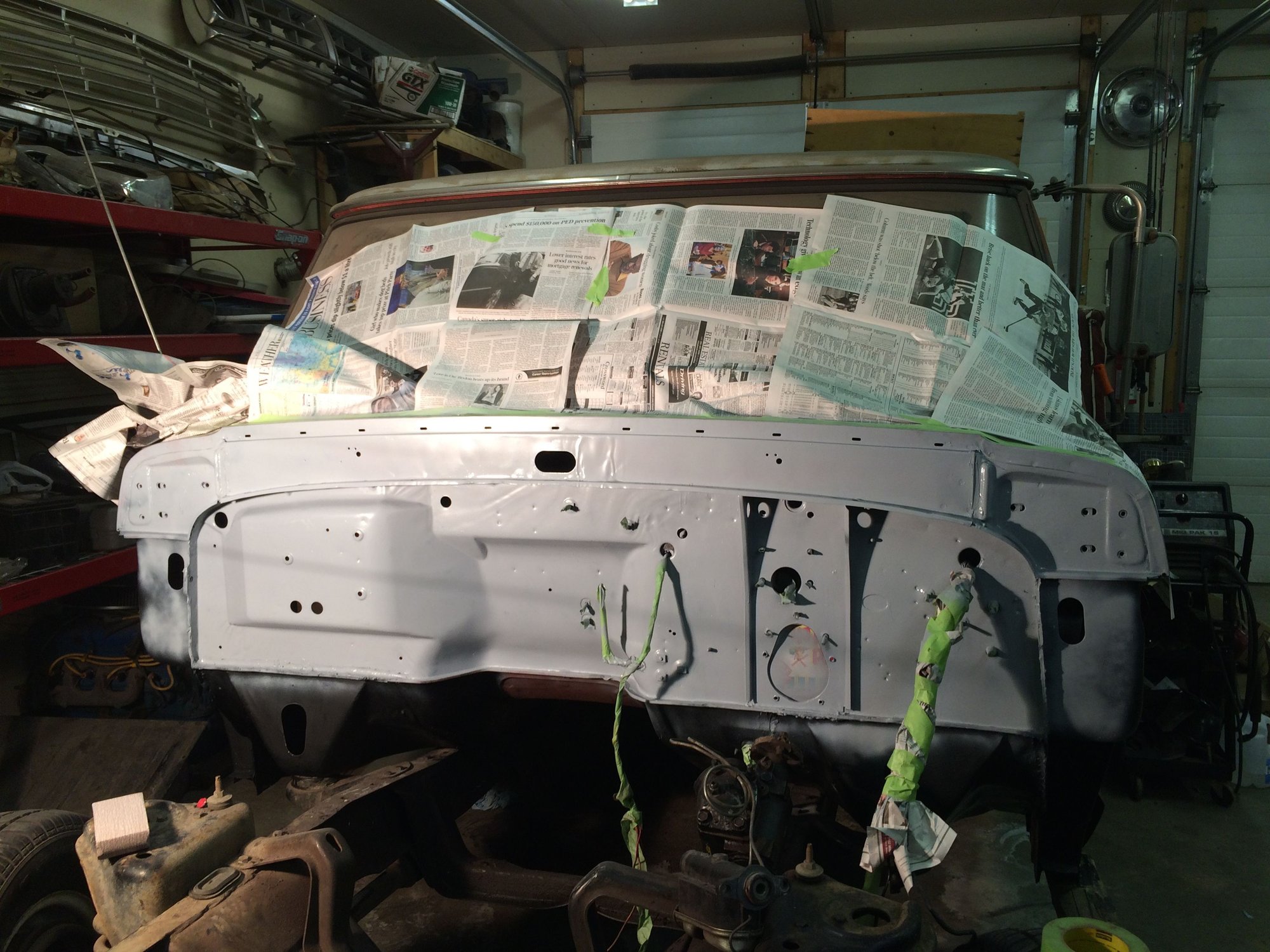

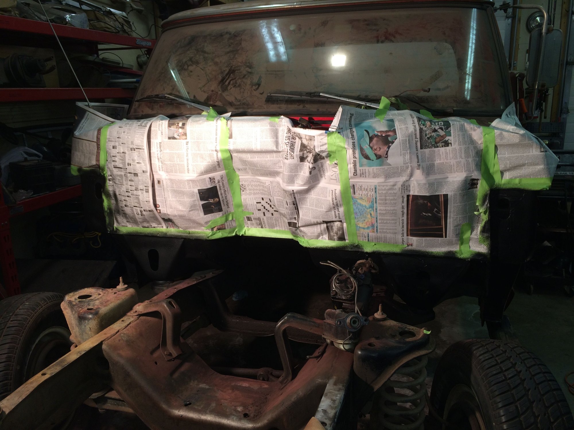

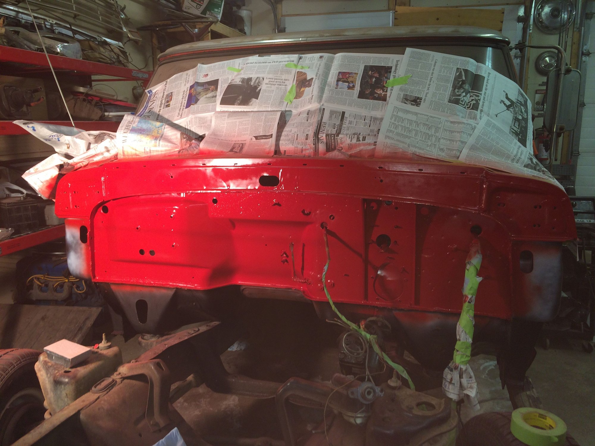

Getting ready for some colour.
Old Nov 21, 2014 | 12:51 PM
Trent_Lalonde's Avatar
Trent_Lalonde
Joined: Sep 2005
Posts: 124
From: Saskatoon Saskatchewan
2 spray bombs of Rangoon Red later. The areas I didn't paint will be sprayed with rubberized undercoating.

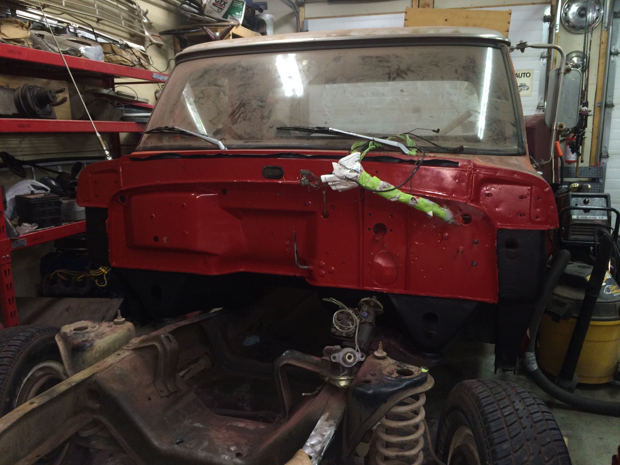

Rubberized undercoating done.<br/>

Looking great Trent. I assume the areas you sprayed with the undercoating are areas that may be subject to road abrasions?
Old Nov 25, 2014 | 11:46 PM
Trent_Lalonde
Joined: Sep 2005
Posts: 124
Yes. I prepped and coated everything with POR15 then primed the areas to be painted with POR15 etching primer and sprayed rubberized undercoating everywhere else. I'm building IT to drive it and I don't want to deal with the rust ever again.
