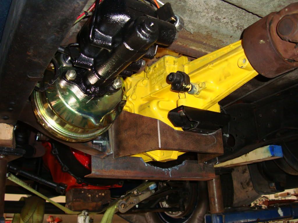

Old Feb 8, 2022 | 05:20 PM
Rembrant's Avatar
Rembrant
Joined: Jul 2003
Posts: 1,844
Likes: 129
From: Atlantic Canada
My '52 M1 had a 1987 Chevy S10 5spd in it when I bought it. I have since removed it as I'm swapping in a SBF and 4R70W. I don't have many pics of the interior, but here's one that shows where the shifter was located. I have some pics of how the trans was mounted, but nothing exotic...homemade crossmember.

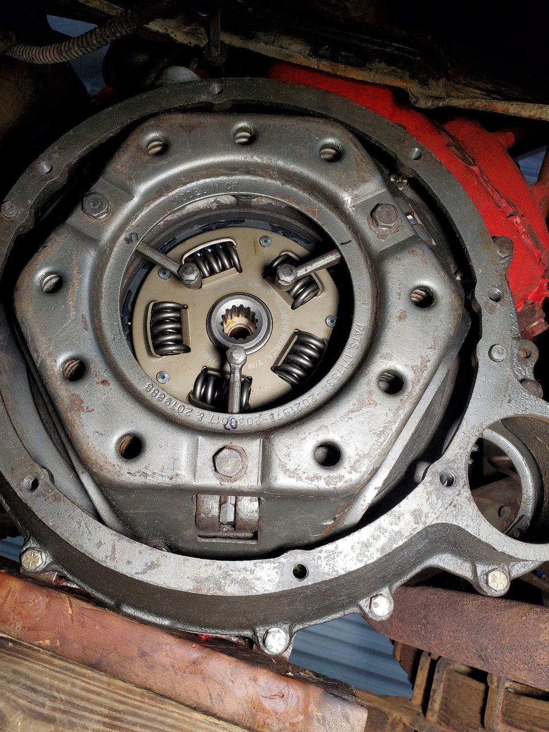

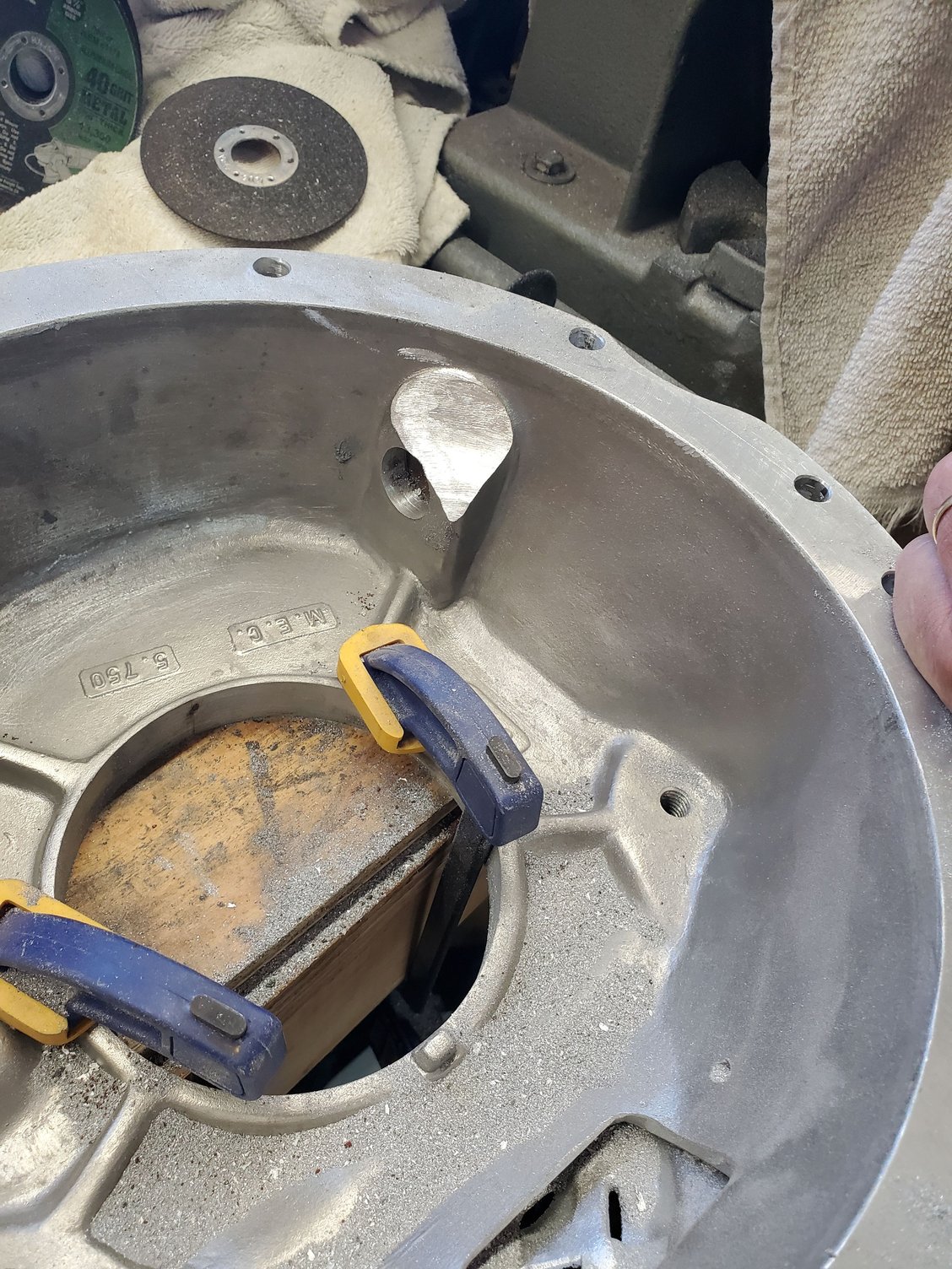

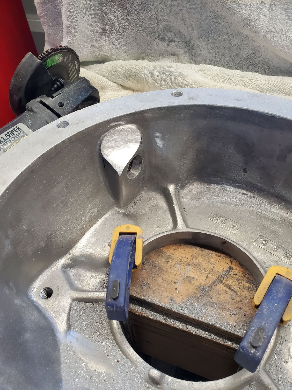

Old Feb 9, 2022 | 08:17 PM
33ratrod's Avatar
33ratrod
Joined: Dec 2020
Posts: 51
Likes: 8
From: I live in FL and MO.
I just did this to my 51. Had a 4 speed and changed it to a T-5 Trans. Used a Cornhusker bellhousing, took some modifying to get it to work but worked great. Used the stock 11inch flywheel and pressure plate with an 11inch clutch plate from a Astro van. Put an after market bolt in cross member
