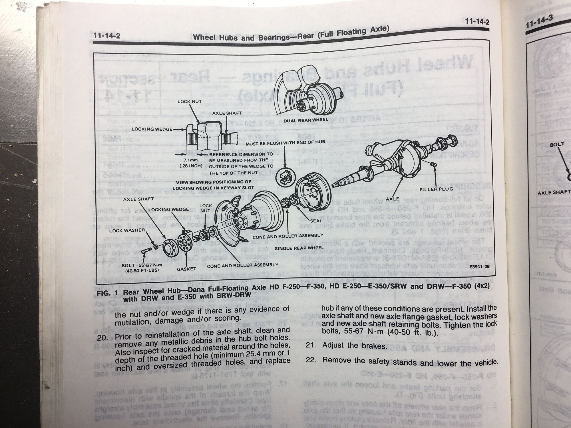

    Here are the details straight from the Ford 1984 service manual:
