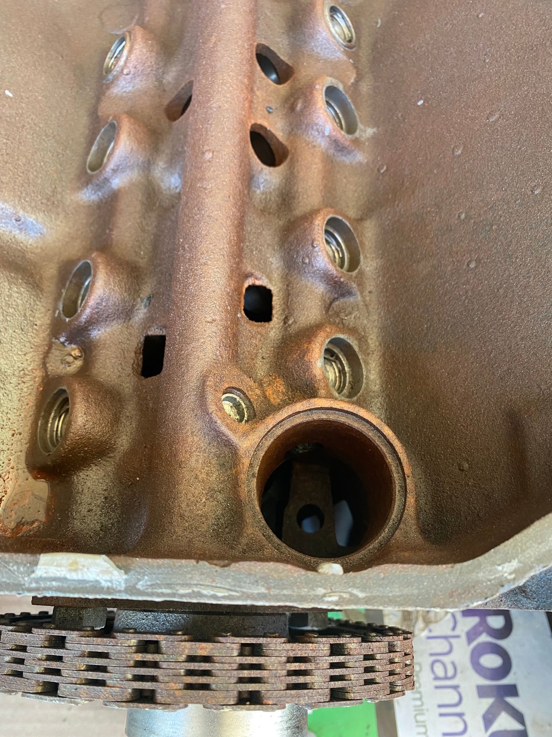

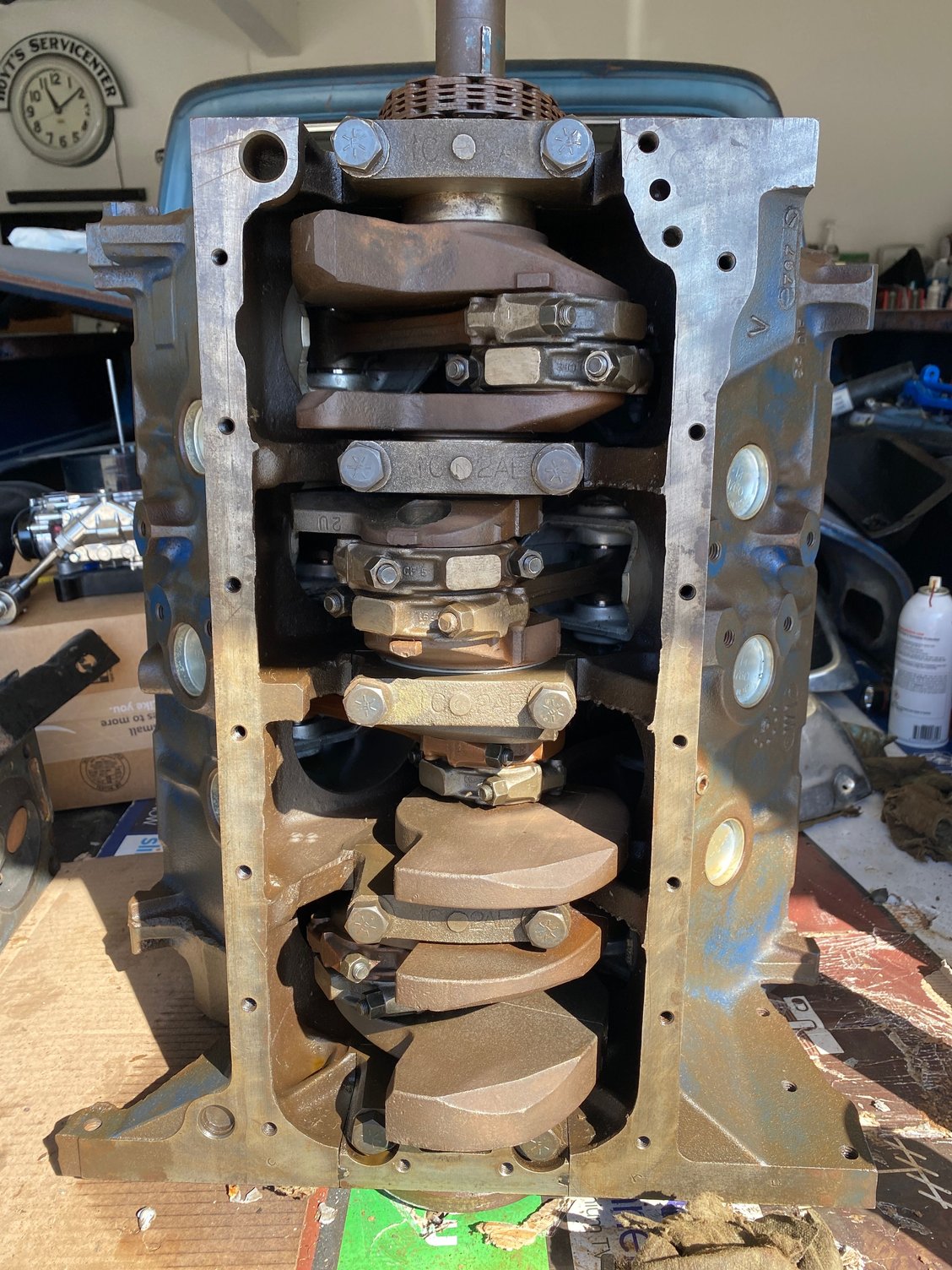

I bought a 1969 F-100 360 3spd to work on after I finished my 72 Chevelle. It ran good, but I rebuilt the steering, suspension and added power front disc brakes. I’ve been working on replacing the front inner fenders and radiator support. I added full length headers and a Flowmaster exhaust. I recently purchased a 390 short block from a 68 Mustang that was rebuilt, but never started. The Mustang was purchased by a classic car restoration shop around my area and they immediately pulled the motor for a restomod. I was told the 390 sat for 10 years, but it is not seized and turns easily. It was obviously rebuilt. My concern is the pitting at the top of the one cylinder and the rust on the crank. Am I able to clean up this rust on my own or does it need to be torn down and taken to a machine shop? I also have a 4bbl S intake with some rust inside the plenum and runners. I’m not trying to build a race engine just something with some more power than the current 360. As I was filling the radiator back up today, I noticed the front of the intake leaking on my 360. So I’m try to decide do I just reseal that, do I replace it with the 4bbl S intake or do I just do the motor after getting it cleaned up while the fenders are all off? Like most money is tight, I just purchased a AAW classic update wire harness kit. Please let me know your thoughts! Thank you in advance!

Depending on the combustion chamber size, and how far from the deck those actually end up, and your choice of gasket, those pistons could give you 10+ compression. Carefully measure and calculate the compression ratio. Aluminum heads and an aggressive cam will counter higher compression but I'm not reading a desire for that in your post.
The rust that we can see isn't a deal killer but you don't want to seal it up and run it with all that rust. Plus, we can't see the cam lobes and main/rod journals. Probably ok but this is a fair amount of work to swap out an engine only to have it start to burn oil or run poorly in a short time. Maybe pull a main cap and rod cap or two and see what they look like. I'm not sure how to clean up all the rust though. Lots of little flakes to run through the bearings and oil pump.....

I would send the 390 block to the machine shop as is if you go that route of having it cleaned up and checked out (sonic checked and check for core shift). Opinion: replace the steel freeze plugs with brass while they're at it. In the mean time, have fun with the 360 and install that 4-barrel intake after you clean it up. Use a 1" phelonic spacer and install the QF 680cfm carburetor. I don't believe that will be too large as i have a 600cfm vs on mine without flooding issues.

I’m disappointed in the 390 I purchased because I was under the impression that it would be ready to run. When I send it to a machine shop, would you recommend leaving it assembled as it is or tearing it down? I’m a little concerned that the cost of the machine work is going to exceed the price I paid for the 390. I have buyers remorse because now I know I paid too much for it and probably should have saved a little more for a newly rebuilt 390 short block.

As far as the 390 short block goes, I wouldn't stress that being an issue just yet. Save your money and get it to a machine shop/machinist/FE builder so it can get checked out as it is. It maybe perfectly fine, but the insurance of having someone verify will be worth it versus slapping it in and finding problems after you've spent time and money only to take it back out.

If you have an engine stand and hoist, take it apart. Do the bores even have cross hatching? You can clean it all up and then take the block to be checked. If the crank has surface rust, the cam probably does too. Measure the bores. As far as the intake goes, clean it up and use it like mentioned above. They are heavy. Two people make it easier with an engine in the truck. On and engine stand it is not that bad. You want to set it straight down where it belongs. I would definitely like a better intake for my 390fe, maybe later.

If you take it apart, I would soak the crank and everything that has rust in Evapo-Rust. Have the block dipped and checked out then reassembled.
