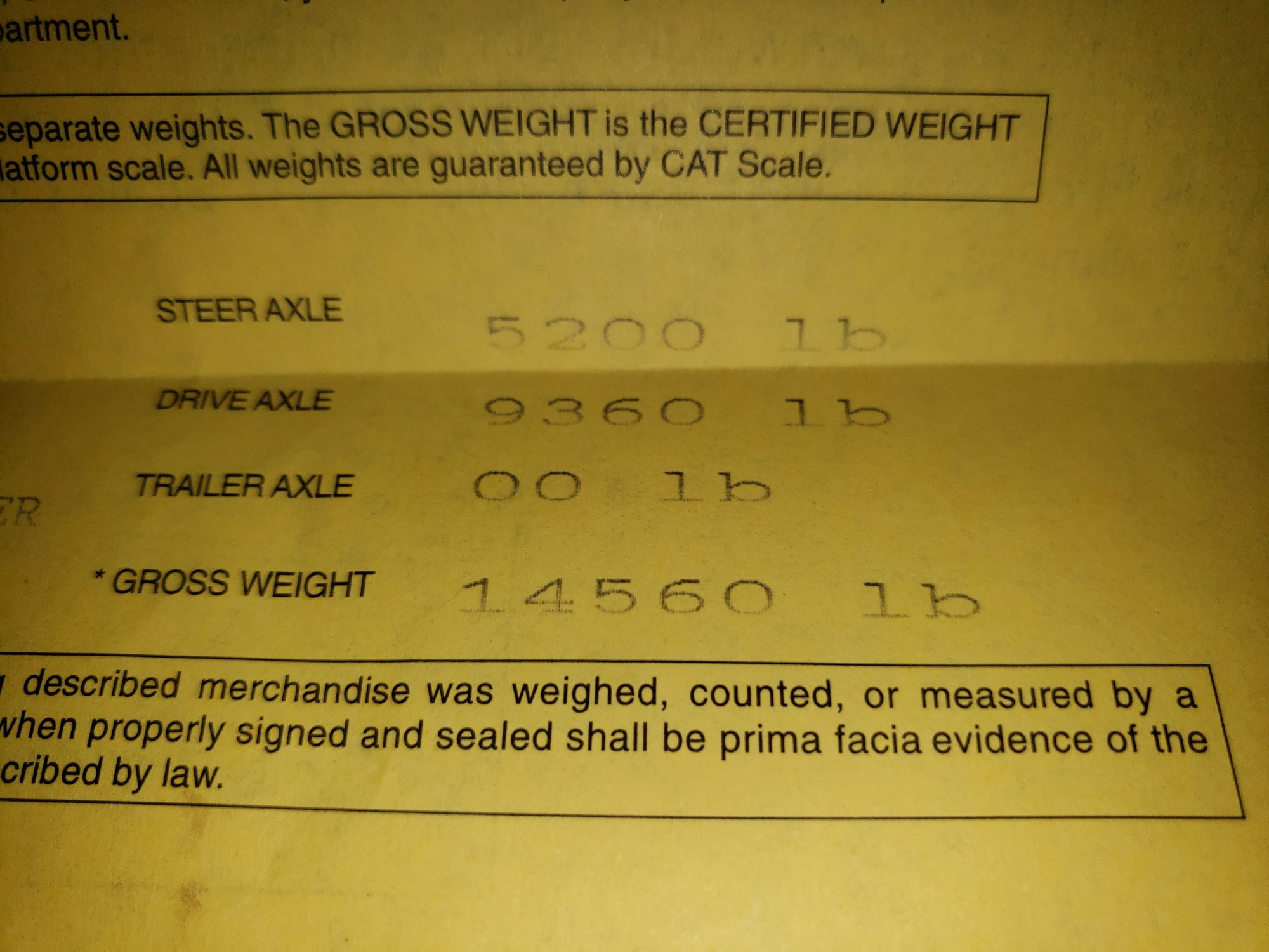

My CAT sticker, Steer 5160, Drive 6440, trailer 10140, GCWR 21740. That was on it's first trip, I would not be surprised if it now weighs more, especially since I added 22 gallons of fuel, or was it 26, can't remember what that tiny tank held. If it were just the wife and I and had a smaller trailer like the Arctic Wolf 261RK, an F250 would be a perfect fit for us. For the difference in price though, if having to get Class D for the extra GVWR, then F350 would still be the right choice, but again, thats because of Hellinois.
