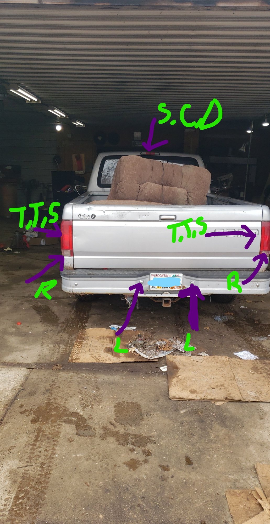

heres a 96 xl S=stop, C=cargo, D=door T,T,S= Turn, tail, stop R=reverse L = license plate lamp Technically, the TTS is also a Sidemarker, so maybe TTSS. It functions as the rear red side marker when viewed from the side of the truck.

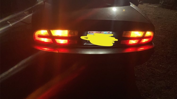

This is my car but the tail lamp has 4 turns, 4 stops, 4 tail bulbs on the rear. The deck lid half are not legally required, they could be burnt out. the permanently mounted body side half are required. the reverse, sadly, is the top 2 of hte center 4 pods near the license plate that are unlit here. the decision to make 2 fake was dumb as hell but they are fine generally. the license plate is well illuminated with 2 thats normal. The car as you can tell has no side visible red, so ...
it has a side marker on the rear quarter on each side
As seen here the side marker on the back mounted low, the amber turns are clear when not lit (safer than red even red bulb behind clear)
I have a thing against the forward mounted turns.... lol
Mine were junk and ugly which is how we ended up with clear with amber bulbs. Id also like to install switchbacks in the center of the truck amber ones(the turn itself not the park lamp on the corner but also not the 194 sidemarker) That would be like a DRL with the park lamps on and look a little modern
as one may tell i take my lighting far
