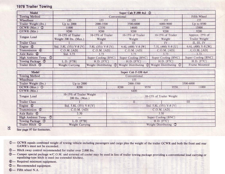

"Legal" is determined a few different ways. The weight your axles, wheels, and tires are rated for vs. the weight you actually have on them when you get scaled seems to be the most common way things are enforced. Keeping things under GCVW and GVW are another thing that can be checked easily. That being said, it doesn't seem like most people ever get checked unless they are commercial. Unless your setup looks way outside it's capabilities, you will not likely be bothered. You need to keep things safe and that probably starts with brakes, suspension, steering, and last of all enough engine.
You are way out there from what the factory rated the trucks at. If that is what you want to stick to you will need to go a few sizes smaller on the camper.
Here's a picture from a couple pages of the 1978 Ford Trucks owners manual. I doubt things changed much in 1 year, and this is the one I have saved on my computer for reference.

Yes on the 6400 GVWR. What else is the cert telling me?
