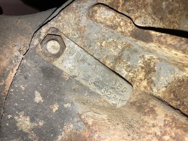

Here are some photos of the truck and the door and differential tags.

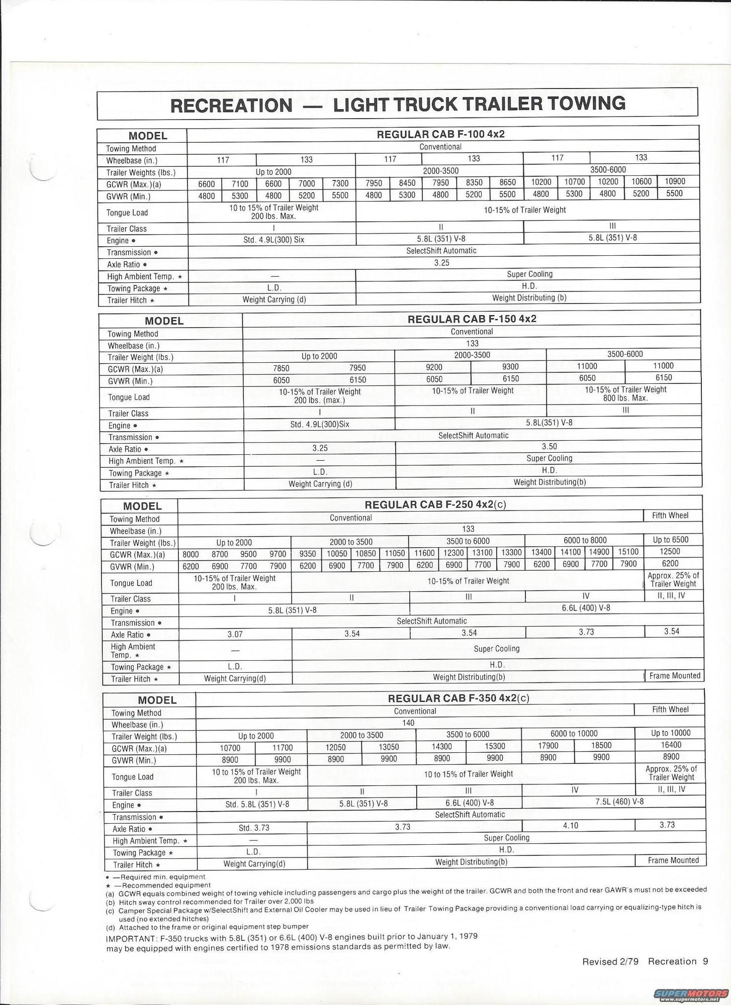

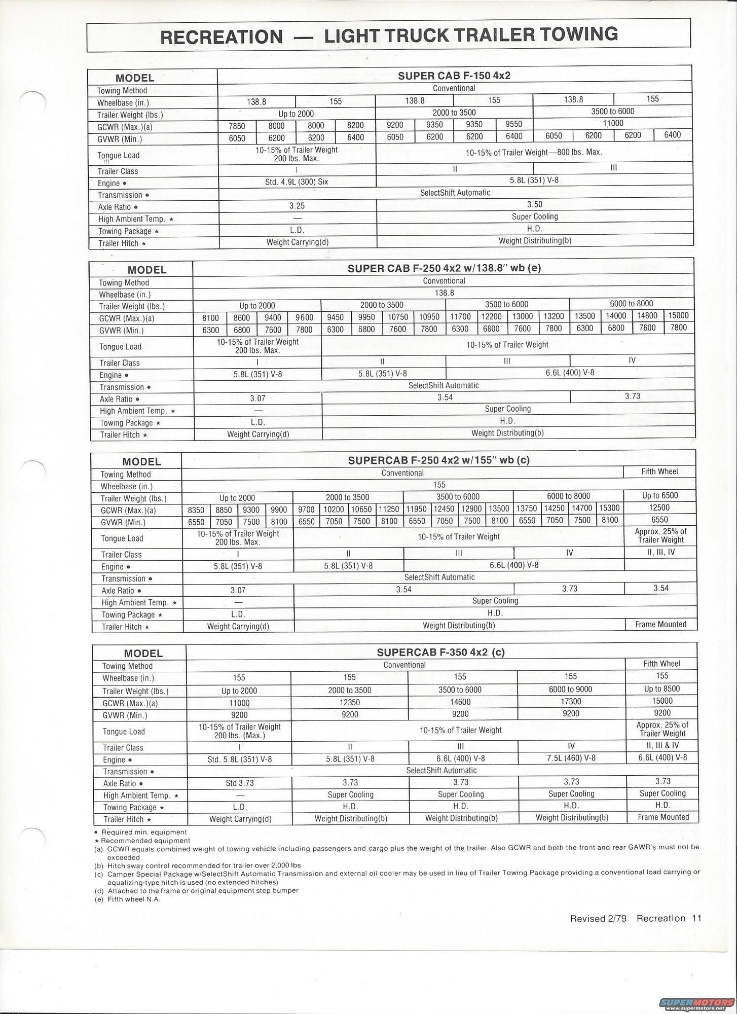

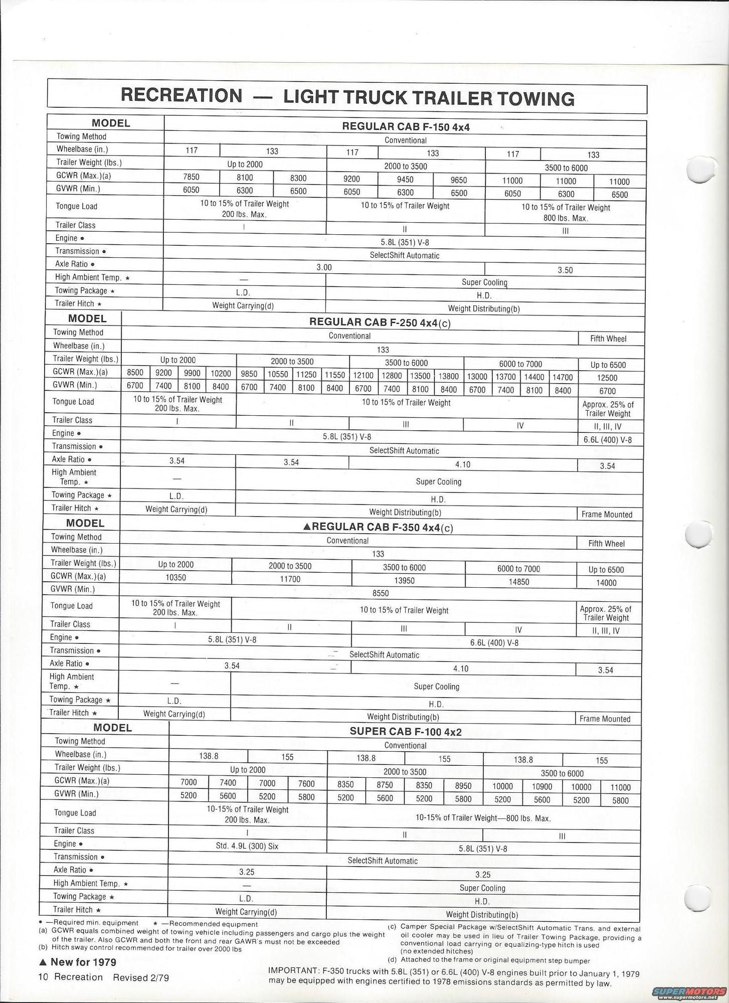

I think we need a sticky for *realistic* towing setups. Those charts would be a great start, Rich. It would also be cool to track people's mods for towing different weight classes, including axles, springs, transmission upgrades and so on.

Your axle I’d tag shows a 3.25 gear ratio. Not bad but I’d like a little more gear depending on tire size and the amount of weight you are pulling.
Does the truck have a transmission cooler? What size radiator? Take a few pics of that area if your not sure and the guys on here can help you out on that as well.
My truck is a 4wd, 3.50 gears and the super duty cooling package and a transmission cooler. When I do pull the ATV trailer and with a full load I’m pulling right around a 2500 pound load depending on what’s all on it. I’ll pull that load for up to 3 1/2 hours one way (except stopping for gas one time on the way...as a 19 gallon tank at 9mpg doesn’t’ get you far) to our place up North with no issues.
Tow charts/diagrams start on post # 46, this thread has been red stickied for years for your easy locating ability. Lol
https://www.ford-trucks.com/forums/1...l#post14810148
