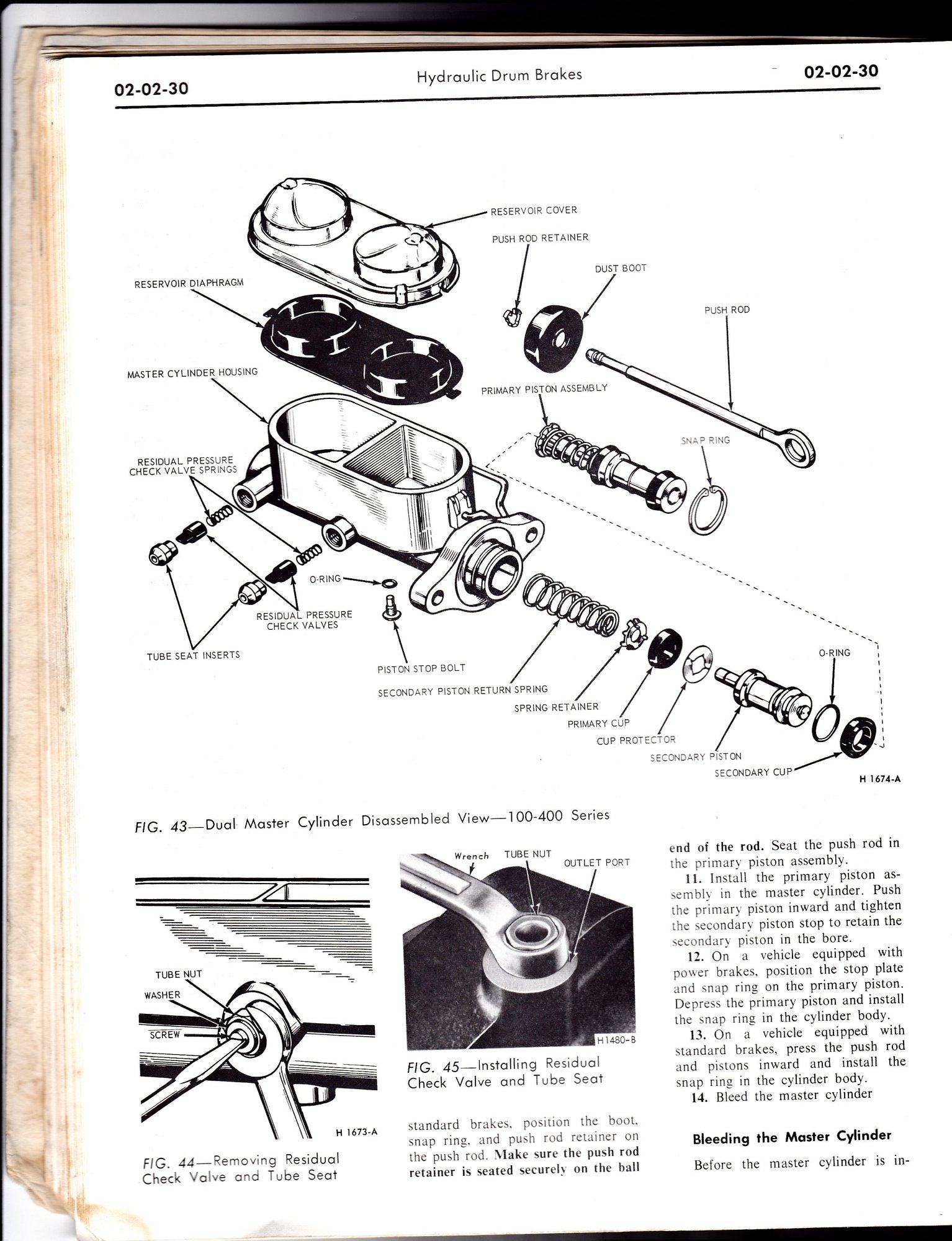

You cannot add a residual pressure valve. They are part of the master cylinder. Master cylinders are specific to the system they are in. Disc brakes do not need that because there are no springs in the calipers to push fluid back into the master. If you have drum brakes, you will never get them to work right without the correct master cylinder. The part number you posted says it is for disc-drum.

Dual master
This is from the 1969 chassis manual. Of course, this is a Ford manual, and it appears your master is a General Motors part.
