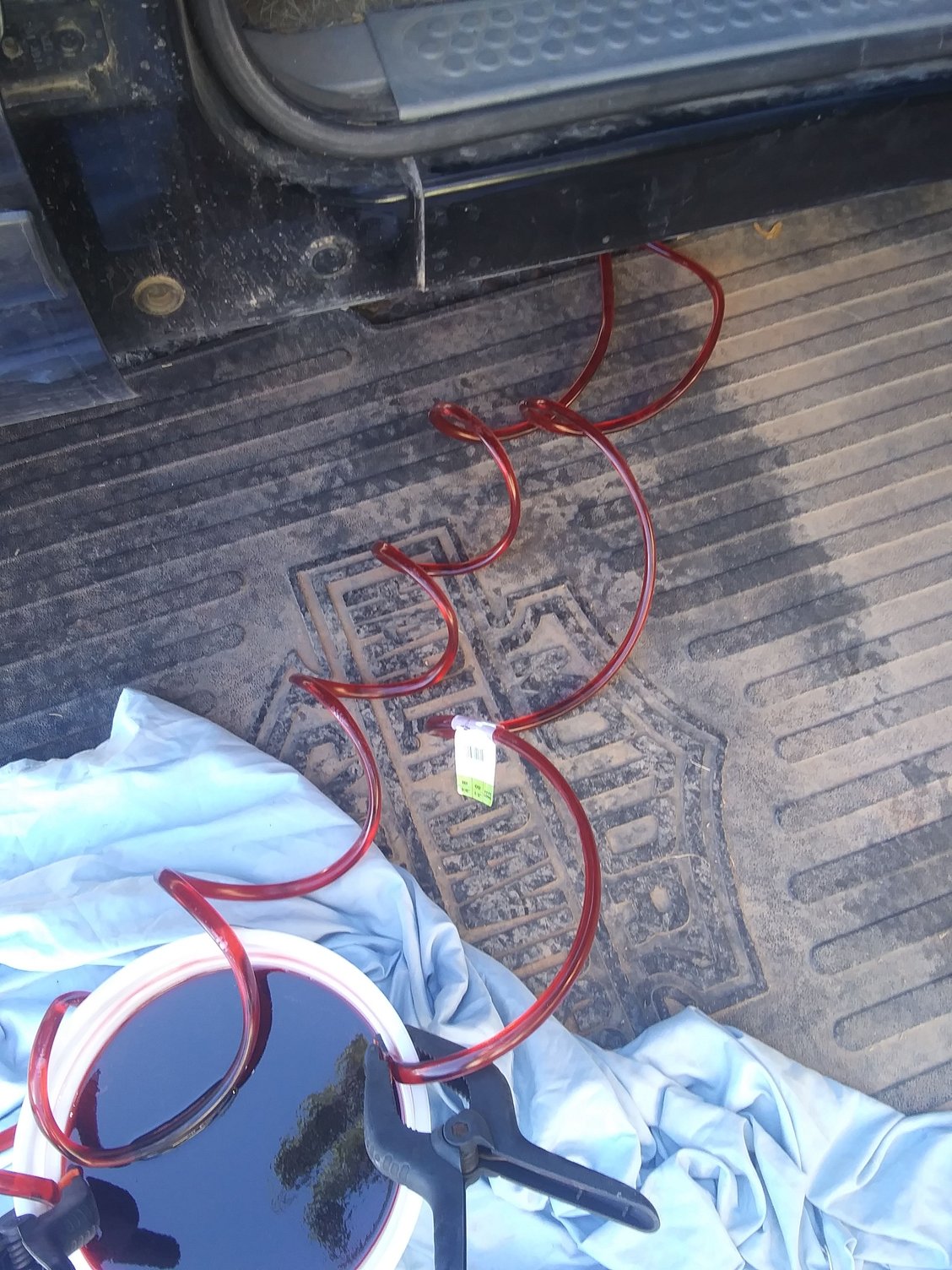

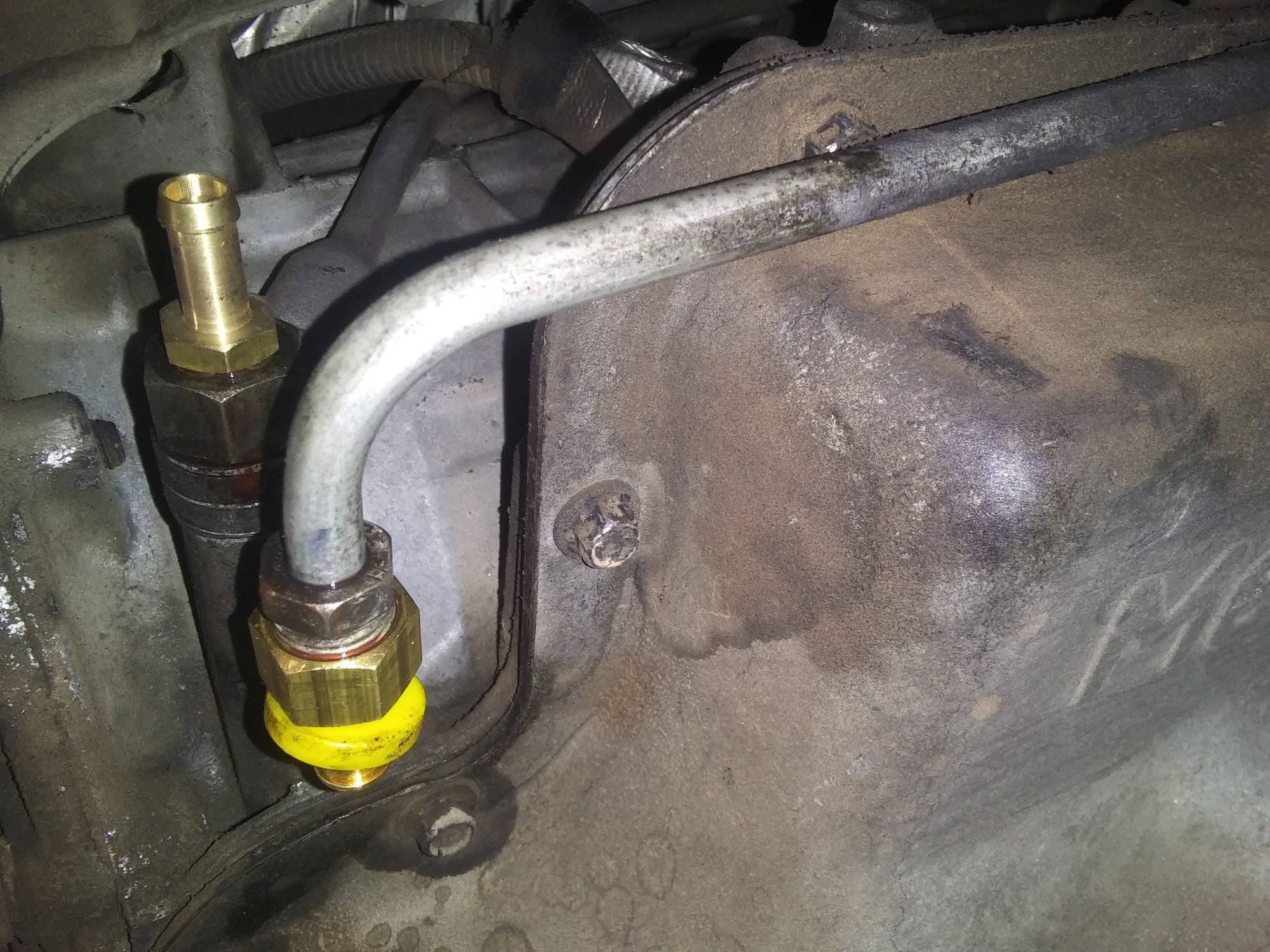

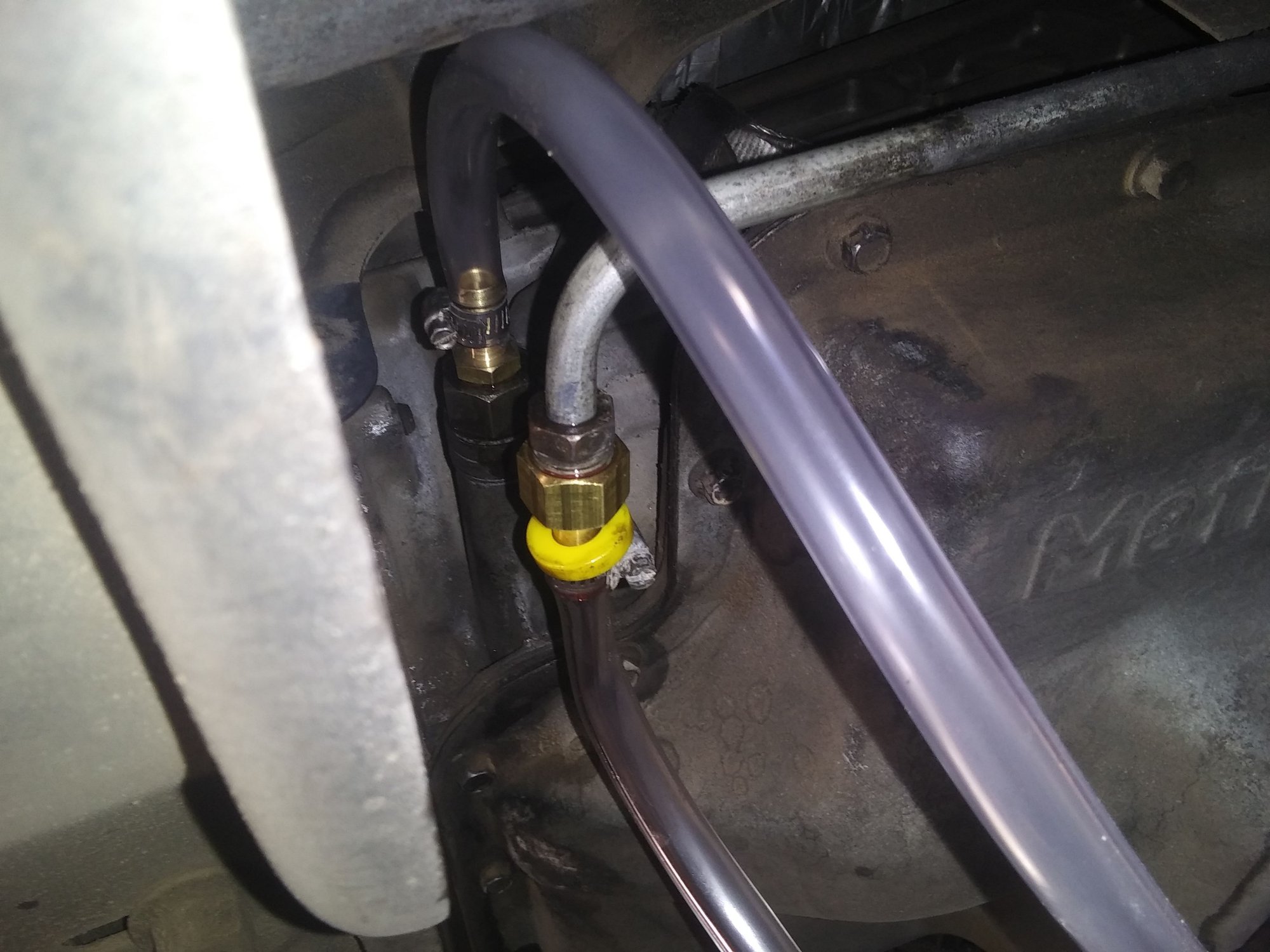

@HKusp. Hey stud, after reading jefft thread and a member checked in a year later with a "union" to attach to the return line bc of the vinyl tubing not securing well even with clamps, I gave it a stab...man, it worked flawless!! Like you, I had a crime scene at last go around...
so, acquired the 5/8-18(f) x 3/8 barb to attach to libe and a 5/8-18(m)x3/8 barb to thread into tranny
...now, attached to trans with tubing and let the fluid flow....only time fluid exited the trans from the return line port was when in R
