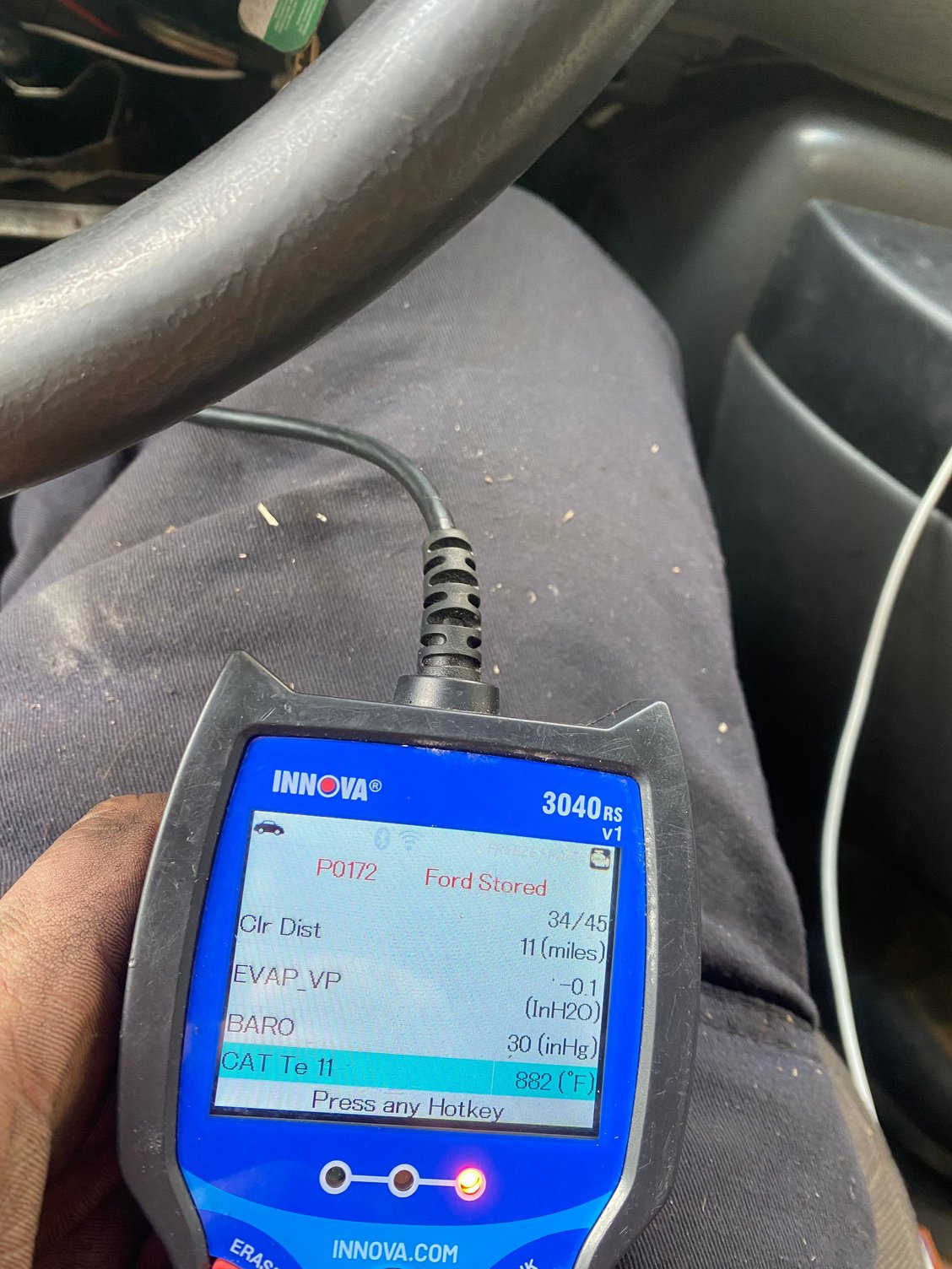

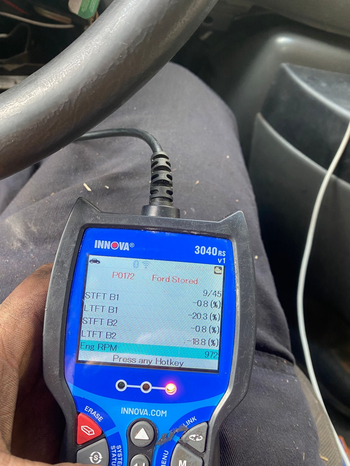

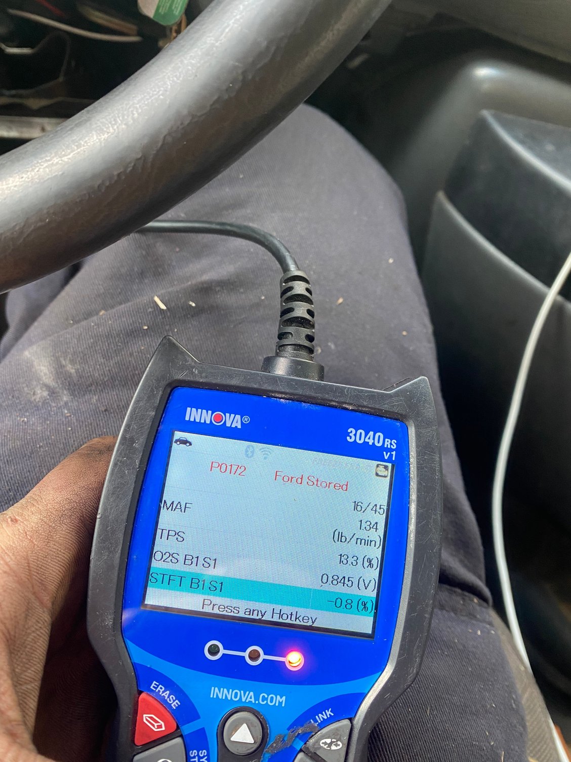

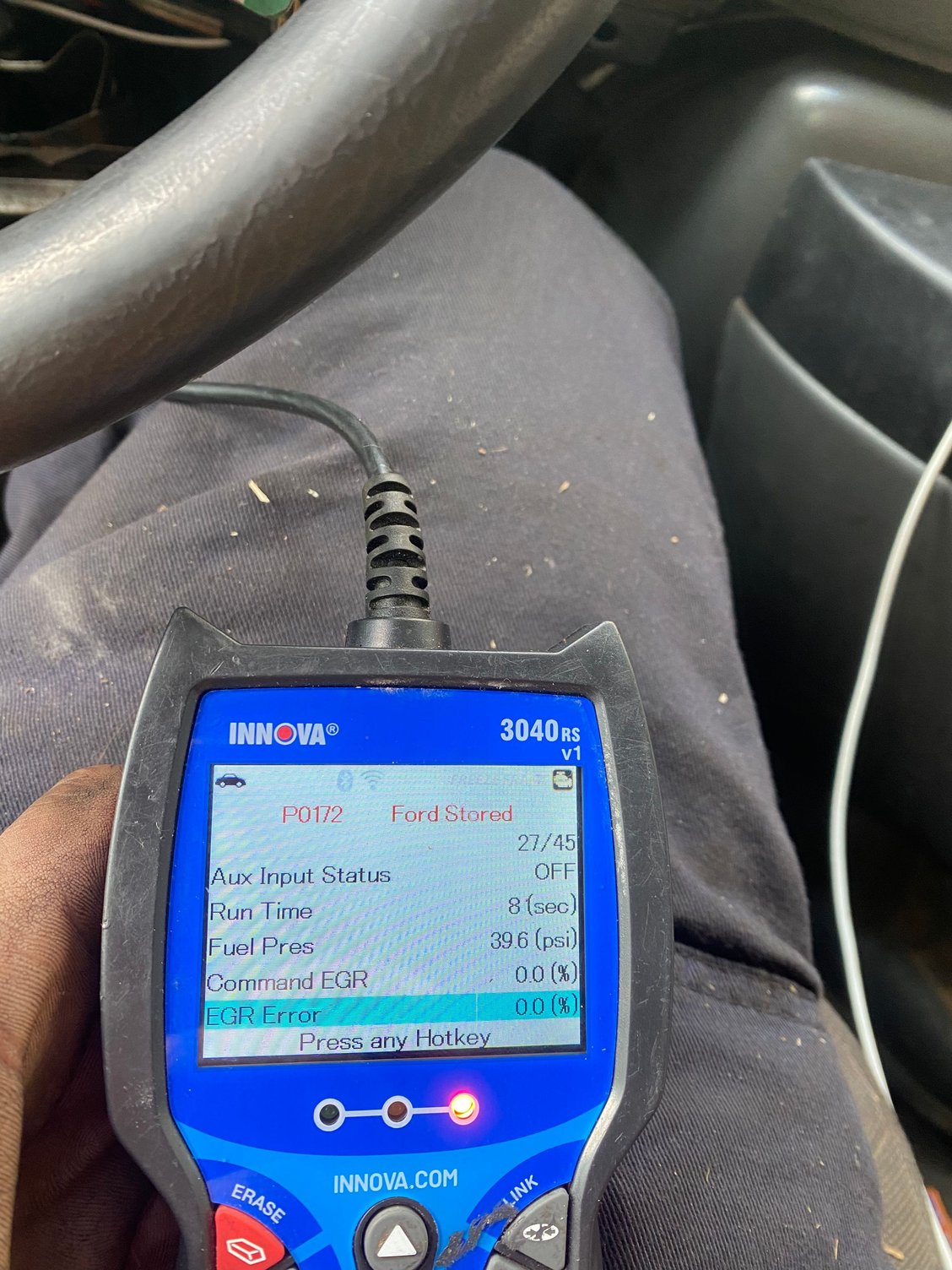

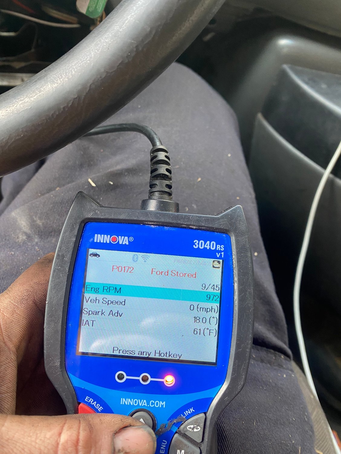

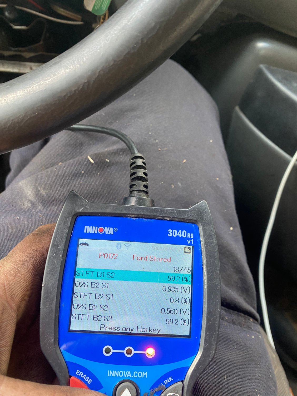

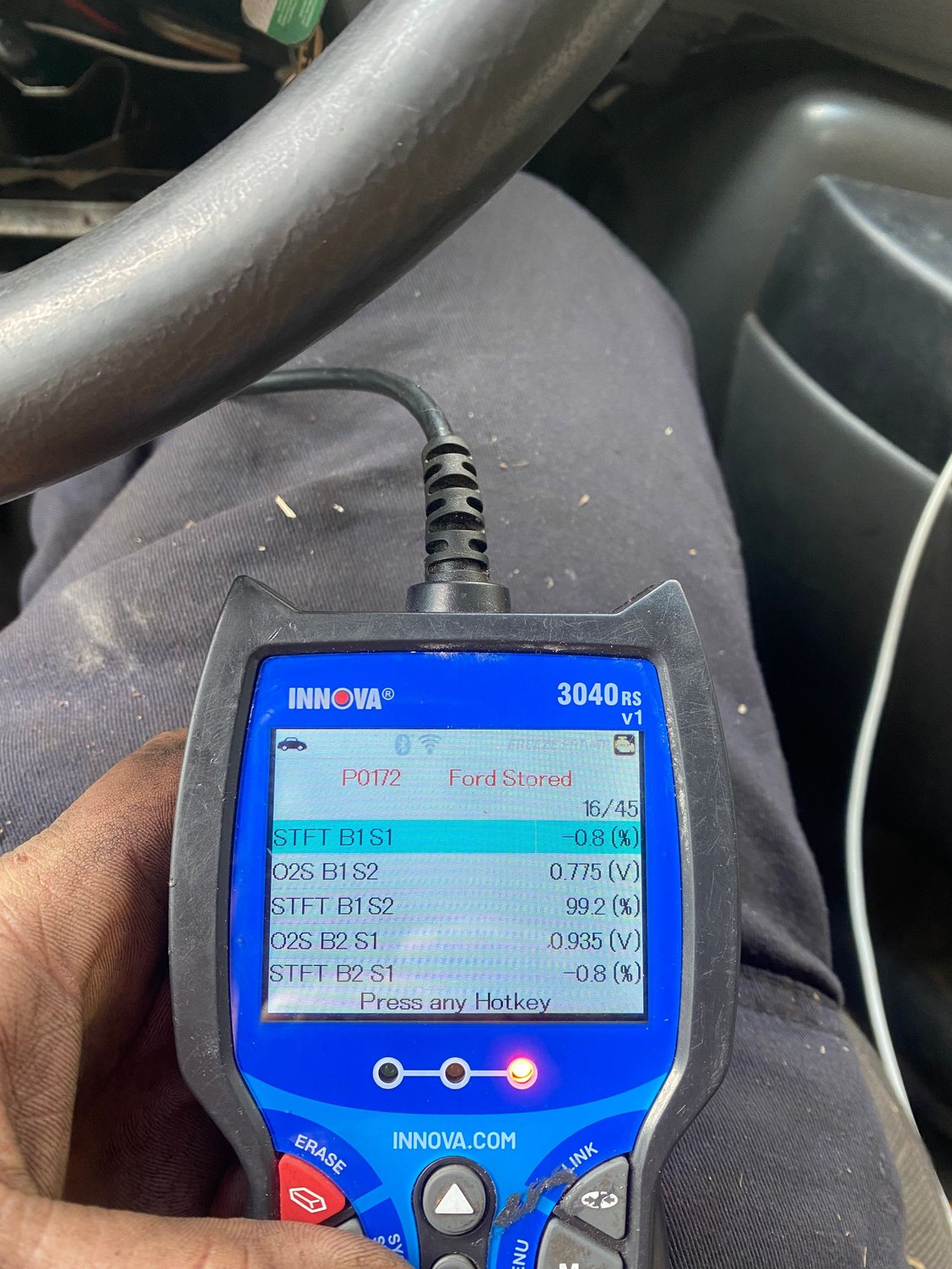

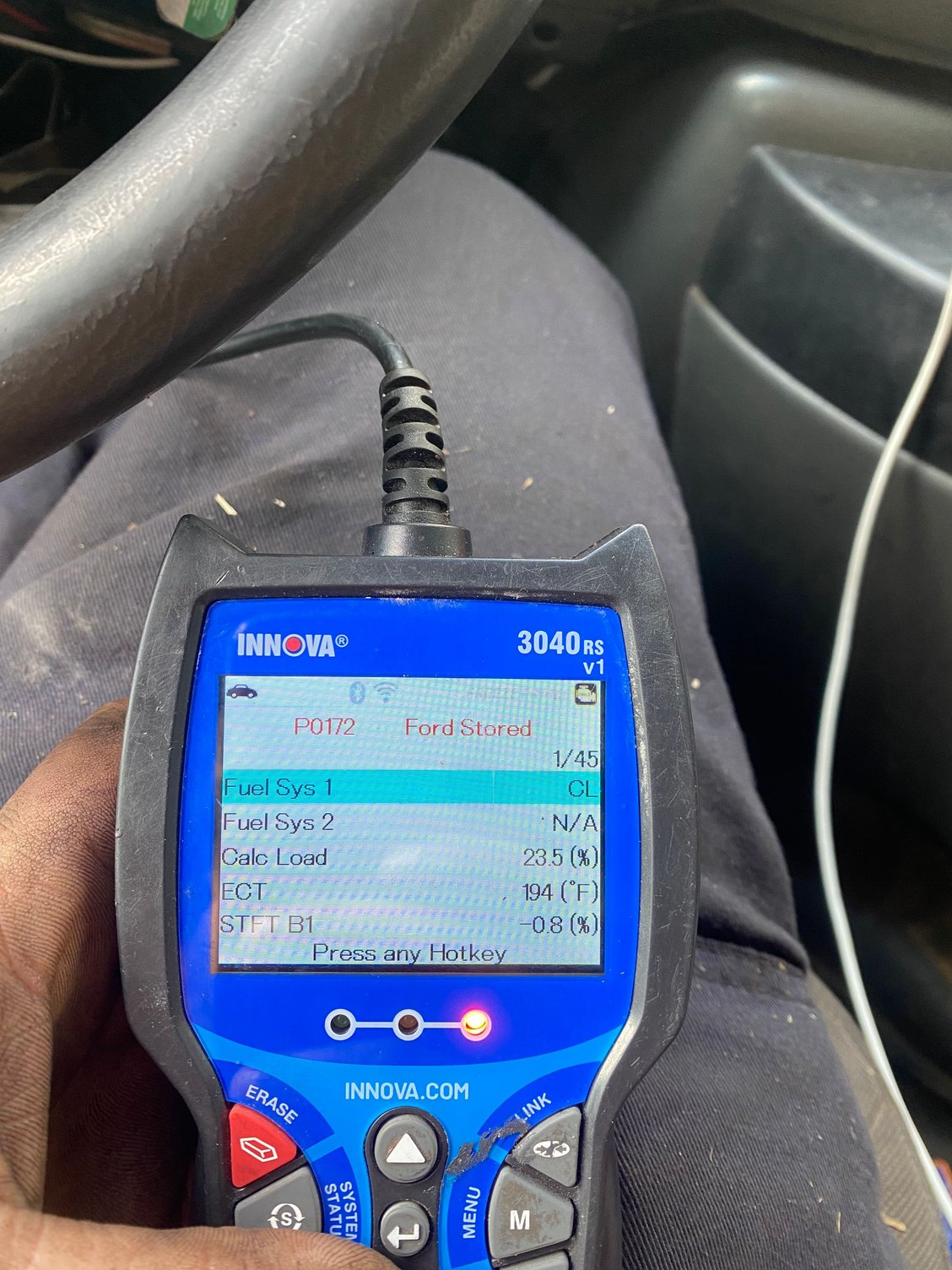

Send help. 2006 e350 497000mi original motor and trans I just want some opinions.
i think the fuel injectors are sticking open/closed intermittently, I’ve cleaned them all and I’ve replaced everything from the intake manifold gaskets up except the injectors. A whole lot of white smoke sit it is cold outside and the smoke dissipates almost immediately. I can smell the raw fuel in the exhaust. I just don’t won’t to fork over any more money. I’m at my wits end. I know what I need to do and would if I had unlimited expendable funds.
