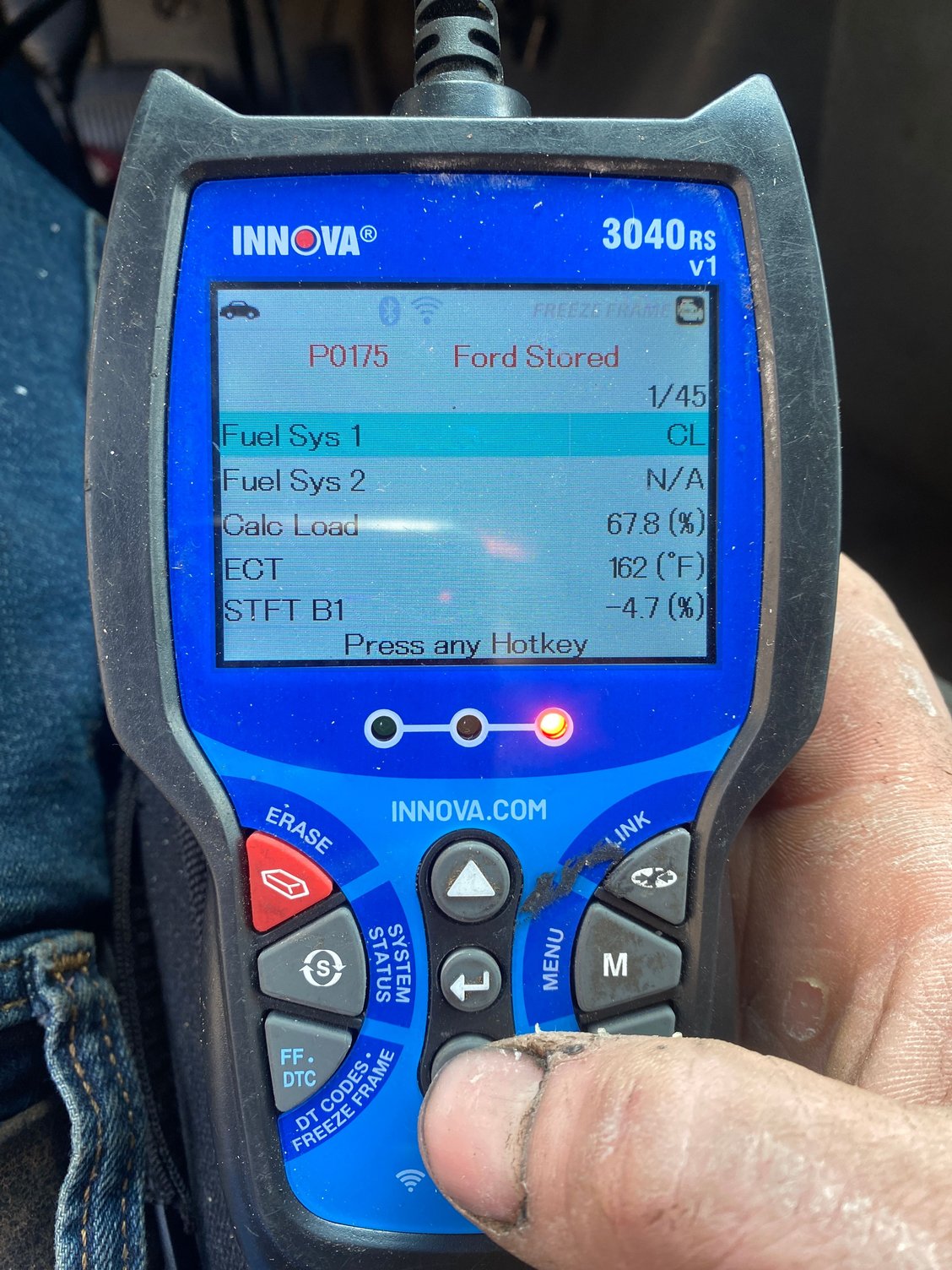

It has a new maf, took the injectors out and cleaned them and replaced the ones that seemed sticky. New fpr reading 40 psi. New vent valve new purge valve, I have the canister disconnect because of the PO over filling issue. It’s been unhooked for a while now. But I used something similar to take it’s place. I just put all new o2. New data
