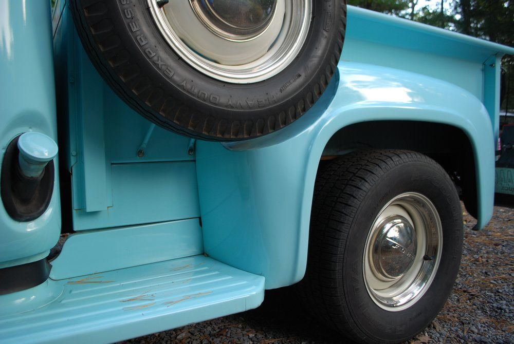

I have wheel vintiques on my truck, I don’t remember the model number or back spacing. I’m running 275 60 R15’s also.

Thanks Dennis. Are your hub caps innies or outties?

They’re innies. I bought 5 hubcaps and 4 trim rings. If you look at the spare, it’s an original 16” wheel with an original trim ring. The tire came with the truck when I bought it in 1978.

i would say yes it fits. I had the same rear combination on my Truck before i took it apart. It certainly depends a bit of how low your Truck is, mine wasn´t very low.

They look good Pintoplumber. I am going to run that look also on my 49. I hope by spring
