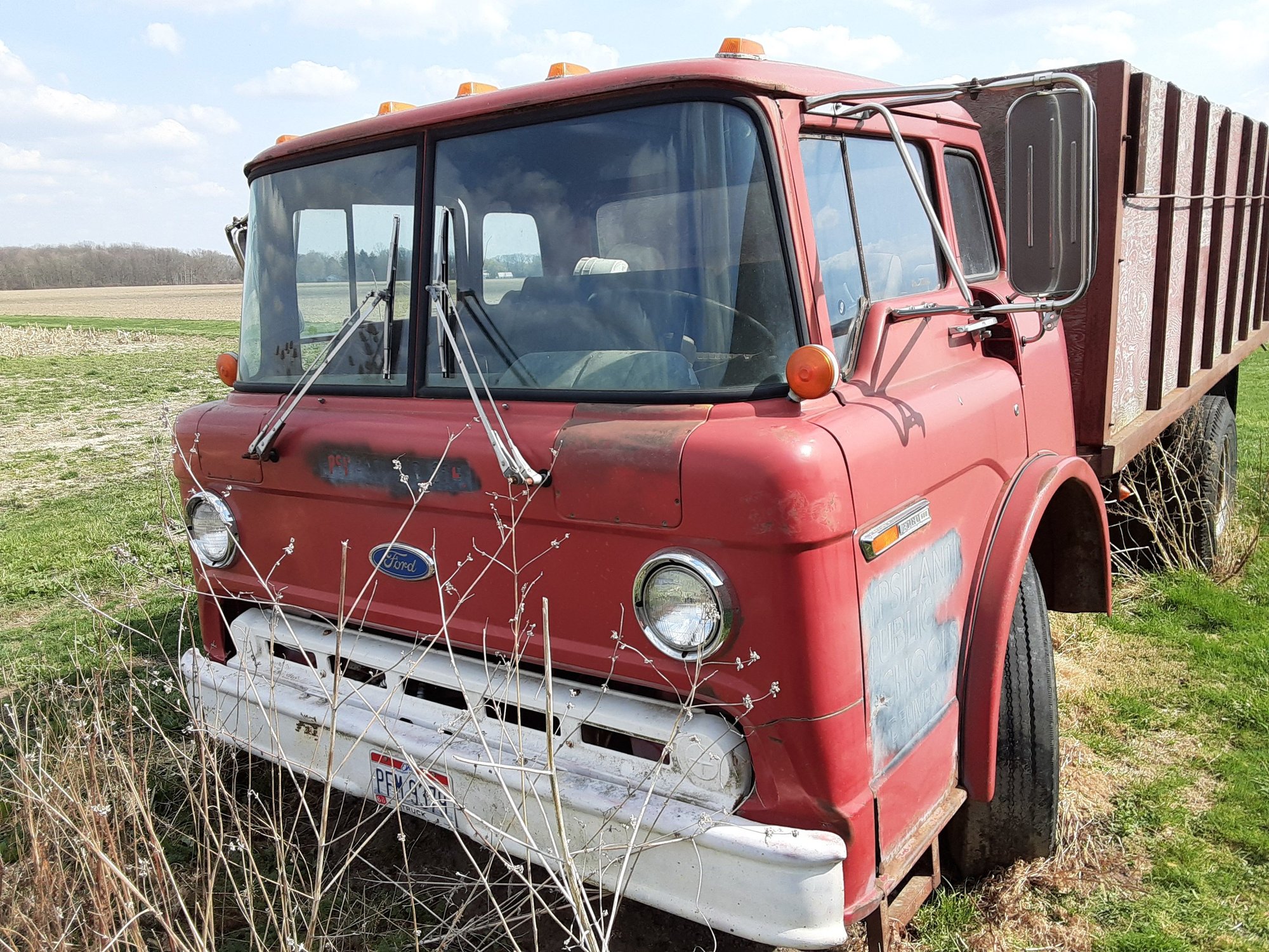

Hi Guy's, first post but I've been Googling questions through fte for awhile.
As long as I can remember (I'm 57), I've thought the C series Ford was the coolest vehicle on the road. I have been saying for years I was going to snag one, if I found one cheap enough.
Well, 3 weeks ago I did it. This one had been sitting behind the neighbors barn for 5 or 6 years. We started farming his place when he retired 3 years ago. The truck ran well, but had brake issues that led to it being moved out of the way. Up until then, it was always stored inside.
It's a 1985 C600. 370 2V engine with a straight 4 transmission.
I spent the first week pulling excess pollution stuff and vacuum lines out of the way and just blowing crud off.
We attached a small fuel tank to it with fresh clean gas, put in a new battery, and it snapped right to life. It purred like a kitten right from the start.
Right now, I have a rear hub off, starting in on the brake issues.
I have a feeling I'll be asking a lot of questions as this project progresses. The plan is to have this running an usable by Spring planting.

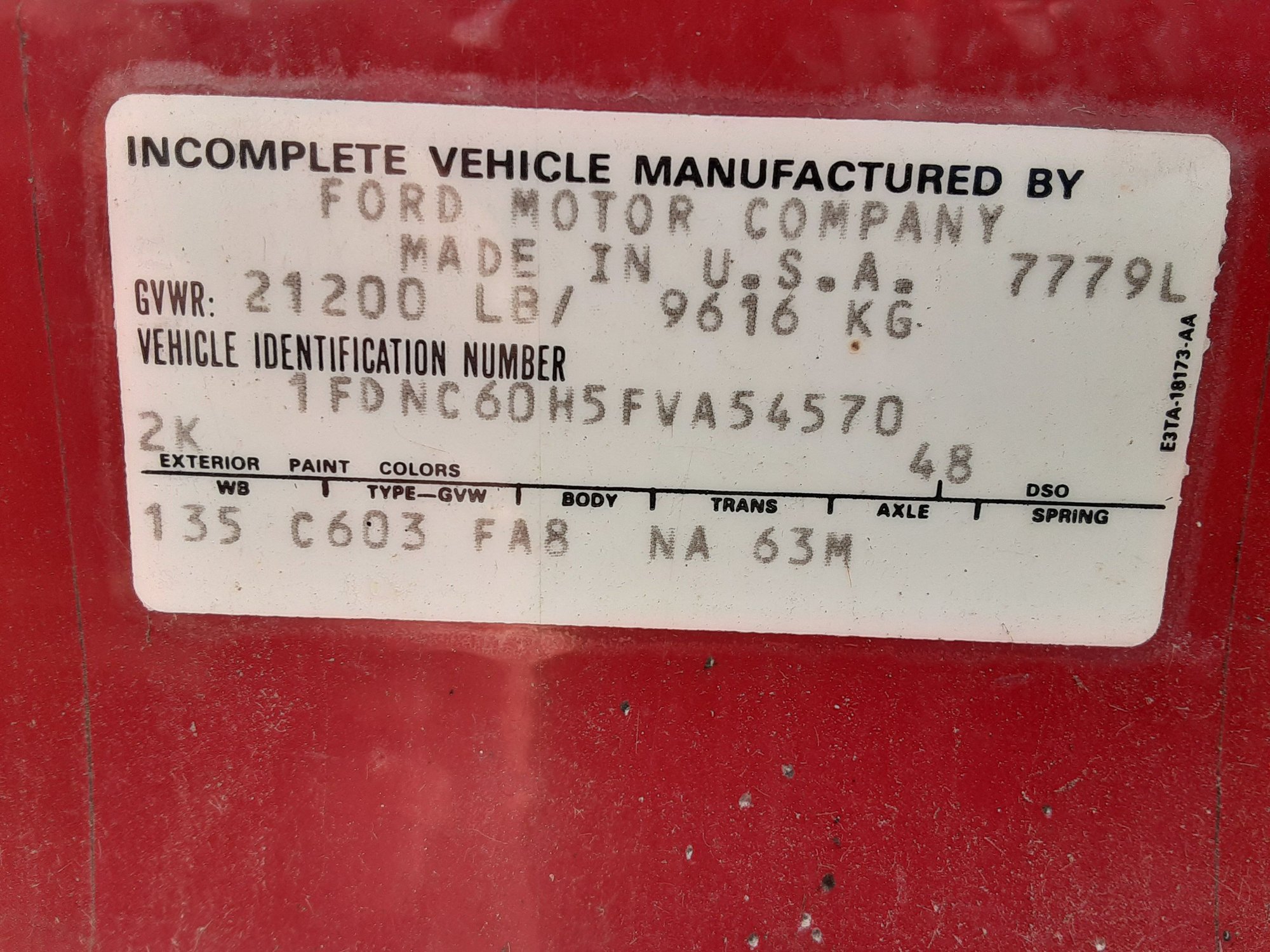

Anybody able to decode the build tag for me??
Thanks for any help
Tim

1FD = Ford Motor Co USA, incomplete vehicle
N = Class 6, hydraulic brakes, 19,501-26,000 lbs GVWR
C60 = C600 gas
H = 370 2V or 4V or 2V low compression. All lumped under that one code.
5 = Check digit, ignore.
F = 1985
V = Kentucky Truck Plant
A54570 = Serial number
2K = Candyapple Red
135 = 135 inch wheelbase
C603 = C600 gas, 21,200 lbs GVWR
FA8
FA = Black all vinyl (HD) full width seat
8 = standard cab
NA = New Process model 435 four speed transmission
63M
63 = Rockwell (Timken) model F-106 single speed rear axle, 15,000 lbs capacity, 6.83 ratio
M = Ford 7,000 lb capacity front axle with power steering
48 = Detroit District Code
No special order number
Let me know if something doesn't line up.

Thank you very much!!! You matched up the stuff I knew, so I have to belive the rear end info and stuff.
Thanks again!! Very helpful!!
