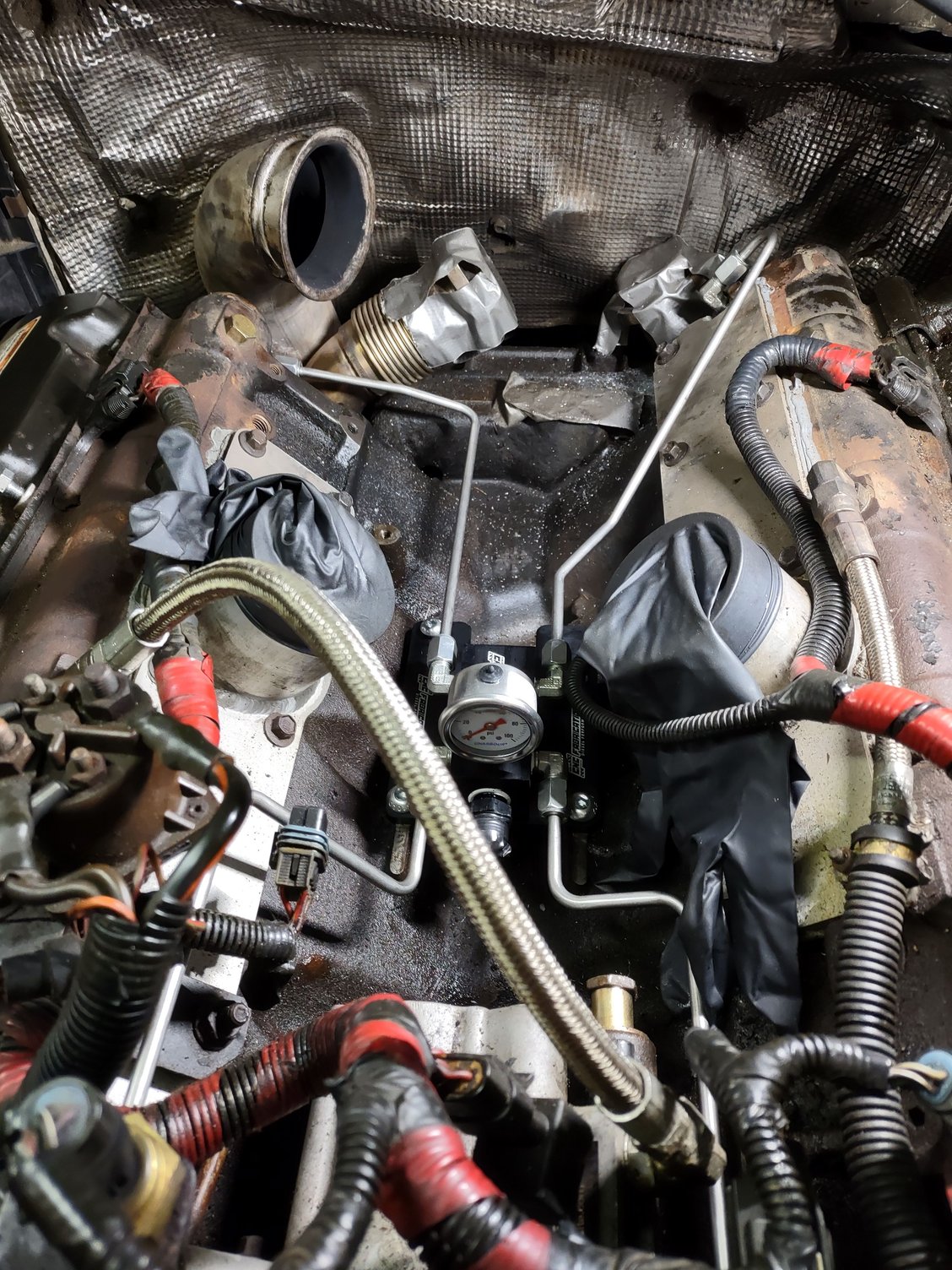

Pretty sure all the fittings are tight enough, and all the lines are in place, next up is mounting the fass pump. The biggest pain in the rear was making clearance for the 94.5 drivers rear fuel fitting to spin.

Wow looks nice!
