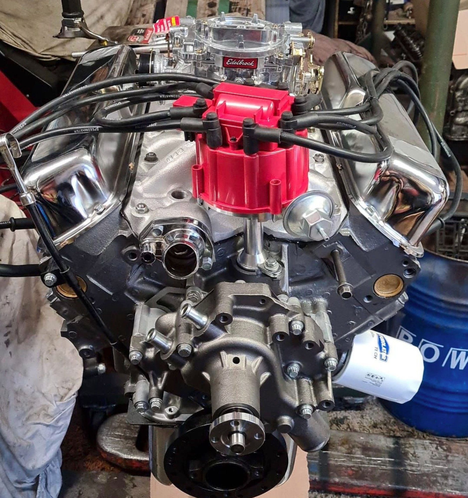

Which 351W do I have?
.Took me a while but here it is: Remanufactured, all new but the roller cam I think. Edelbrock carb and 020 Silvolite cast pistons. Please tell me its not the oil crisis low power version of the engine. How many HP and torques you reckon its making with his carb?

That F4TE block is the late model roller, any idea on cam specs?

Is this late model the oil crisis model with the low HP or the normal 300HP one?

Neither. The low output motors was a '70's thing but that is a mid '90s block so it's not one of those, The 300hp motors have GT40 heads but those look to be the regular truck heads so it's not that either. My guess is it was a truck motor that was rebuilt and dressed to go into an old car, and depending on the cam used it will make somewhere between 220-270hp.

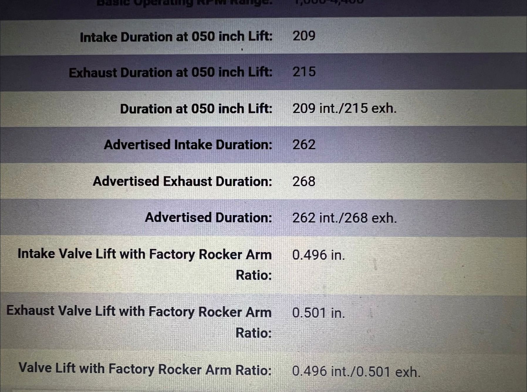

Finally got the CAM info from the vendor. Any idea now how much HP the engine will make if you take all parts into consideration?

With that cam about 270hp... the heads are the bottlneck.
Your run of the mill RV cam. I ran a cam with the same specs in a Ford 400 and it did well. You'll get a little bump with it over a stock Ford flat tappet factory cam.
