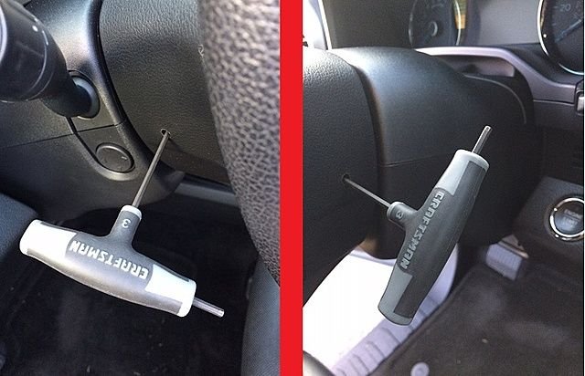

I used a T-Handle 3mm Allen wrench and it worked perfect. Once you slide it into the wheel and it stops, press in on the top of the steering wheel center and push the wrench firmly. You should definitely feel it move and stop. Pressing on the steering wheel center helps to take a little pressure off the latch mechanism. Once you feel the retainer move pull out lightly on the center and it should come forward about 1/4". Swap the wrench to the other side and repeat. It should pop out easily.
I took some pics when I disassembled my F-150 to add adaptive cruise.
The retainers you are pushing with the wrench are labeled below. This is what it looks like inside:
Once you have it released carefully remove the airbag connections by popping up the retainer locks. The airbag connectors are yellow and the retaining locks are orange and pop up for release. Note this is a 2015 F-150 - it may look a bit different inside yours.
