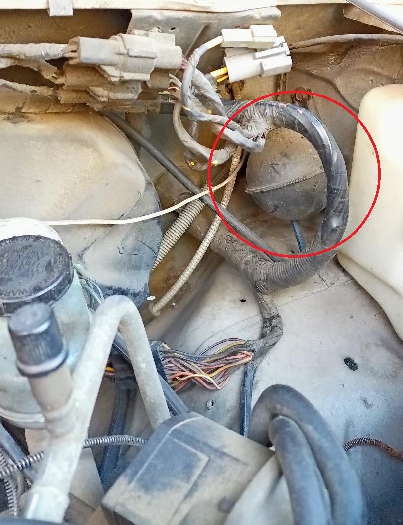

Here is the vacuum reservoir on my 88 E150 with a 5.0 and AOD transmission. It serves to keep vacuum to the ac vent system. At least on my 88..
should really do a good cleaning under the hood but everything is working right now and I hate to disturb anything!
