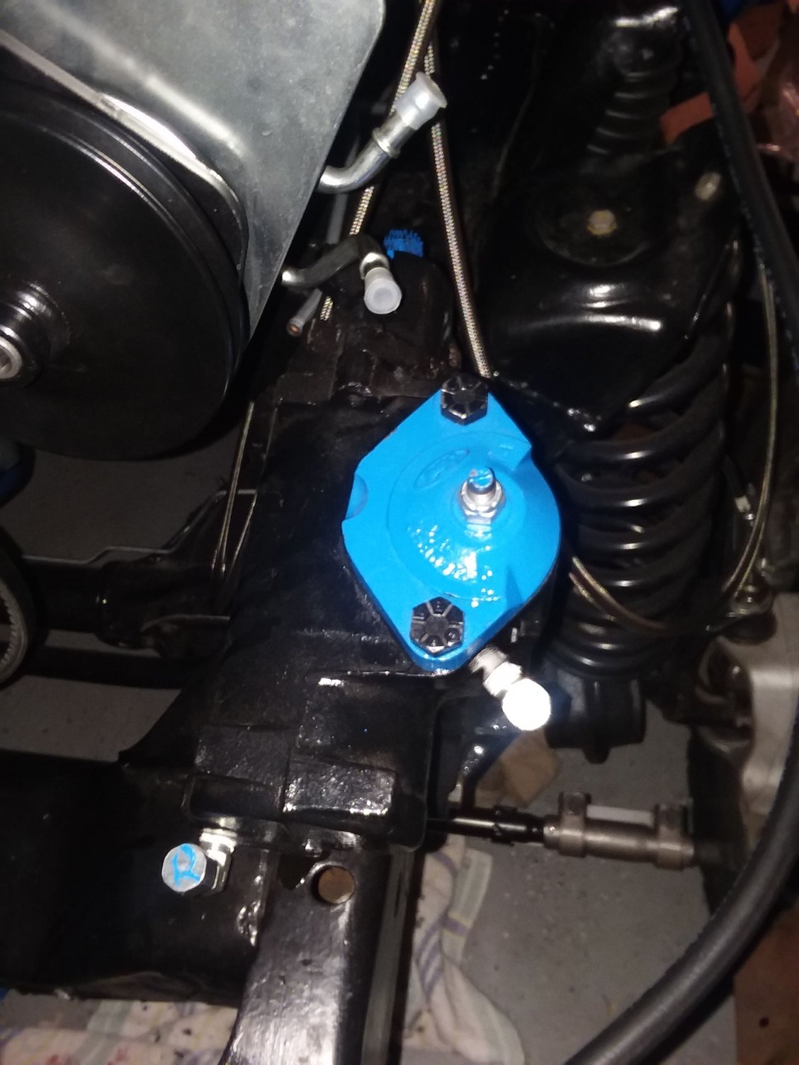

I have a blue top steering box with additional ports for hydro boost as well as dual return power steering pump and hydratech hydroboost.. Can anyone provide the correct hose routing with the additional ports on a steering box?

Those ports are for hydraulic steering assist cylinder on the tie rod. Has nothing to do with Hydroboost.

Pretty sure X2 what Bruce said and a quick phone call to BT will confirm that. (701) 745-3599
https://bluetopsteeringgears-com.3dc...tion=contactus
When you send in your steering box to them to get it rebuild it. It is a 90.00 charge to add "Pre-tap ports and plugs" and as I understand it that is how you put/add hydraulic assist steering on your truck. As in adding a hydraulic cylinder attached to the drag link and anchored to the axle and power it thru the lines coming off the p/s box.
