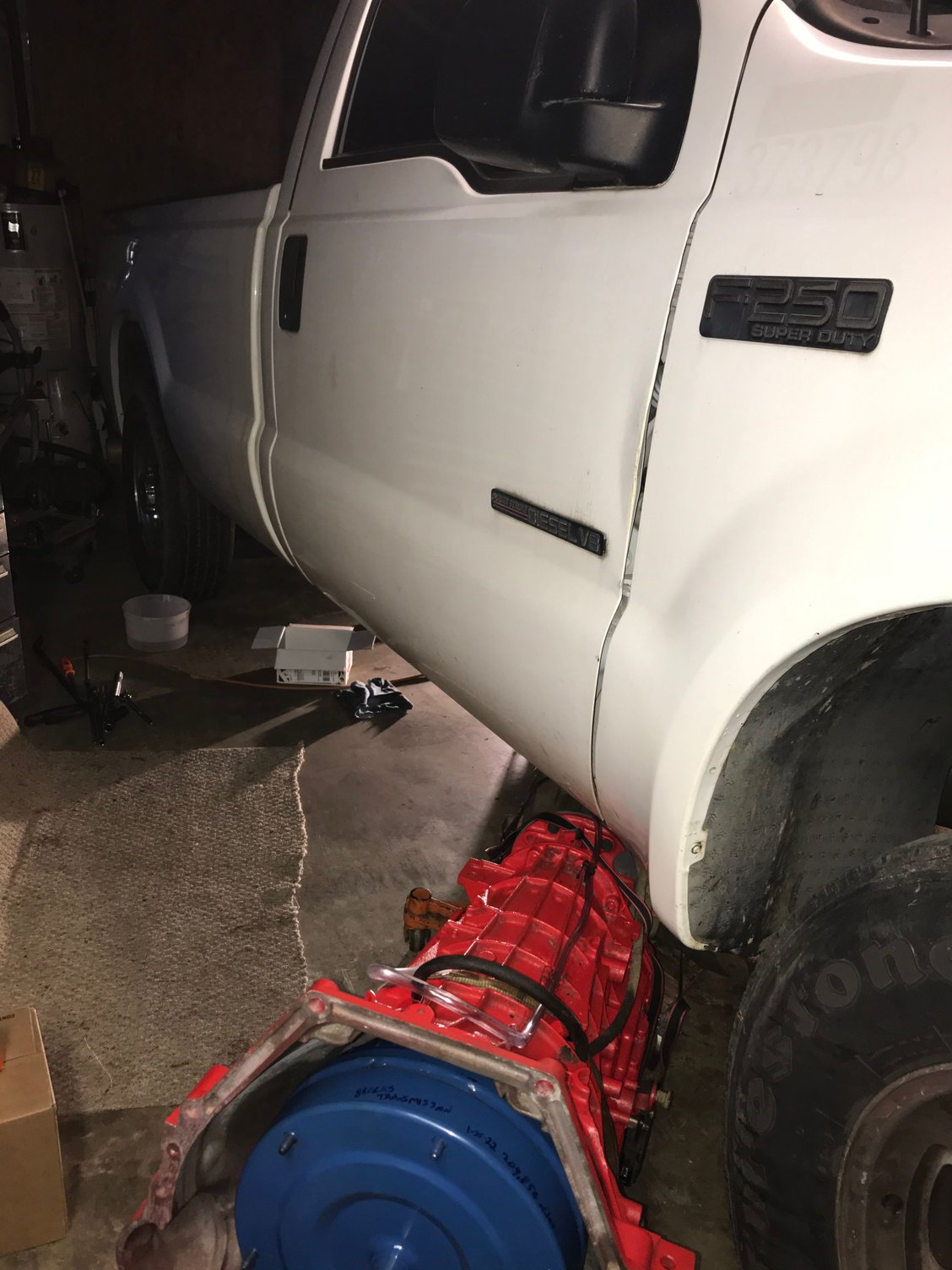

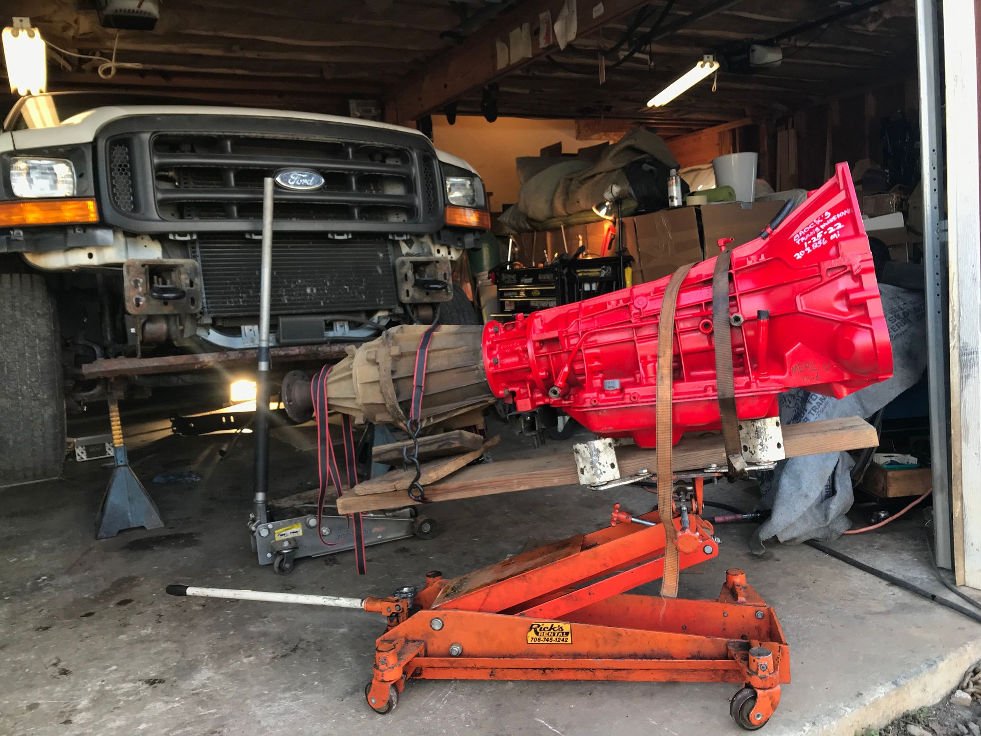

Also added pics of a current project with fresh 4R100 in a 4wd conversion I’m doing.
