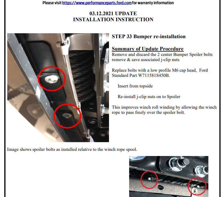

So, I haven't had time to talk to the dealer yet, however I think I know what happened.. I noticed that the rope would hit something if it didn't spool just right, and after looking at some other forums I found some info that it wasn't installed correctly. If you see the "Installation Update" for the manual, it instructs to use new bolts for the Spoiler, because the old ones would hit the rope. I checked, mine still has the old bolts installed, not the newer flat head ones. I think the rope got bound up, and it bent that front bracket (Which is for sure tweaked, or maybe more..
2020_CMY_SUPER_DUTY_TREMOR_WARN_WINCH.PDF (ford.com)
I will be asking for a new bracket/brackets, and new rope. I don't see how they can argue with that.
If you have a factory Winch, make sure you check that it has the correct bolts installed!!!!!!!
