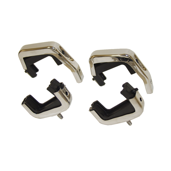

what does the rail on the core support look like, and how exactly does that thing hold the radiator. Does the circle nub sit in the core support, then the U wraps the bottom and just sits on it and holds it from movement/vibrations?
If so, you could probably create a new way to isolate it easily. get GM radiator isolators from the square body years that look like a canoe shape (cut down U, but longer) that span that distance, and make a pedastal of some kind to place them on.if you can put hardware on the side of the radiator you can make something like my cars radiator
all that requires would be simple bracketing if you can feasible attach somewhere secure. Then for a mount you can find one like that car, sure, but you only need to make a Small block of rubber essentially instead of a complex mold or shape.

you may also be able to adapt ranger/explorer mounts I did a google search and similar year those models have a shortter possibly not as wide but maybe.

AuroraGril - Thats not a bad idea, however the GM mounts appear to cradle the bottom of the radiator. The Ford radiators have 4" long "ears" off the bottom that slide down into the isolators for both NVH isolation and weight bearing/support.

I was implying to bridge the valley between those ears and slap a GM style on if you cant find a working substitute. Its just aluminum, if someone was really worried Id cut up some hockey pucks to fill that, find something epoxy or sealant to mend it that would handle the ambient conditions, and then slap a gm style on since it would be a consistent bottom.
I dont know much about older ford models, bbut the picture I posted of those metal/rubber ones were for older broncos, maybe suggesting the mount style is older than some others. If anything it may be close you could modify.

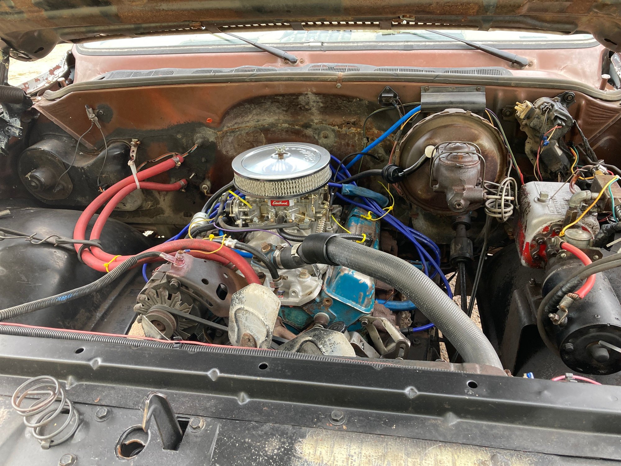

heres my buick electras engine. not much to look at yet.
heres my squares engine, not perfect(you can spot many issues if you simply look at it im fully aware lol, its a plow truck)
However, after having done the intake on this truck with the engine in... all i can say is **** where the distributor on a SBC is. Buick, ford, YES. Olds, Pontiac, Chevy, nooo.
