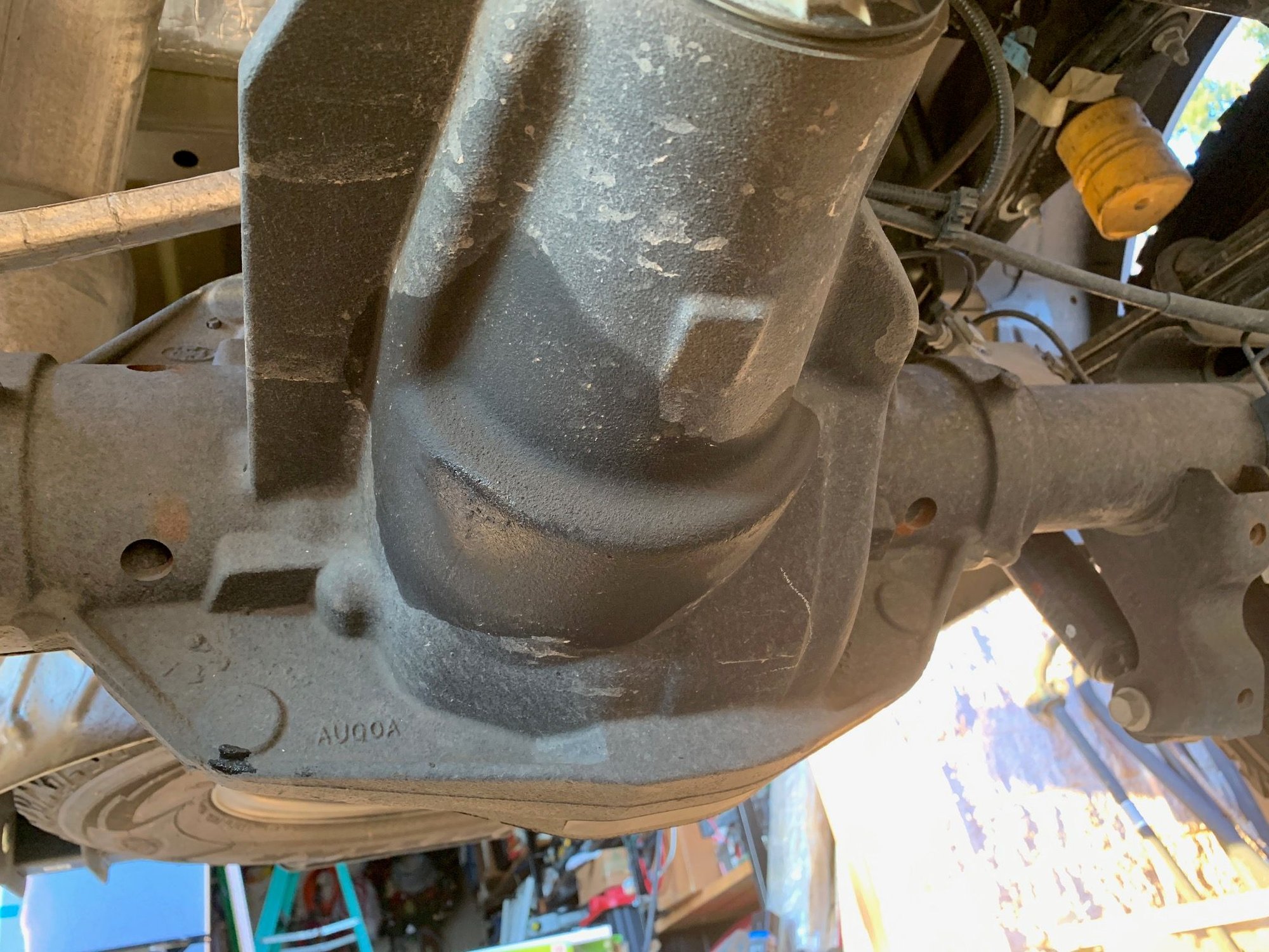

Sometimes castings get air bubbles when they're cast. My rear axle didn't have a crack in the casting, but it had bubbles from casting that must have had small holes for oil to seep out of. Ford had to replace entire axle. That could be what is happening here. But it looks to me like the leak is dripping down from the top and probably just a gasket issue.
