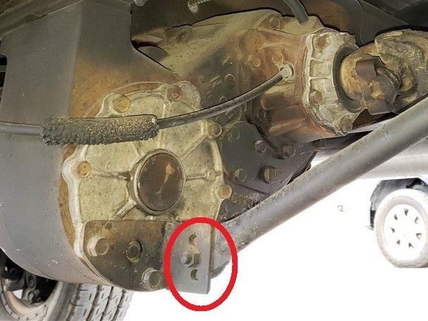

Can anyone with a Highboy that has the transfer case support rod confirm the size and type of bolt the factory used in this location circled in pic? May be just a standard bolt and nut but I thought there is a chance it could be a shoulder-type bolt.
Thanks

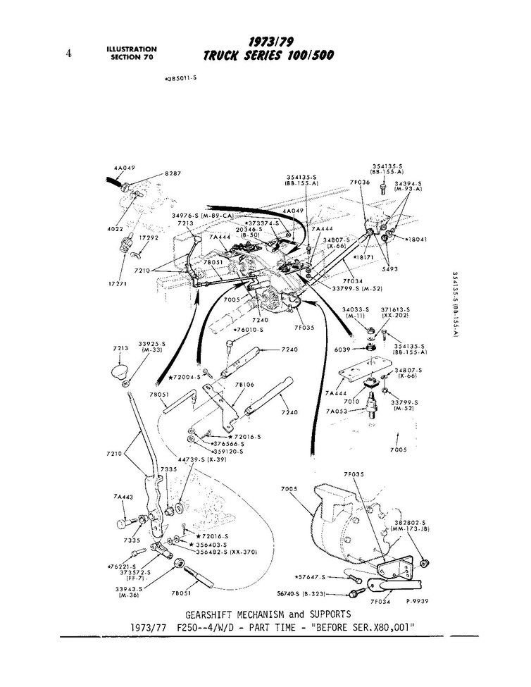

Just a bolt. # 57640-S (B-323)

3/8 course thread washer head bolt...but you could surely use a thick flat washer with a regular bolt.
