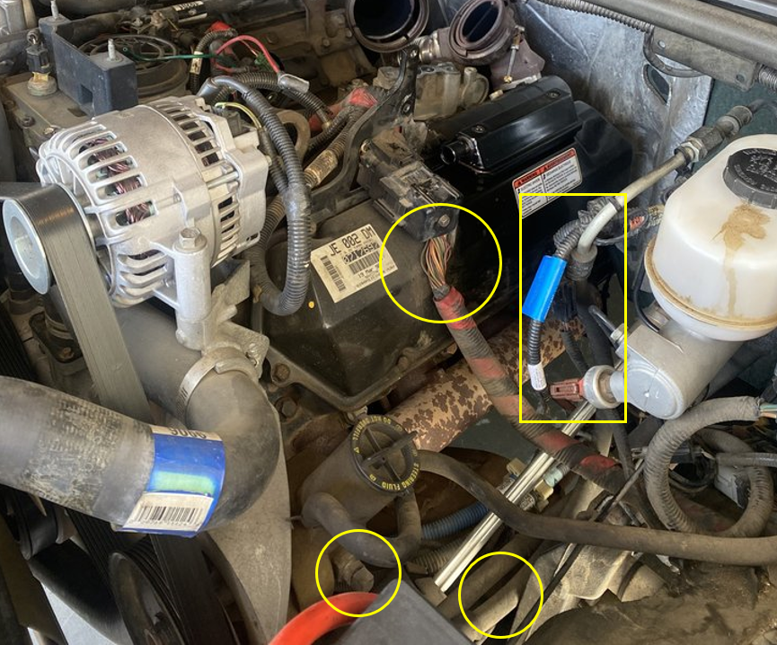

here is where I called it quits for todays work, intercooler pipes out, spider out, turbo out.

Thanks for posting this picture - definitely like to follow along.
A couple of items you could address while waiting for UPS are the rub points for the power steering hose on the shock tower, and on the pump where it can contact the CAC pipe. Also the engine harness on the driver's side valve cover - tape that up to avoid chaffing/shorts that can happen there. Finally, there is an updated brake pressure sensor harness for that recall harness in the yellow rectangle.

BWST,
Thanks for the pic highlights, I will be working on that tomorrow, I appreciate the insight.
kwikkordead,
Thats a good point, now I'm looking for braided steel hoses for the power steering system.
