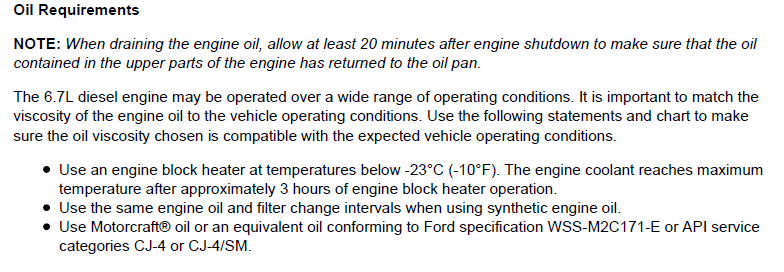

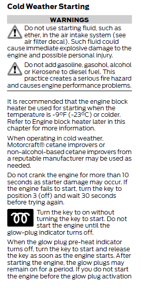

As stated earlier it's good to -10F and here is what Ford recommends.
