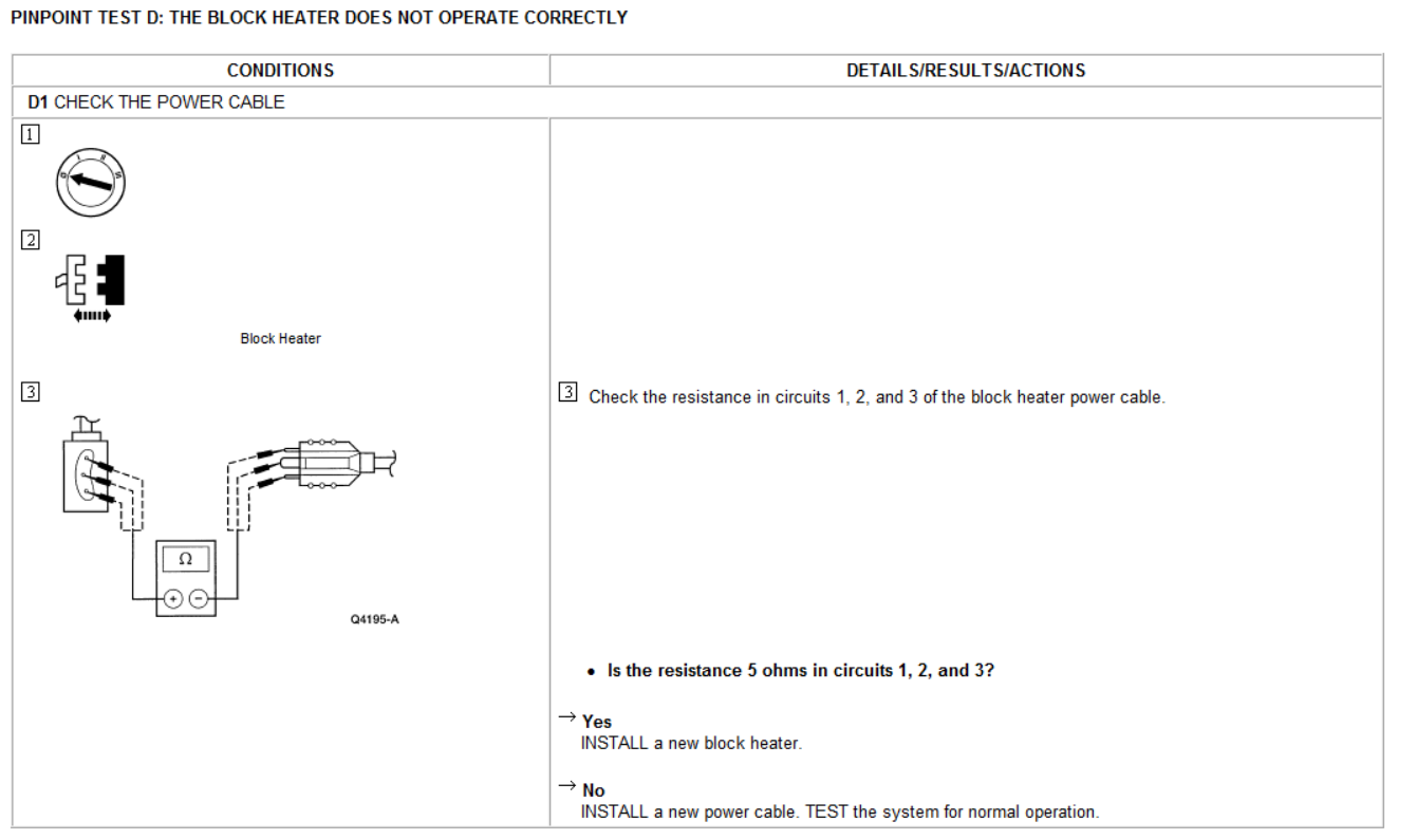

Before you count on your block heater to work make sure it does.
You can measure resistance between the main prongs to get an idea. I think somewhere between 3-8 ohms is normal.
0 ohms or infinite ohms is an open or short, and something is wrong.

Kbeefy brought up a good point about testing the block heater element. I have pasted the test from the Ford Service Manual below from section 303-03 Engine Cooling Diagnosis and Testing. This can be accomplished if the visual and/or auditory tests I and a couple of others mentioned above are not conclusive.
