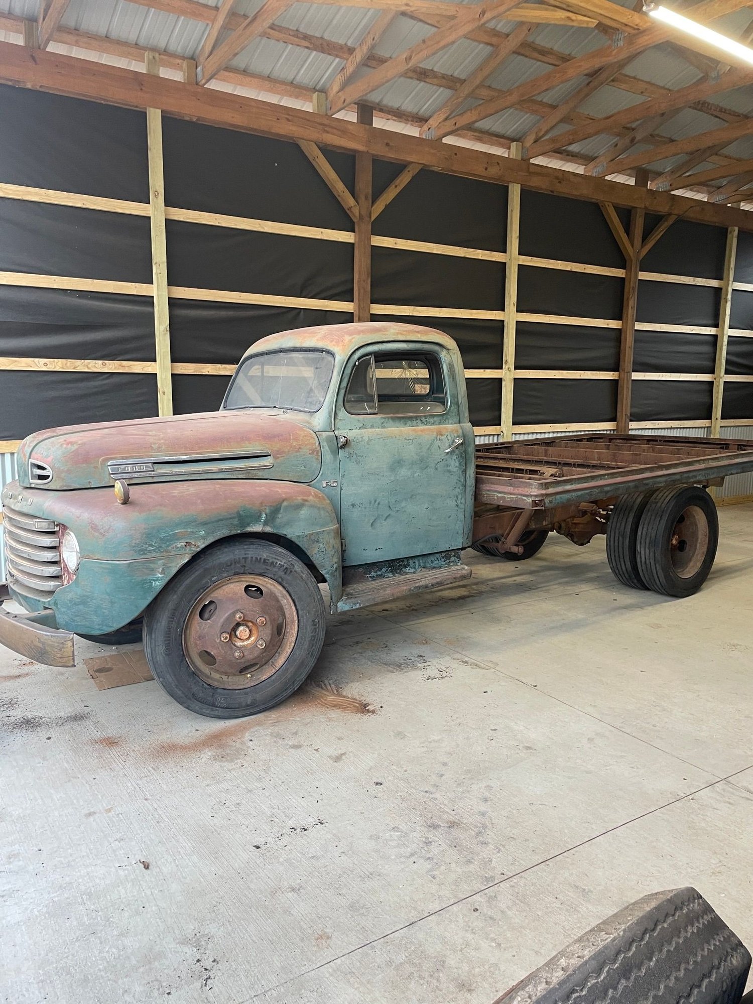

Hello all, old Ford guy with a fair amount of 1964.5. - 1971 Mustang, Torino, Bronco (‘73) and one ‘66 F100 resto experience. Just purchased this 1948 Ford F5 from a friend. Great old truck, super solid, dump bed, luckily stored in a warehouse since 1970.
My plan is to get her road worthy and leave the patina, restore the wood bed and make her safe to drive around town.
Already 12v and engine swapped to a ‘65 289 that runs great. I can drive it around the yard but the brakes need renewal. So, first question is parts sources for wear items like brakes, glass and some side view mirrors.
Secondly, I’ve found 8 wheels/tires for sale from a 1992 Holiday Rambler Alumalite xl, 19.5 x 6 with 8R19.5 tires at a reasonable price of $400 for all, about 4 hours away. Good option? I’ve lurked and read enough on widowmakers to make me want a relatively modern wheel that still looks original.
Lastly, I’d like to safely return the bed hydraulics to service. System looks to be complete.

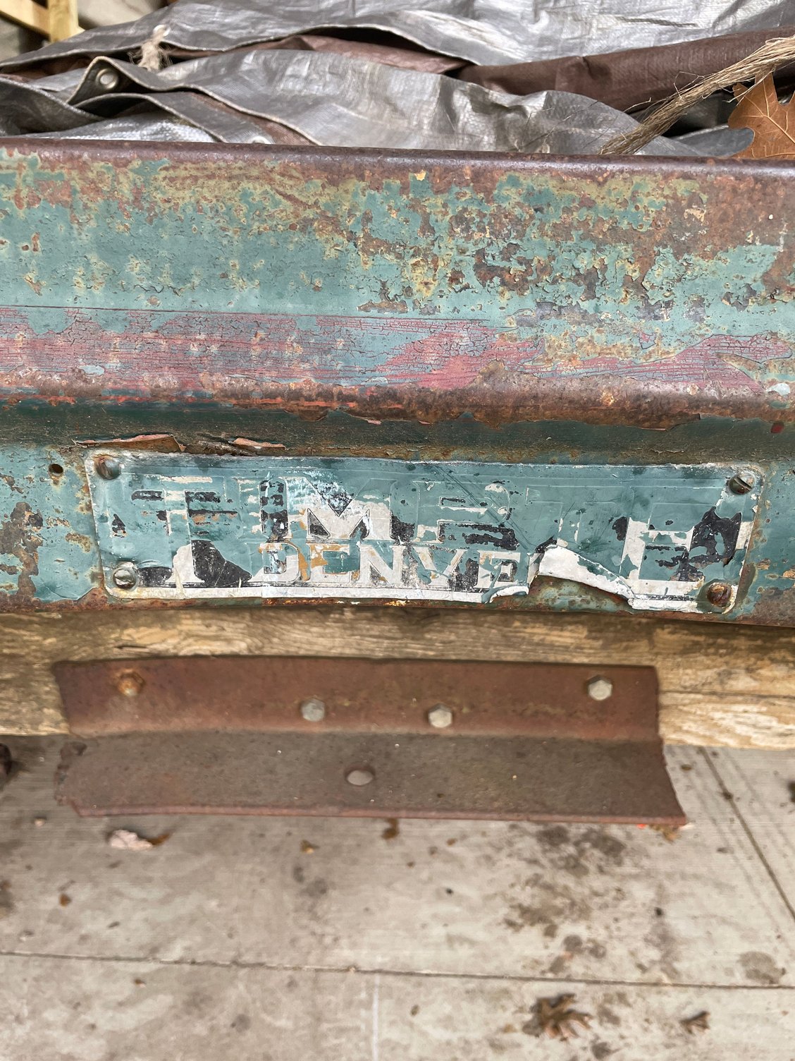

FoMoCoJo, welcome to FTE the best Ford truck Forum on the World Wide Web!
That's a nice truck you have. The bed looks long for an F5. How long is it? I wonder what the trucks original use was.

The bed measures about 13' x 8', actually about 94". Here's the placard pic...."TIMPTE DENVER"....

Got the new wheels and tires mounted up, thanks to Stu and Mark! Stripped off the old bed wood and have some red oak being cut.
The truck left service in 1972 but was worked on and shop driven over the years. When I putter around the yard, something locks up every 20’ or so. I can unlock it by going a few feet in reverse. At first I thought brakes, now I’m thinking rear end. Any tips?
