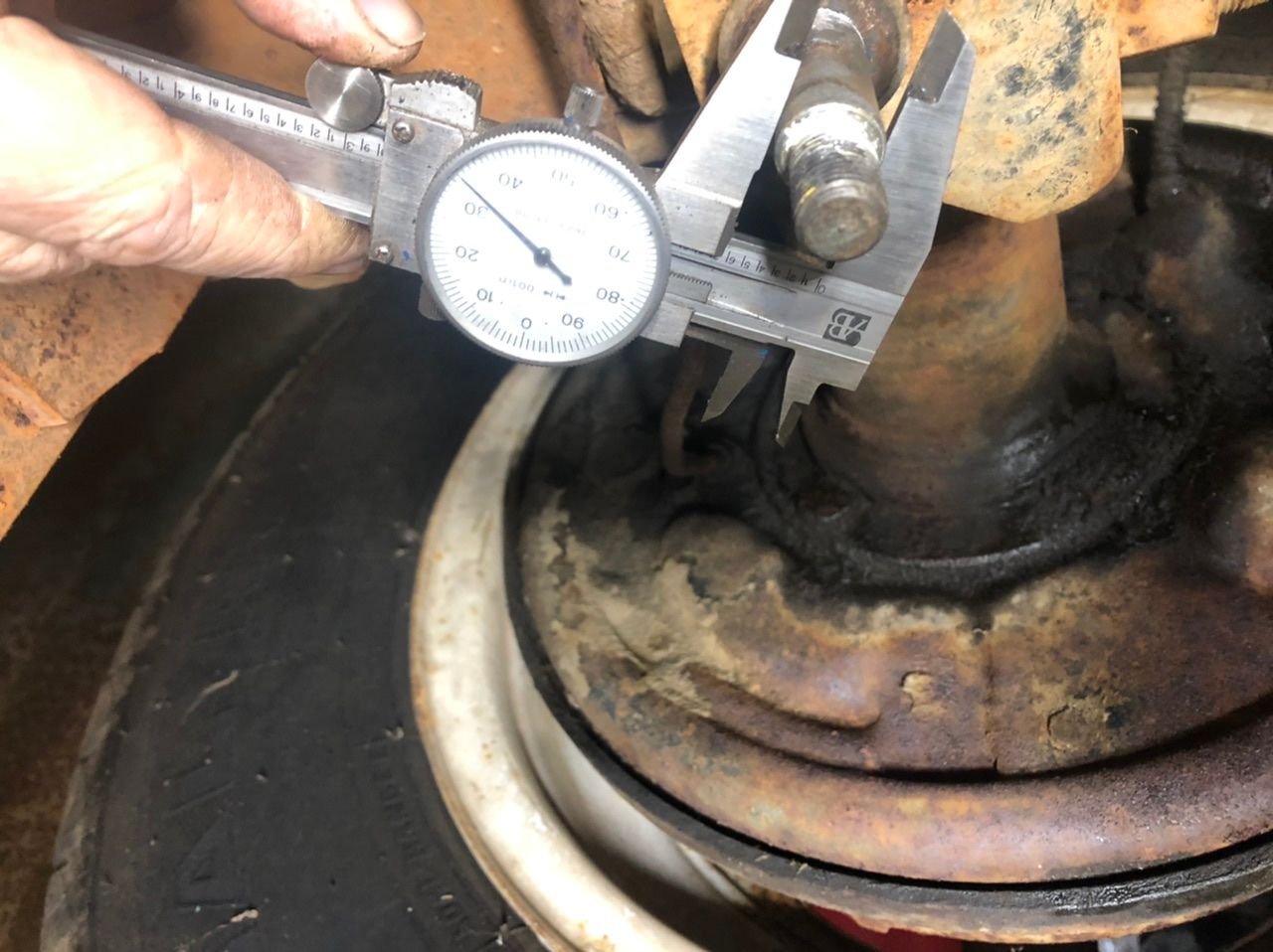

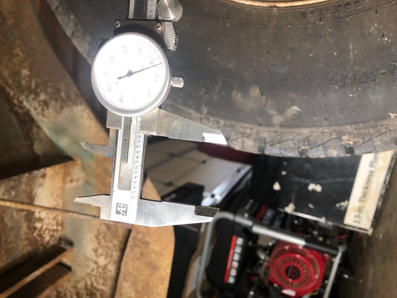

Good Evening All, I ran into a problem when I was installing new shocks on my 1958 F100. A bit of history: the truck had 4 extra spring leaves on the rear. Also, the shop that rebuilt my third member mentioned it had heavy duty parts inside. The lower shock mounts have a 5/8" studs and the new shocks have 1/2" mounting holes. Has anyone found rear shocks with the 5/8" mounting hole? I'm afraid if I switch to 1/2" studs there will be too much slop in the lower mounts. TIA

Ok, just grabbed the lower mount with vise grips, no help unless the bushing was sweated on.

My ‘60 F250 has 5/8” shaft mount on the axle tube and hole for rod style on the frame mount. It is also a longer shock due to the extra ride height of 4wd. Is that the kind you need?

Yes, that is the size of the post. I found a Monroe Gas Magnum shock, #34954, that has a 5/8" ID bushing. Thanks for the photos.

Does the bushing on the shock have a sleeve? If so remove the metal sleeve and run it without

Mannysouza, I grabbed the post with vice gripes to check for a sleeve, nope, its a 5/8" post. Thanks for the input.

No sir, I am looking for lower shock mounts with a 1/2 inch stud. My other choices are have someone turn the studs to 1/2" or buy another pair of shocks. Thanks replying to my post.

I am sorry I wasn’t clear. On the shocks typically have a sleeve to work with multiple shock mounts

PROBLEM SOLVED ! ! ! When I bought the shocks a couple of years ago the counterman sold me the WRONG shocks! ! ! Its too late to return them so I have the correct ones coming in tomorrow. Thanks friends.
